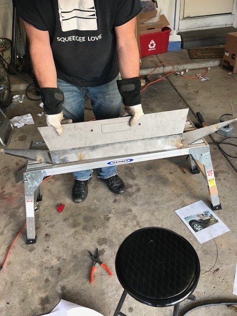

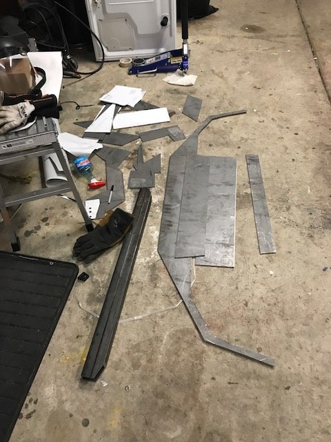

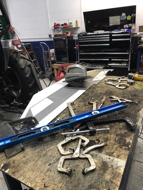

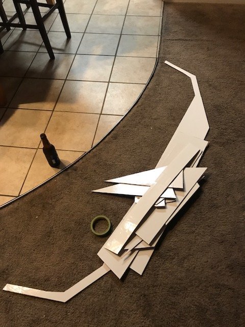

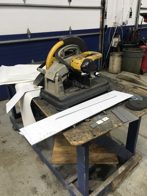

    Having access to a vinyl plotter I found I could print the shapes out and stick them to the 3/16 steel I was using and cut it out with a heavy duty rotary saw I borrowed from a friend.

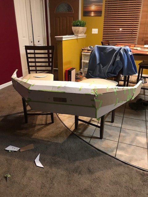

    Before I did tried it on the metal, I bought some cardboard to see how all the pieces would come together. I've always been taught to measure twice, cut once.
    So with a fresh case of cold ones, it was time to get cracking!

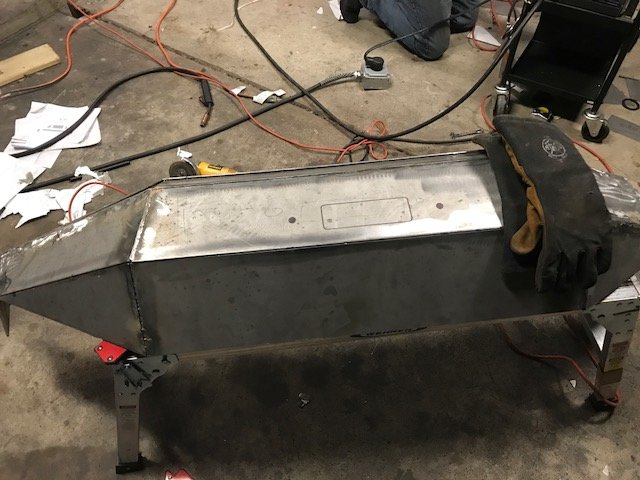

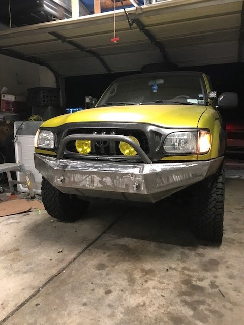

    Here's the bumper mostly put together. After I put it together on cardboard, I was itching to start tacking some metal together!IMG_1840.jpg
    This is the saw I used to cut out the shapes. Figured I'd throw some pics of this process too.
    Don't mind the goofy face! It was getting very late and I was cutting metal for hours!

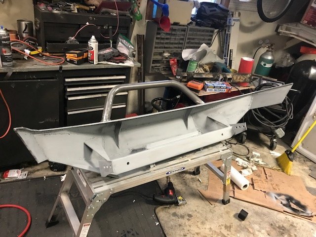

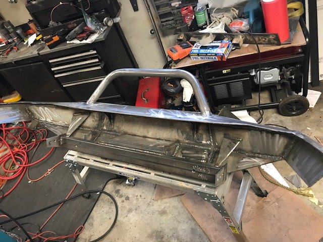

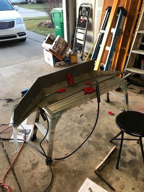

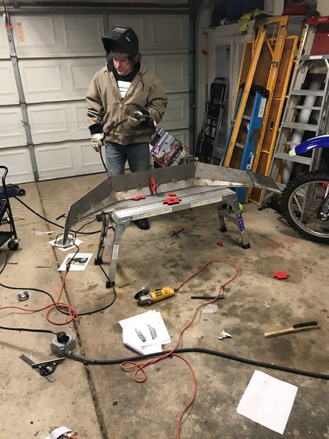

    Me and my dad having the front part all tacked together.

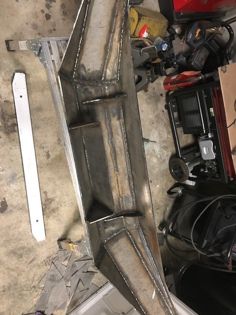

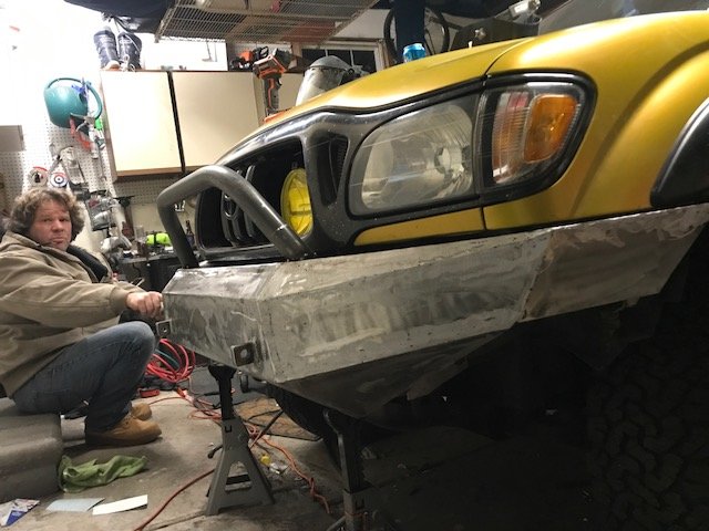

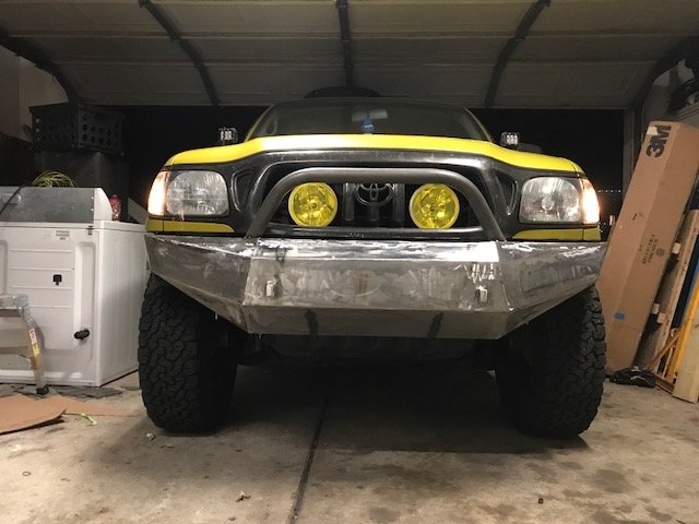

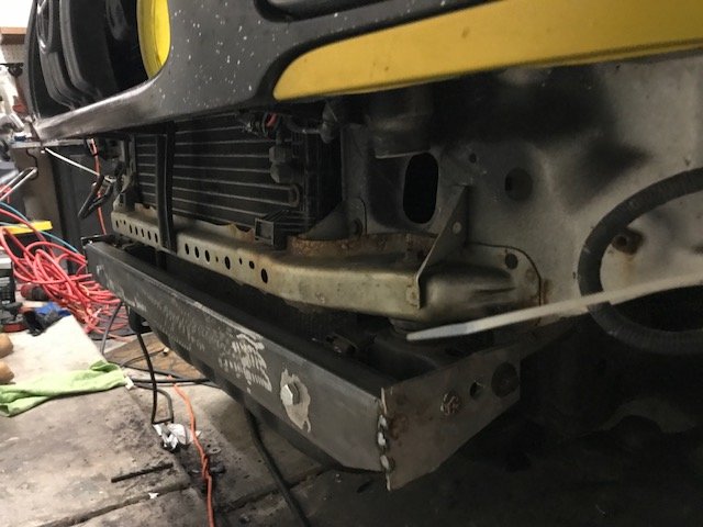

    The first step in mounting it was we Decided to mount the bar and side mounts first then bring the outside shell to it and level, measure and tack it to one another. Then unbolt it and drop it back down in one piece to lay down some thick welds and create it into one unit.

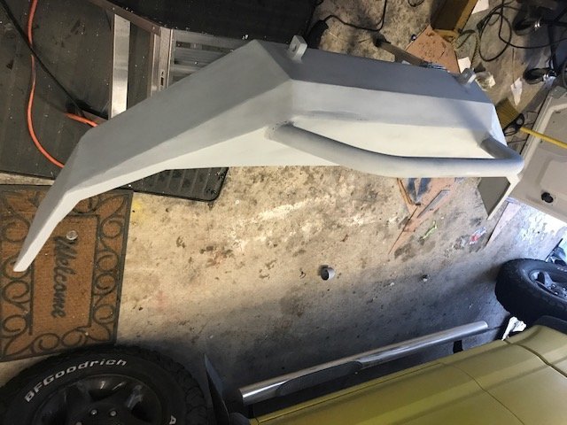

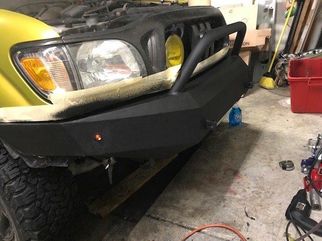

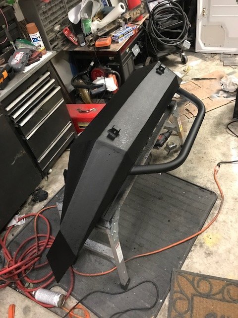

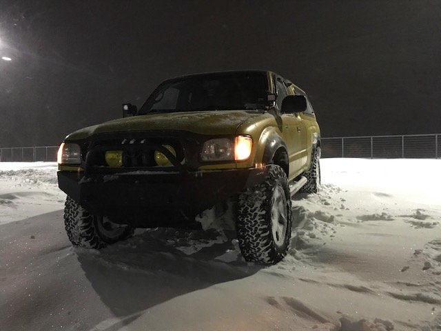

    First hit it with about 5 coats of primer, then decided to do 4-5 coats of spray on bedliner.
    The tabs we custom shaped and driled out to hold 5/8 shackles. The bar is actually ordered in from trail gear and I just welded it on while it was mounted.

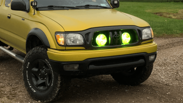

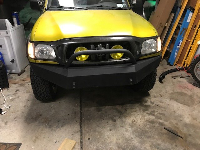

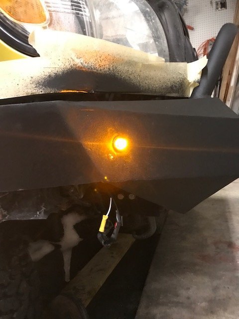

    The lights I ordered off Amazon. They were 3/4" led flashers. I found out I had hyperflash when I hooked them up so I decided that when I got the relay I might as well get all the other turn signals, license plate lights, and marker lights leds as well.
    I purchased them off superbrightleds.com. They're a very affordable, easy to use website, I found everything I needed in about 5 minutes.
    This was before I installed the lights.
    This still needed a couple more coats of bedliner, this was after about the 2nd coat.

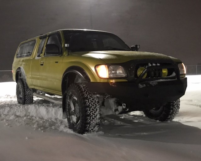

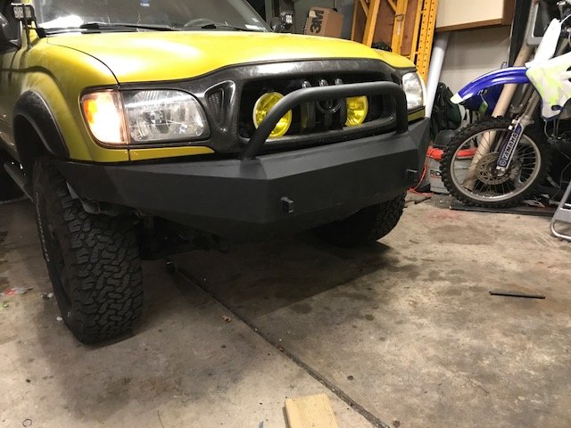

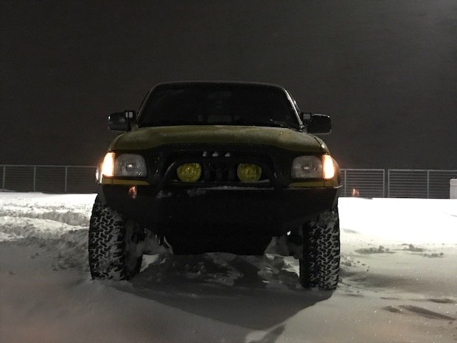

    LET THERE BE LIGHT!
