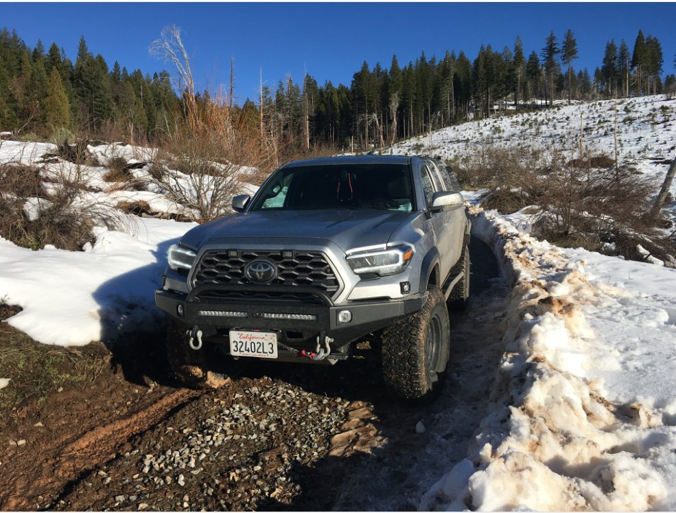

    This project was to add Zone 2 lights to my Tacoma. The idea is to illuminate to the left and right while cornering on dark trails. Also, to create 180° field of view: filling in the sides where my LED Light bar fell tapered off.
    https://www.bajadesigns.com/help/lighting-zones/
    I considered using A Pilar mounts but I didn't want glare on my hood or anything that would obstruct snow removal from my windshield.
    My solution was to flush mount Baja Designs S1 lights at 45° on the corners of the body above my bumper.
    I designed a flush mount that fits this location using FreeCAD software and printed it using my Prusa MK3S printer.
    Due to he complexity of the shape of this corner of the body, this was way harder than you'd expect.

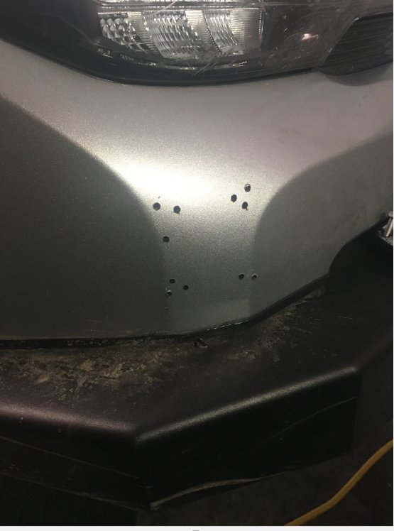

    After carefully positioning the mount, I drilled the four corner holes and temporarily installed the mount so I mark the corners that I would need to cut out to flush mount the Baha Designs S1 LED Light. Then I removed the mount.

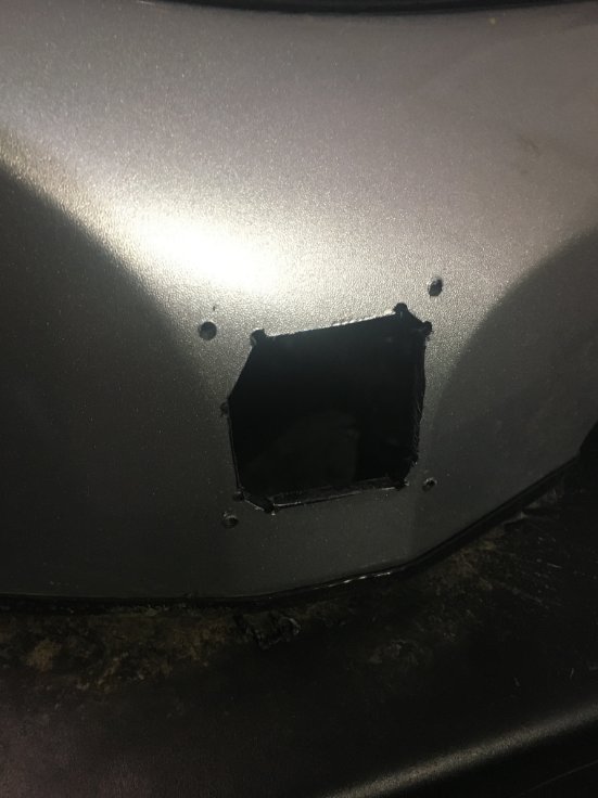

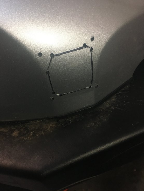

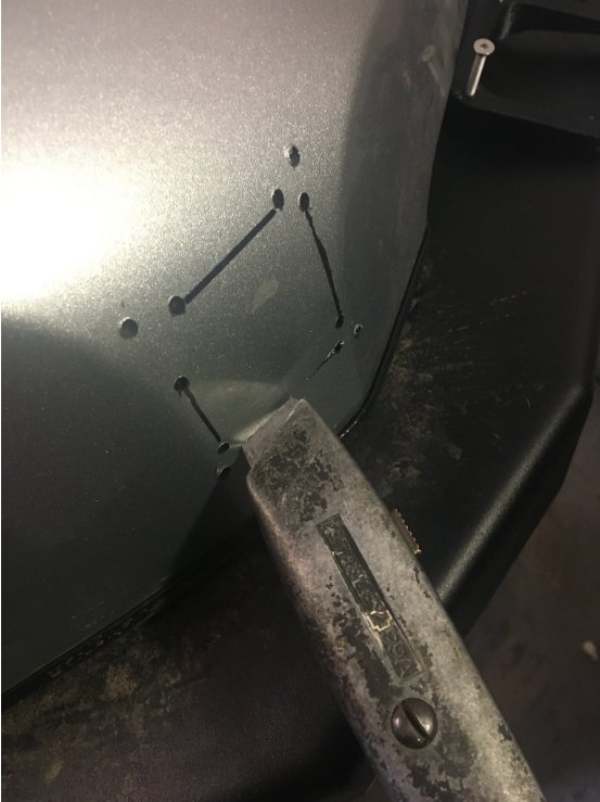

    Then I very carefully cut out the hole for the light
    After I cut the hole for the S1 I used a file to round out the hole (not shown)

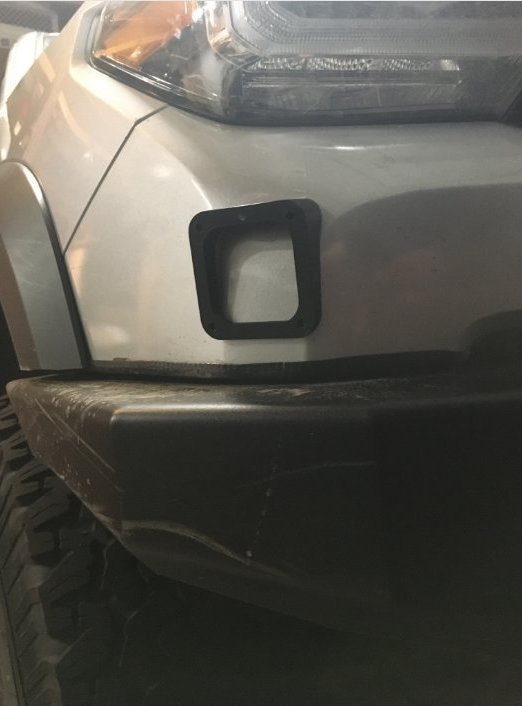

    Here's my first draft of the mount (my latest version is about 5mm thinner).

    I wouldn’t call them “flush mount” but they do look better than just bolting them to the plastic.
    what material did you print your housings out of?

    Yeah, as flush as I could get them in that location.
    This is PETG plastic.
