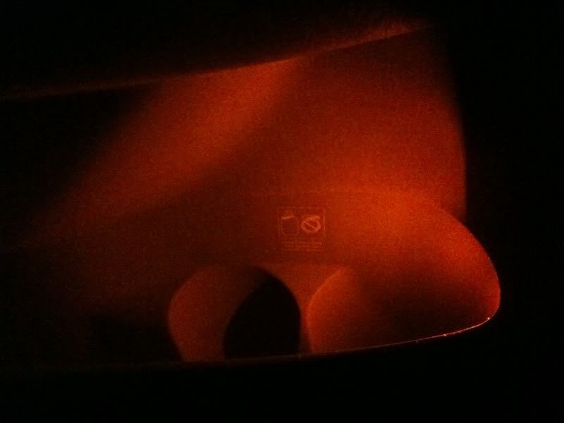

    I got an amber led from superbrightleds.com they were like 2 bucks and they have a 3' lead on them. 3M backing and flat line wire for the first 6 inches. they are .25" x .25". bright also. I put them in all 4 door pockets also and wired into the window power. the cupholder is just spliced into the backlights by the heat controls

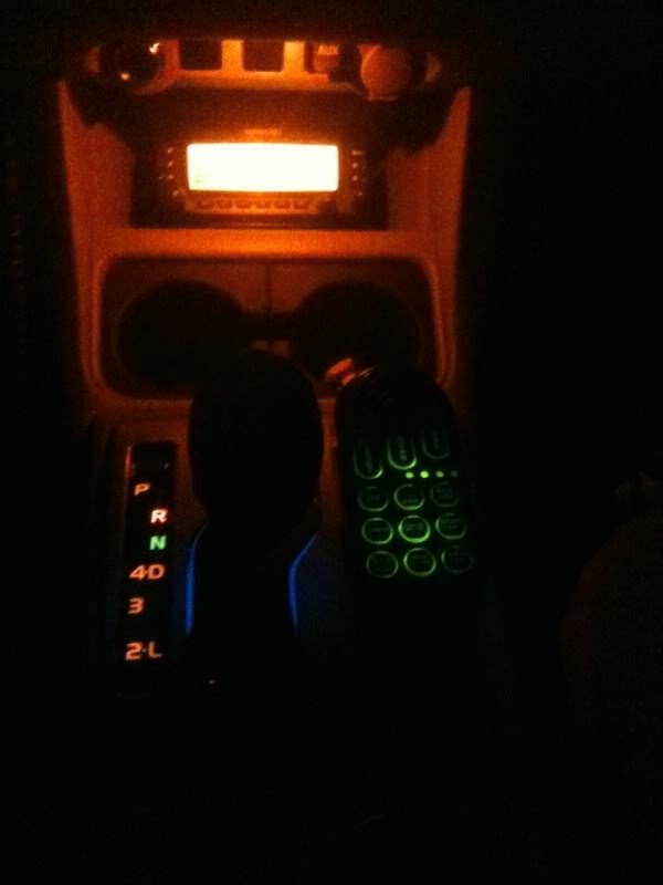

    The pic of the amber lights is a single flat led firing down. I mounted it on the underside of the dash right above the cig lighters. The pic doesn't do justice. It lights up the cup holders and the storage pocket awesome.

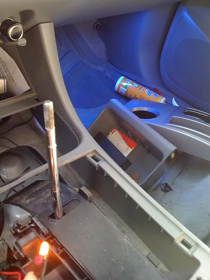

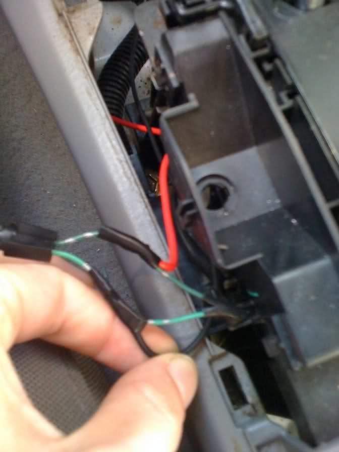

    here's my take on it:
    I used the light from the shifter as a power source. I spliced into it and ran a pos and neg off it.

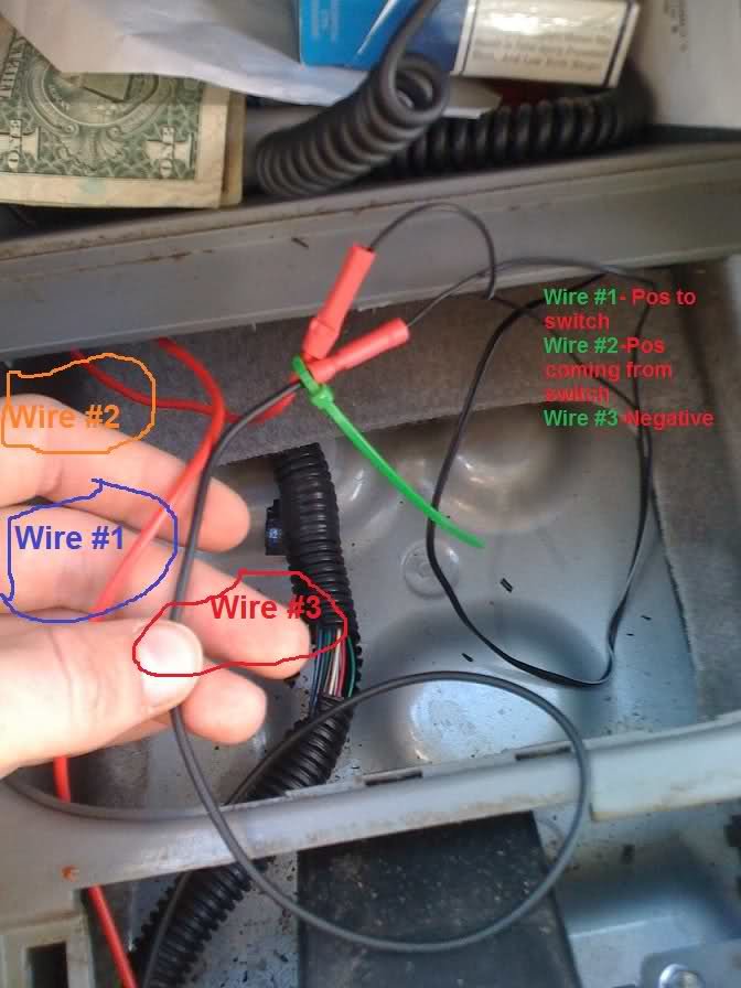

    my version cuts on only when the lights are on since it comes on with the shifter light. and on top of that, in my diagram i show how i ran a switch over to the far left cubby to manually cut them off if i want.
