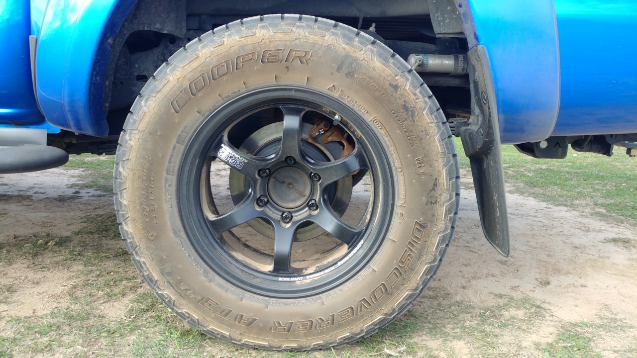

    I fixed my brakes with a rear disk conversion and sequoia master cylinder. To me now they are what the brakes should've felt from the factory. Expensive but worth it imo.
