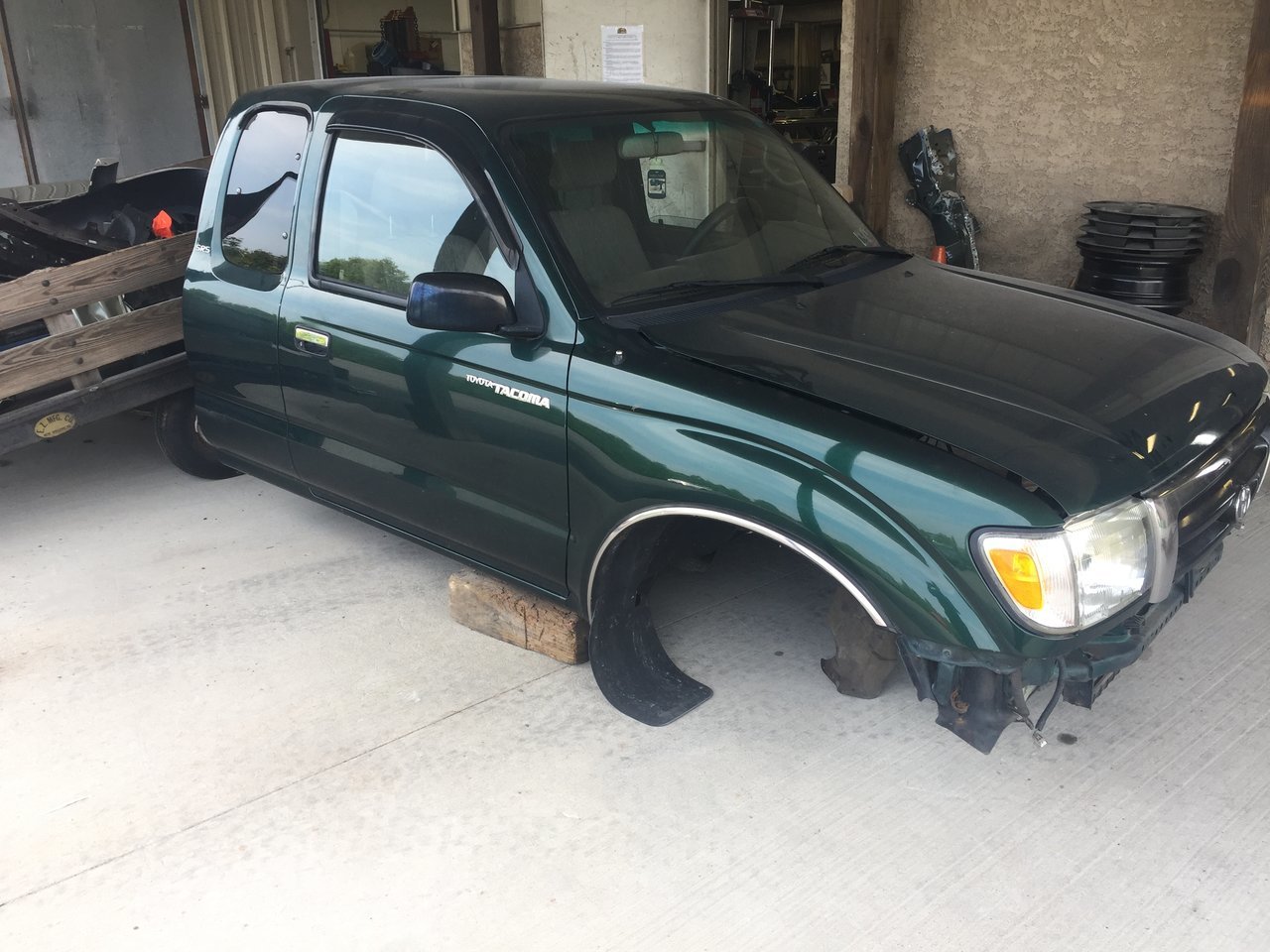

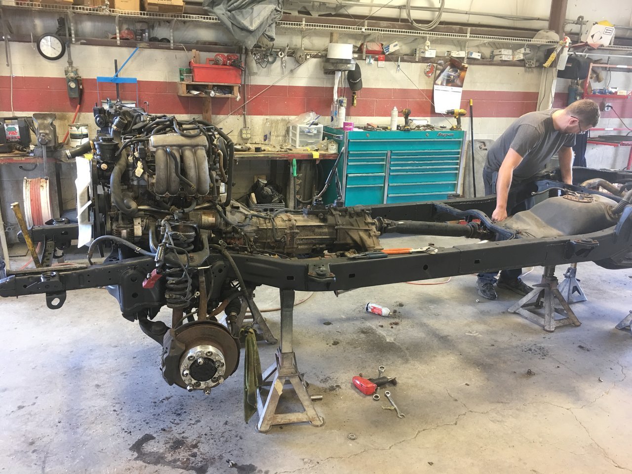

    Here's a rundown of the work they did. First they stripped the truck down to the frame, took the body off and dropped the engine and trans.

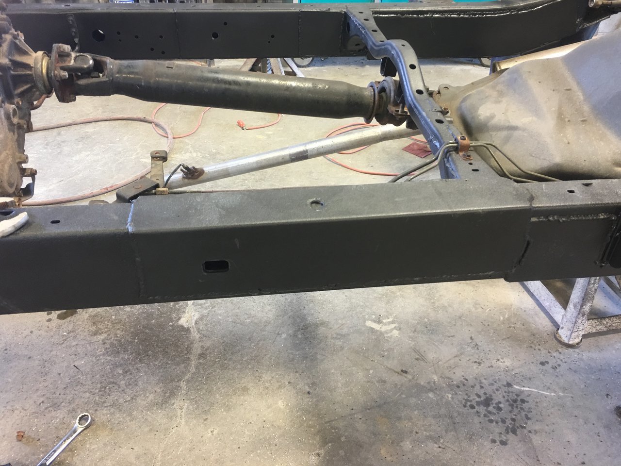

    Then, they sand blasted the frame down to bear metal, getting off all of the surface rust and rubberized undercoating I put on. Then, they cut out and welded 7 of these Safe-T-Cap Panels into place.
    Notice also, they applied what they called "chip guard" which was basically a waterproof adhesion compound that looks pretty much like the CRC that Toyota installs. They used an applicator wand to get inside the boxed portions of the frame also. They let that bake on the frame in their drying oven overnight.

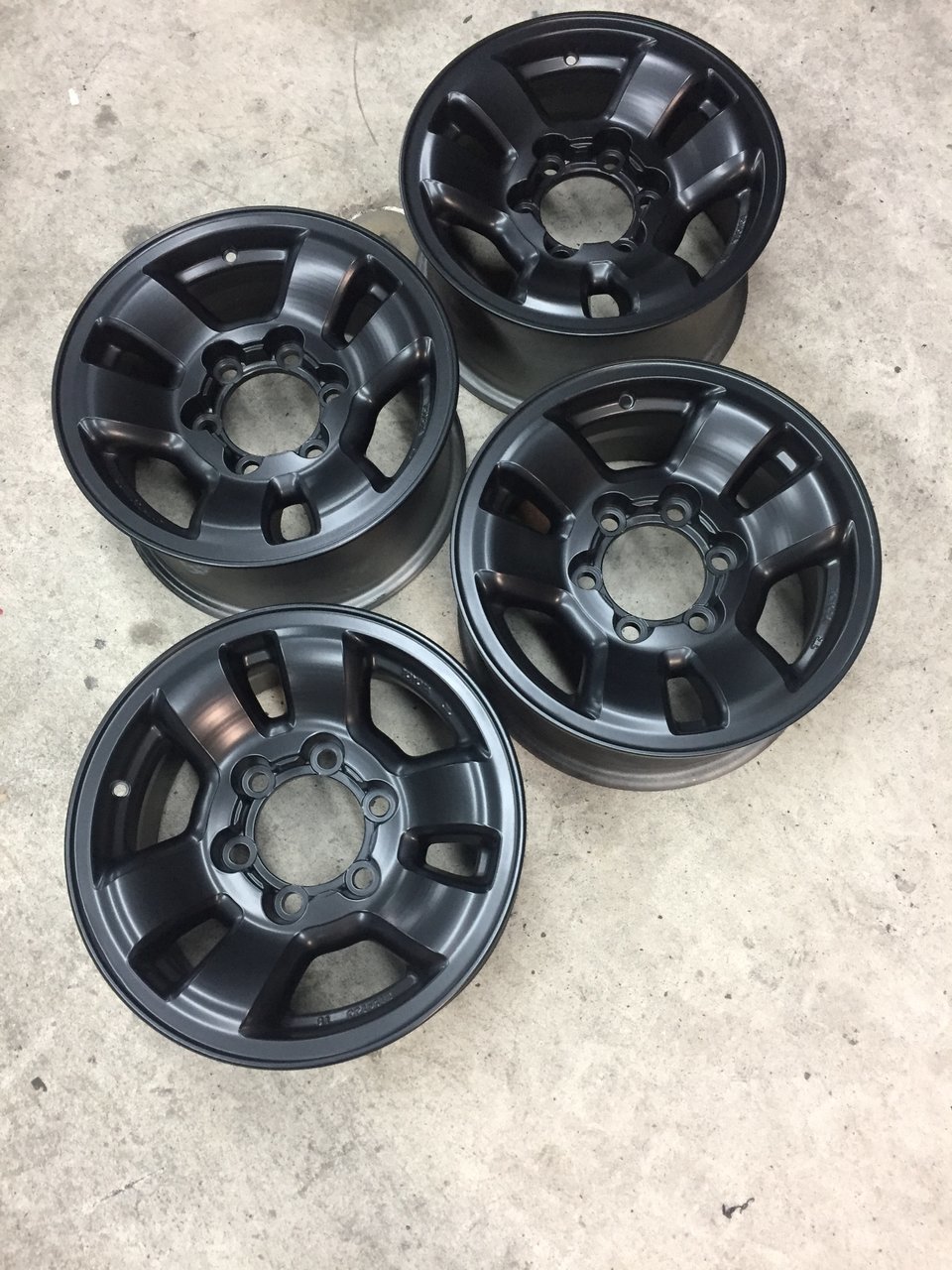

    While they had it there, I had them powder coat my wheels also.
