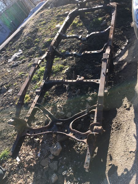

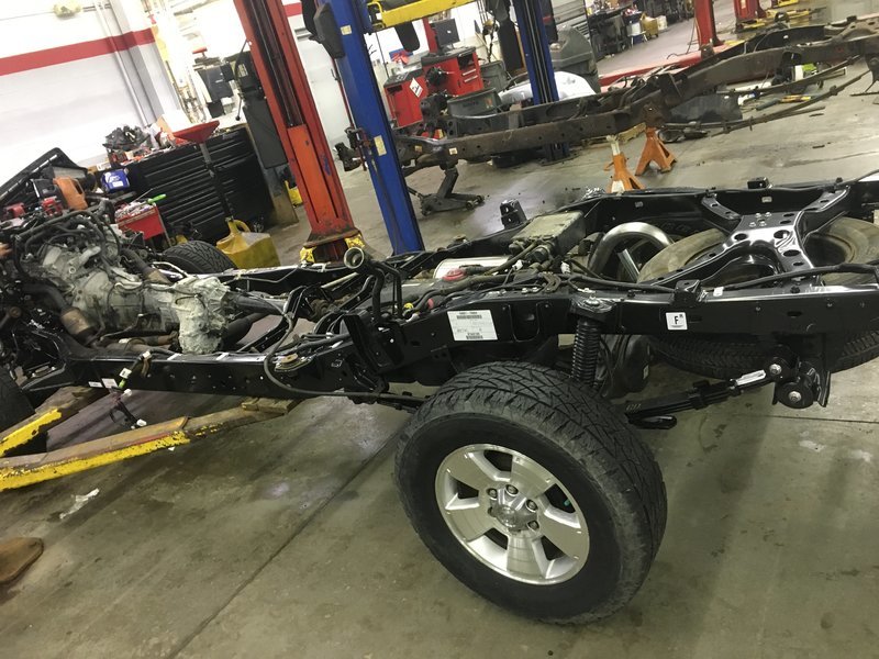

    I'm so happy with my frame swap, and my dealer, that I thought I would make a thread :)

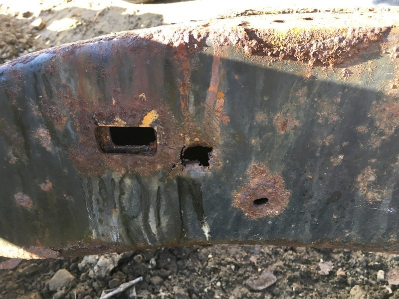

    I took my truck in for an inspection in November, it failed and was unsafe to drive. I was given a smelly, dirty Corolla for a rental. I complained about the car, and I live in the snow belt, it would have never gotten me through winter. My dealer actually went to auction to purchase a Rav4 for me. I was told that they also improved their method of cleaning rentals.

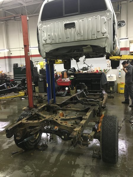

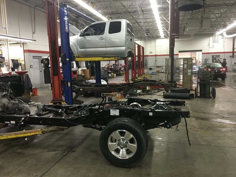

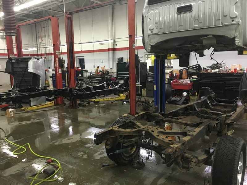

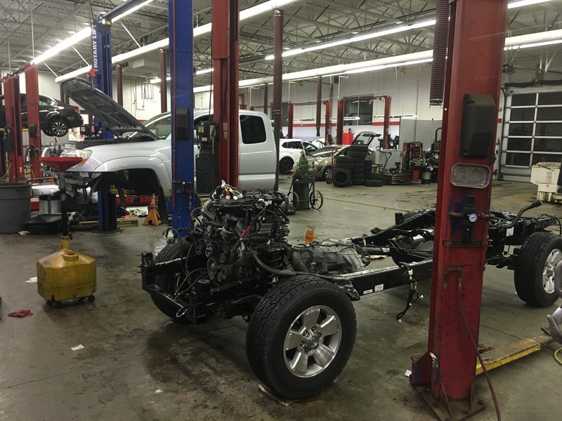

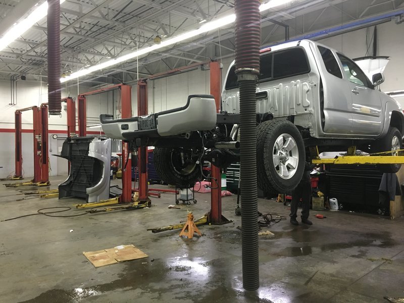

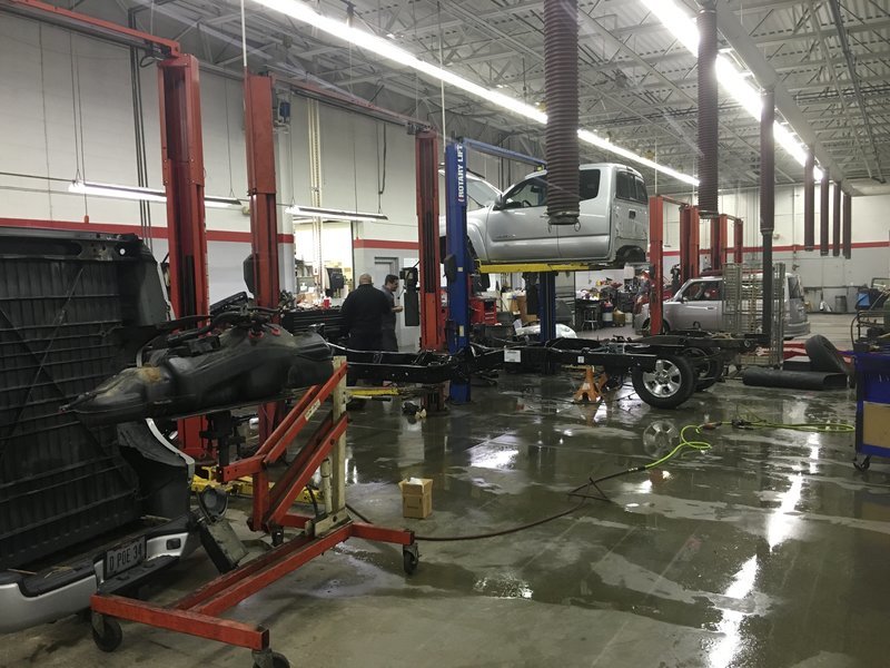

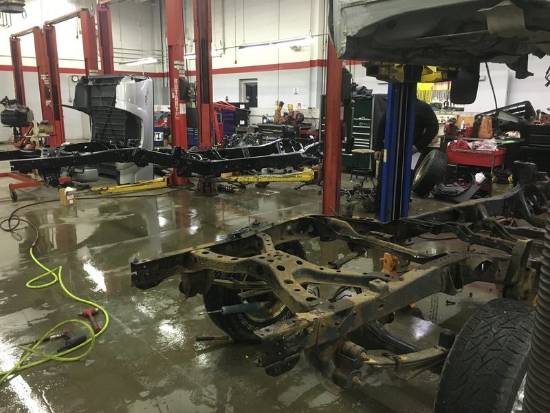

    Fast forward 3 months, and my frame is in! After a short wait for a "bolt package" the work begins at 5pm and the techs work until 5am. They have 2 shifts and the truck needed to be put together enough to get out of the way for the other shift. The next evening the techs finished putting everything else together.

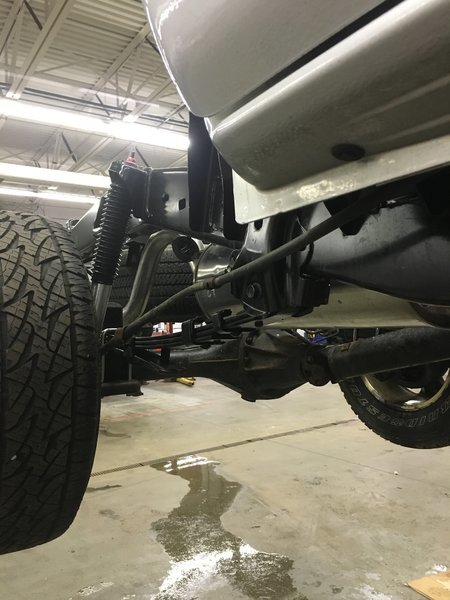

    I sourced my own shocks, Bilstein 5100's, had those installed for an hour labor. I had my own alternator installed, also an hour labor.
    When I picked up my truck, one of the service managers was happy to discuss the whole process with me, and was very knowledgable, I have had way too many experiences where I felt like I knew more than the service reps :( I found I had a couple of issues, and took my truck back in to have the rear brakes adjusted, they were dragging, and the access door handle was not operating properly after the recall work was performed. I was also missing a few misc. clips. When I came back in, I was able to talk to the guys that did the swap. One of them took pics! They fixed my access door, adjusted my brakes, and replaced some clips.

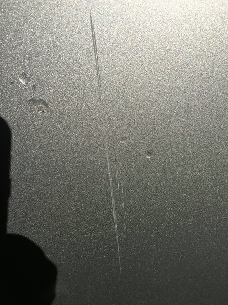

    My only issue was that I ended up with a pretty significant scratch on the drivers door. It runs vertically, and goes through the paint one one small spot. They have agreed to repair the door, I will update on the progress of that. I know we are nearing the end of this frame program, but I would highly suggest to anyone that is still taking their truck in, to take photos before you drop it off.

    How bad was your exhaust. I thought about doing mine with the frame swap. Mine has some corrosion, but can't tell how deep into the metal it goes. (not gonna do the hammer test on it ;)). After seeing your nice shiny exhaust, it makes me not want to put the rusty stuff back on.

    My exhaust didn't look bad, but being 10 years old and having 100,000 miles, I'm sure the rust was not far from eating through from the inside. A member here was kind enough to give me an exhaust a few years ago, when he upgraded, so I already had a new, shiny exhaust :)
