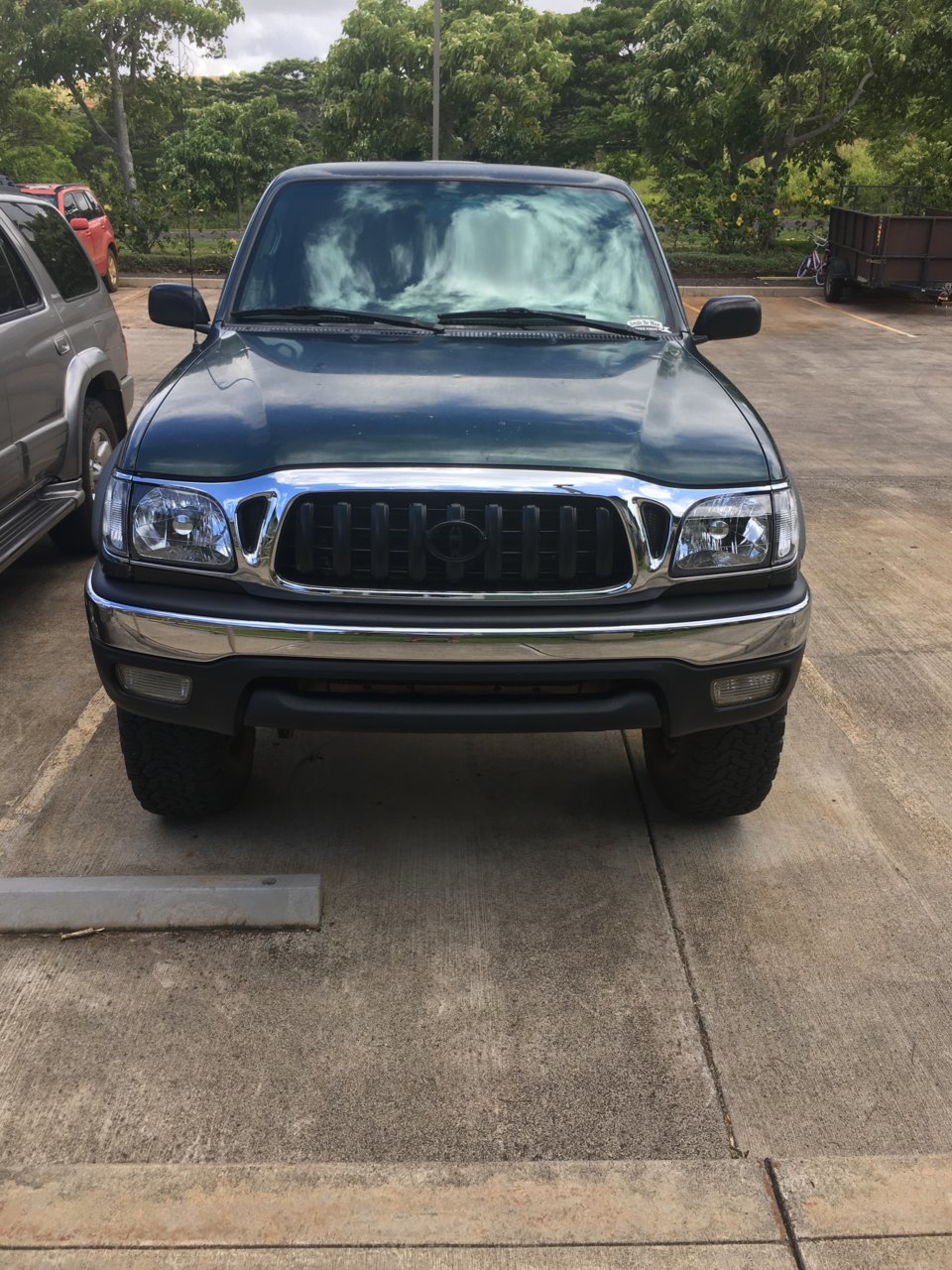

    Everything bolts up make sure u get the bumper brackets you might need the older radiator support for the smaller headlights I cut mine for the 01-04 headlights

    the bumper brackets for the center where it mounts to the frame right? What about where the bumpers mount in the corner/wheel well. Is it the same?

    I did not put it on the new clip planning on drilling new holes and making them work
