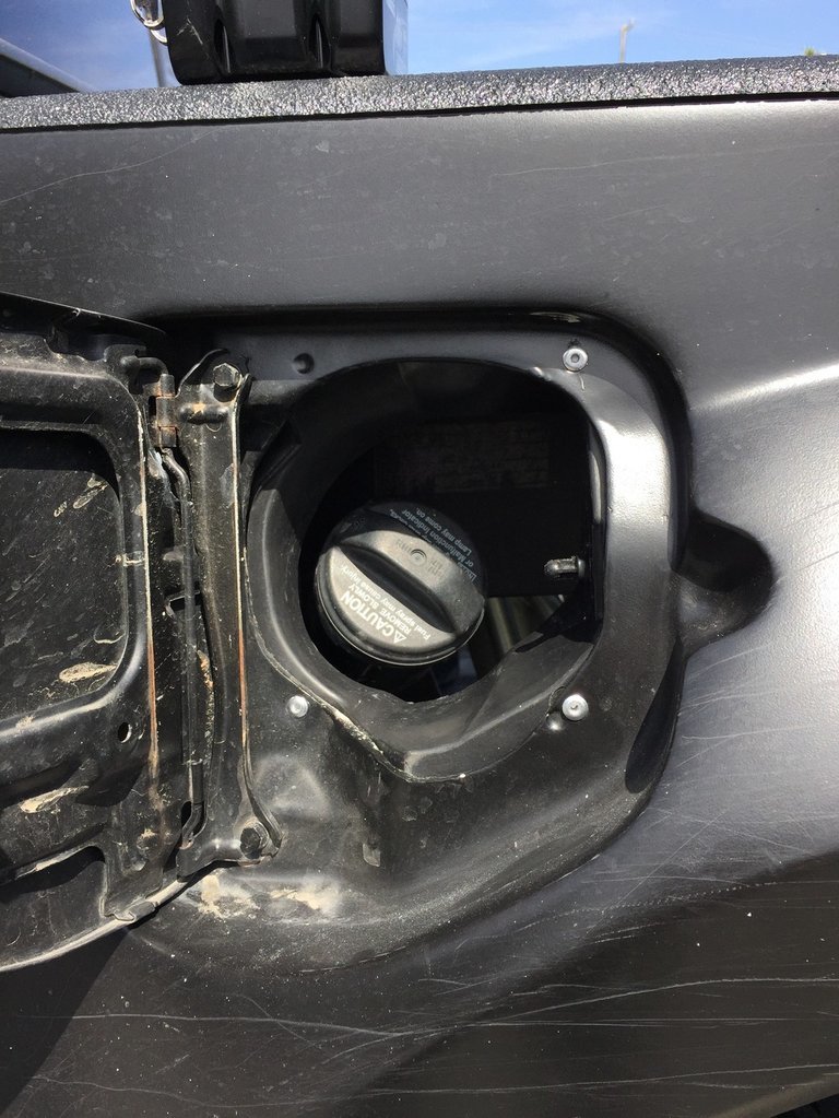

    For the past year, I got really annoyed seeing my gas door flap around while driving. I tried searching to find what others did to solve this issue, but I couldn't find much info.
    I finally got off my butt and put on my thinking cap and went at it.

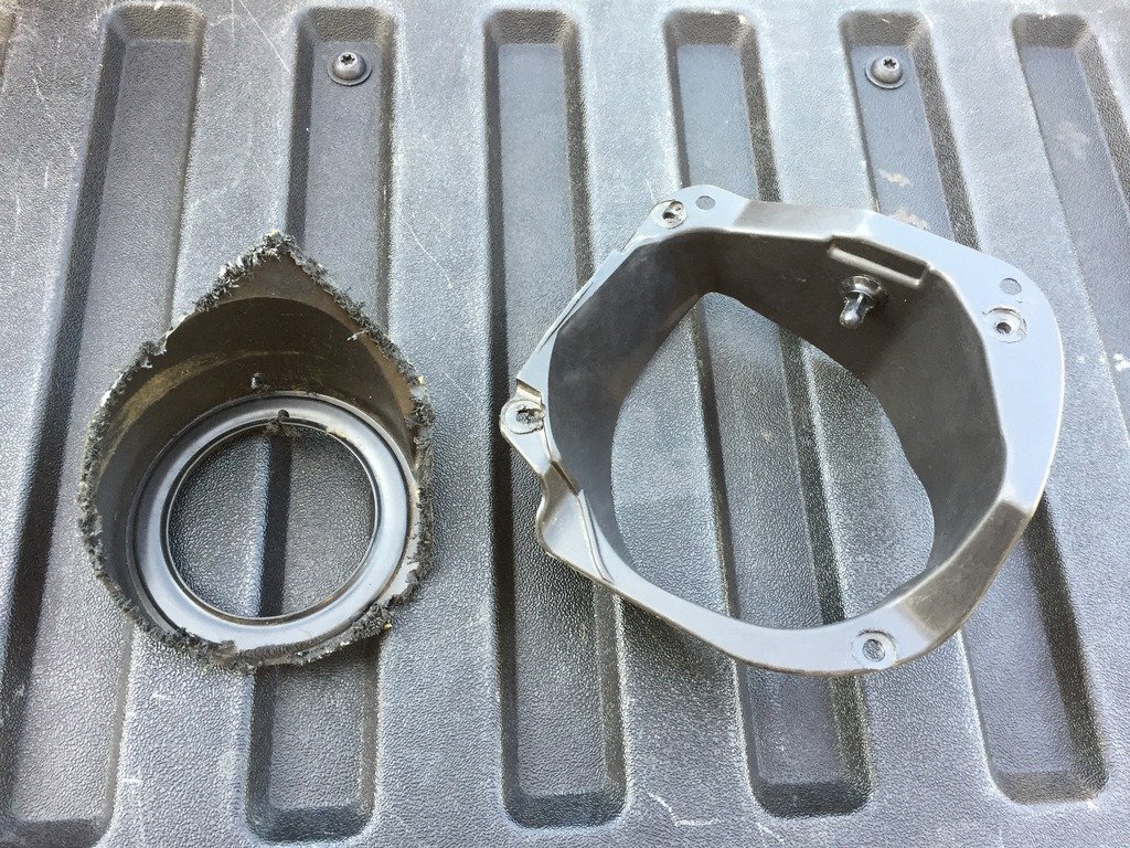

    I first enlarged the opening up and cleaned up the edges.
    3A579ED7-2718-4606-BBB6-1B1E003A3D77_zps_21f506be4acc7f0270a8f0fd7351a1216e7c9fc6.jpg

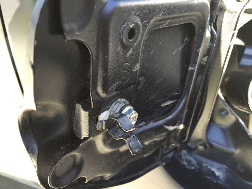

    I had to mount the gas door housing behind the bed instead of slipping it through from the outside. Otherwise, I wouldn't be able to close the gas door. So I used a longer screw and added some washers/spacers so the door would catch the "striker".
    2A383248-6C16-46DF-9B42-A0E83B1291B3_zps_929f499e664e0ce25554f7cfdcc48eaf594a2c0e.jpg

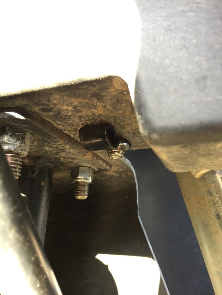

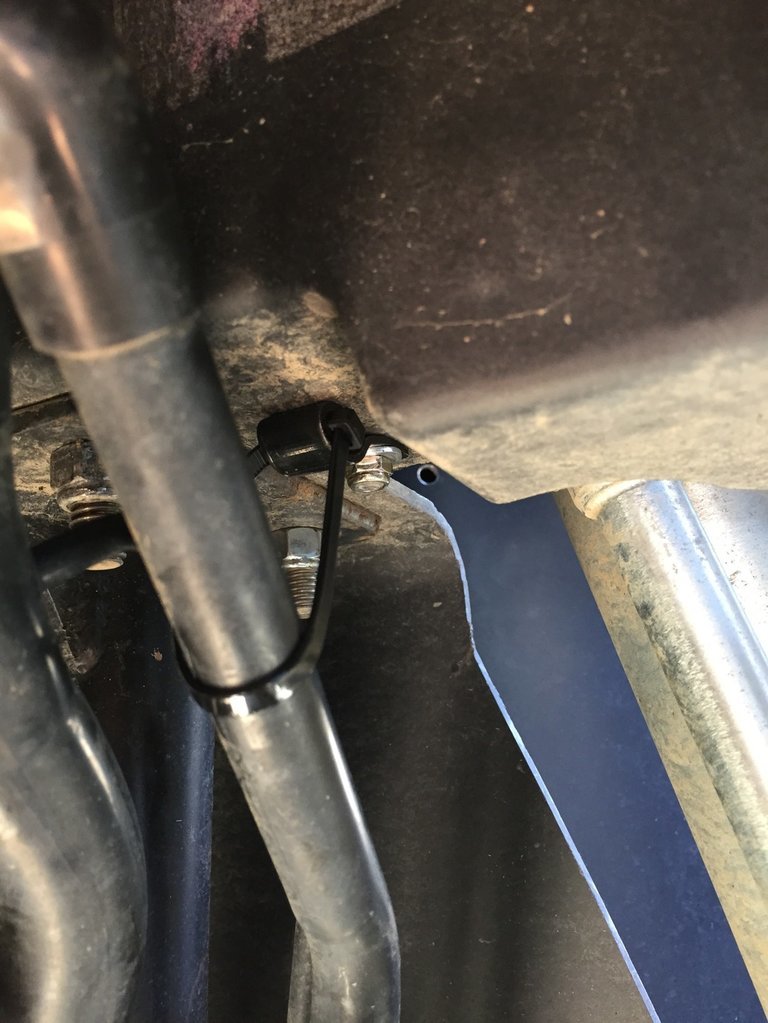

    In order to make the gas filler line up centered in the housing, I used a zip-tie to align it. I made a little bracket to use as my anchoring point for the zip-tie.
    0AF9951C-D3A8-4921-945D-26F1B80EE79E_zps_664d50d14d1c645778fd8798dfec91e4abad9f9c.jpg
    FFC7304B-2470-4E6A-A0ED-FB8ED2492479_zps_057fbecc6437507e3dbff58aadf1d6aa4c39b18f.jpg

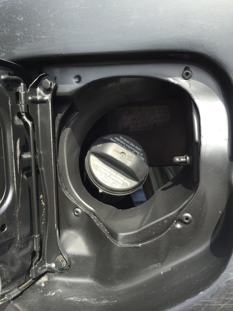

    With the housing behind the bed, I drilled 3 holes and riveted in place. 3 seems to hold it nice and snugged so I decided to leave the 4th as is.
    2633BA58-C4BD-4452-81EA-7F5DA500CE75_zps_f6798a28d5fd892fdf7e8e5a960a068011d0746e.jpg
    I sprayed a light coat of matte black on the rivets to blend it in.
    2753CC9E-32B1-4D08-8EA7-C376E02302F7_zps_794bb274749c4907f0e0acf4caa28047acf32d94.jpg

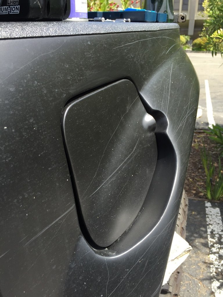

    Here it is closed.
    416E0565-610F-4117-8B24-50616B1C02D8_zps_51c870f32c30dfdde5027763bc7822875567f627.jpg
    Hopefully, this will help someone out.
