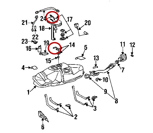

    Hi everyone. So a while back, one of the straps on my gas tank rusted out causing the gas tank to drop a few inches. I have since gotten a new strap, and holstered the tank back into place, but ever since then I have been getting a 441,442,446 codes. My inspection is coming up so would like to know the first place I should look for this? Something on the top of the gas tank that might have gotten yanked loose? Not tryna spend 500 bucks to get this smoked and fixed when I can honestly just tape up a hose or something.
    Thanks for any help!

    I would drop the tank and inspect all the tubes and wires. You may have pinched something as you put it back up.

    I bet either when it dropped or putting it back in place the vent hose or the line to the charcoal canister got pinched .
    If any of the lines cracked you would smell gas fumes around the truck all the time do you notice them

    @buildataco
    My guess is one of the hard line sections got bent. Based on the codes, most likely at #14 since that is part of the charcoal can system. By the way, I had trouble finding anybody to sell me that part when mine rusted off. I ended up fabricating one from tubing and a large washer. Later I saw them on Toyotapartsdeal.com 77018-35020 for $20.55. Better check MY compatibility. That was for my 1995.
