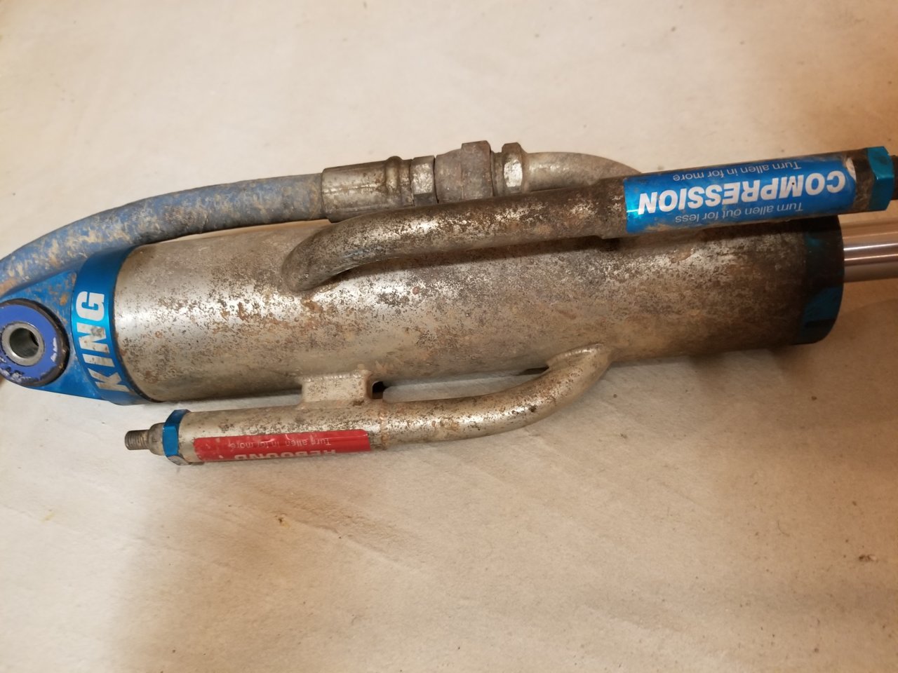

    Hello,
    The last days I am into rebuilding my king shocks and now after having three done and still three remaining I am getting much faster with it. With this post I want to share my general tips which I figured out over the process and with internet research on thinks which weren't covered by the general available manuals.
    Additional useful tools:
    - rubber strap wrench to hold the shock body for removing the head caps. Don't use/needed the aluminum vise clamps so far
    - manualy driven tire/bicycle air pump to slowly pressurize the reservoirs for disassambly
    - oil drip pan for motor oil change to collect the oil
    - syringe to remove or fill in small quantities of oil
    Tips:
    - during disassembly start first with the main shock before the reservoir. After you pushed down the main head cap to get access to the snap ring it is hard to get this head cap back up and removed from the shock. Now with slowly pressurizeing of the reservoir with the air pump you force the oil out of the reservoir into the shock which pushes then the cap out. During this process you almost need no force and you can control it slowly enough to not spill too much oil.
    - same procedure can be used for the reservoir disassembly
    - during oil fill up the Piston of the reservoir can be almost all the way at the hose side (maybe leave a 5mm gap). While installing the shock head cap you will eventually force enough oil into the resorvoir
    - before pushing in the head cap you want to remove the reservoir cap with the shrader valve so that no pressure builds up in the reservoir which will make it harder pushing in the head cap
    - when pushing in the head cap you want to make sure that a little bit of oil overflows, otherwise you can't be sure that air is trapped inside.
    - when pushing in the head cap you want to make sure that the Piston is as far extended as possible otherwise you might not have enough oil in the shock. The oil will be suppressed by the rod when it is fully immersed in the oil.
    - removing the springs from a coilover is not a big deal when you have the right tool. I was lucky to find a coworker who owns a Branick which he let me use. With short introduction by him I was able to remove one spring in roughly 5 min. A day before a local car repair shop wanted to charger me 50$ just to remove two spring which I was later able to do in just a few minutes.
    - the whole rebuild can be roughly done in an hour when you get the hang of it and you don't clean everything excessively
    - for 6 shocks I bought 6 rebuild kits and 2 gallon of oil which cost me 220$
    Sending these in for rebuild I would probably end up at 800$ included additional labor and shipping
    - I was not able to find a store in my region which is able to refill the reservoir with nitrogen so I decided to build a kit myself before spending all the money on shipping the shocks.
    So when anyone in South East Michigan/ close to Detroit needs a refill don't hesitate to shoot me a PM.
    Please be aware... I don't take any responsibility in case something goes wrong while following these tips

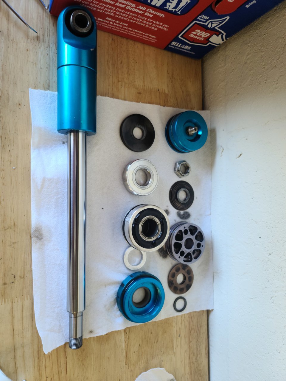

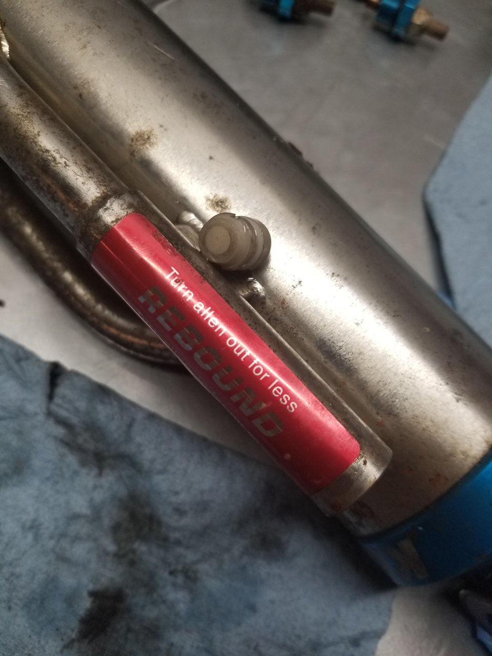

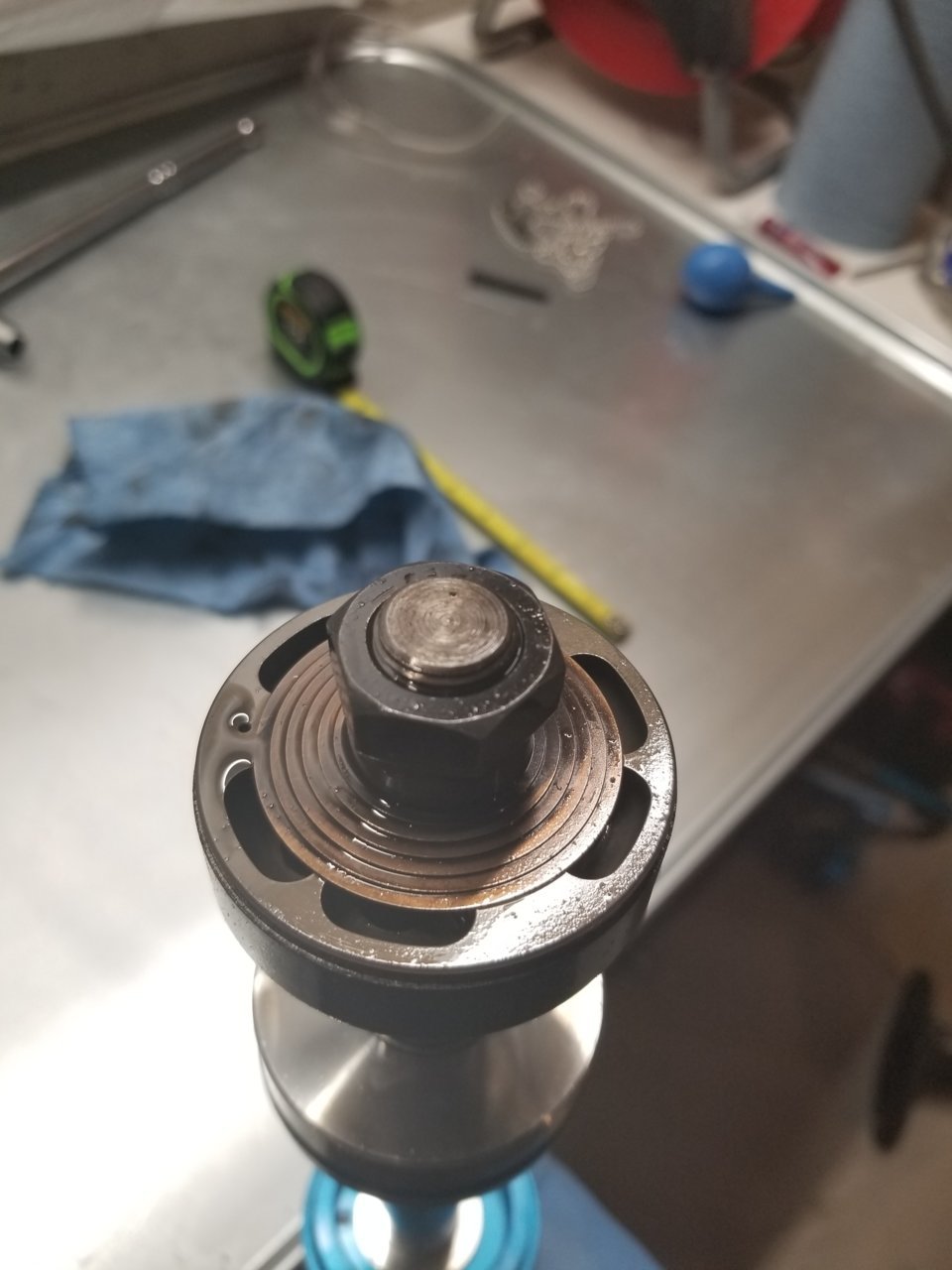

    A picture for the location of the piston (see small hole). Did not memorize it and had to open another shock first.
    Bypass shock: The white plastic piece without a hole in the middle goes to the rebound side
    Before
    IMG-20181110-WA0008.jpg and after treatment with scotch bride and mothers metall polish

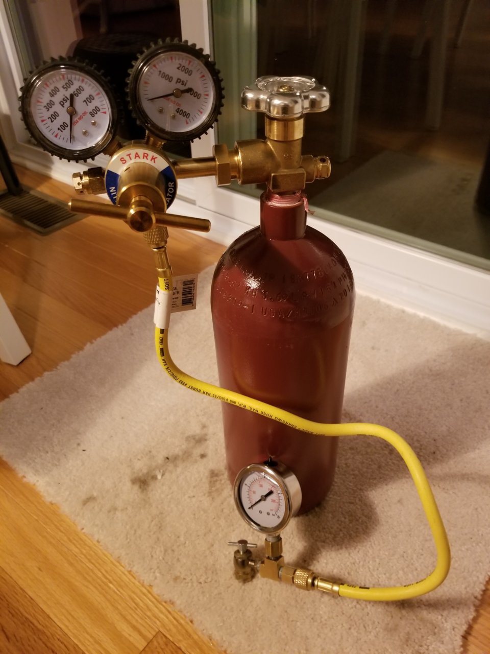

    What does your nitro charging set up look like?

    Oooooo that’s slick, get the regulators on Amazon?
