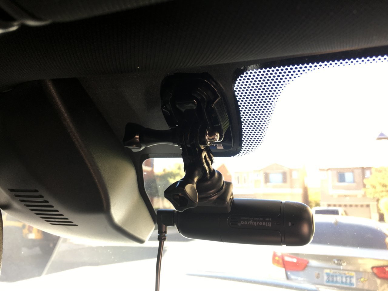

    I recently finished installing my dash cam connected to the GoPro mount of my ‘18 Sport and wanted to share a step by step of the build
    I have done quite a bit of research into how I wanted my dash cam mounted. A lot of people ask questions about utilizing the go pro mount. Unless the camera manufacturer has a solution, you are kind of stuck figuring it out on your own,which is what I ended up doing.
    I had the windshield tinted in my truck due to Vegas summer heat and didn’t want to use adhesive on the tint, leaving the mount as my only option. Also, I am frugal (Read: cheap) and on a budget so wanted to do it as economically as possible. As with any good write up I’ve got to show the final product first

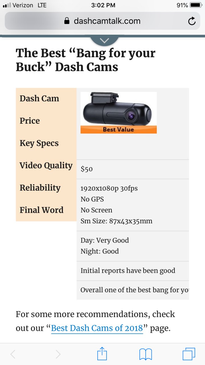

    I decided to go with the Blueskysea B1S. It comes highly reccomended on dashcamtalk as a budget friendly, reliable camera with decent features.

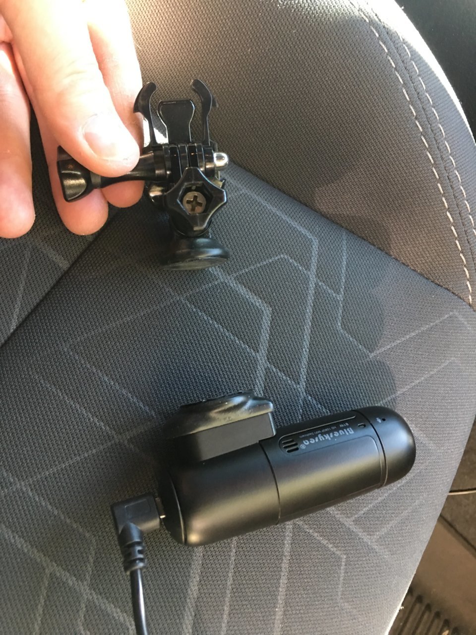

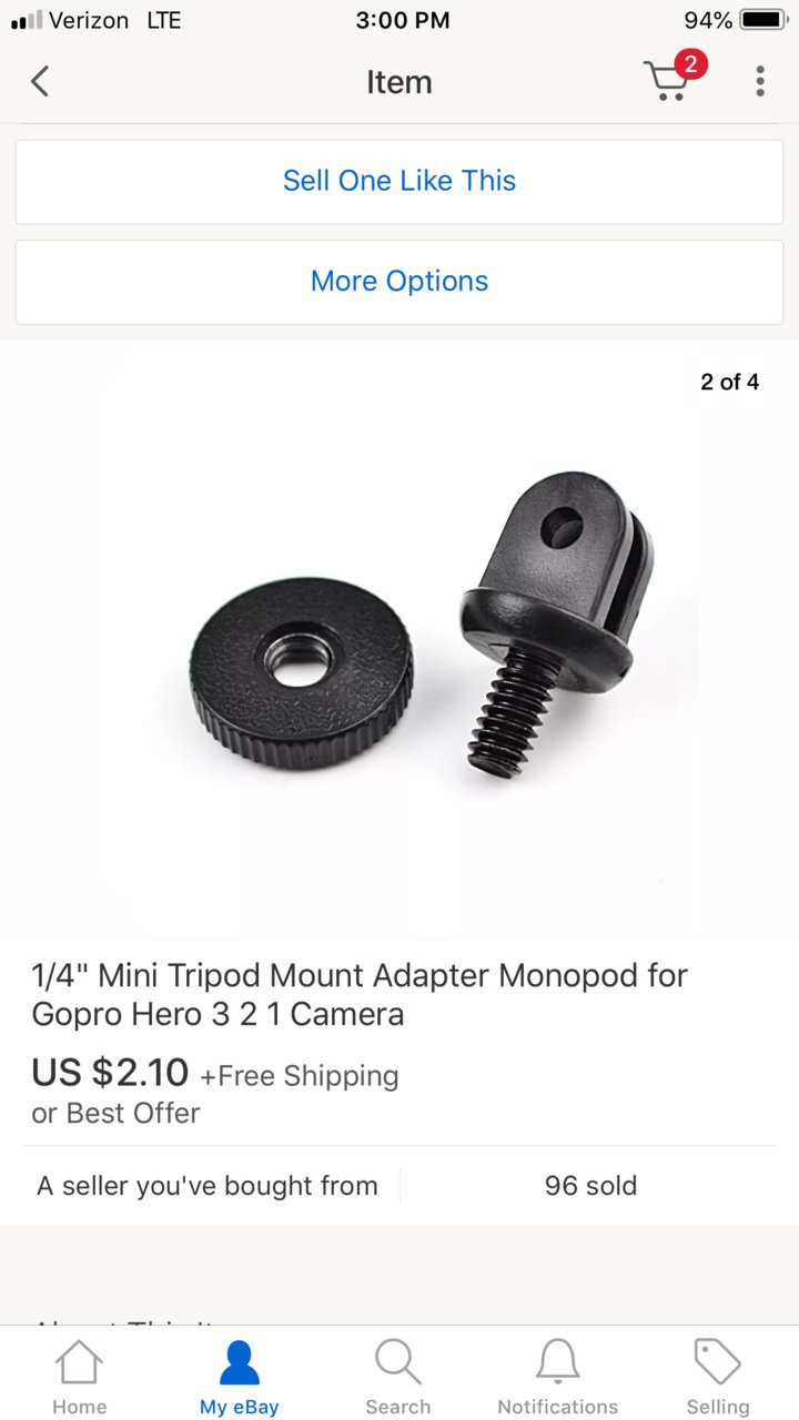

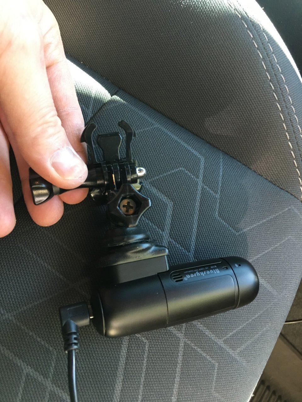

    To attach the camera to the mount I frankensteined as many Cheap Chinese plastic parts/screws as possible. I used ebay and Amazon and with free shipping on $2 items, it took about 2 months to get everything in
    And this is another option (still on its way, not used in build)
    I got the handle bar kit for the use of the extenders and thumb screws. And interestingly enough, the the actual bar mount screws could double as thumb screws as they have the same threads. I didn’t need them for anything now but have all the parts boxed up for a future project. I figured with the clip I could use no extender, short, or long. I ended up opting for the short extender to make sure the video cleared the mount/Center console and for the extra ability to adjust the angle since the camera only pivots along one axis

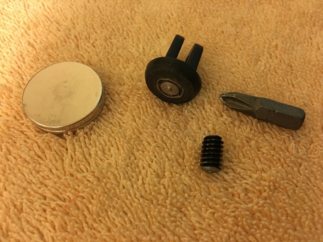

    My first task was to grind off the threaded post on the mount. Here’s a Phillips bit for scale8FC200FA-FECC-443B-9264-C7227216082B.jpg
    Now is where I decide to make things more complicated than they need to be..... and also forgot to take photos for the following step

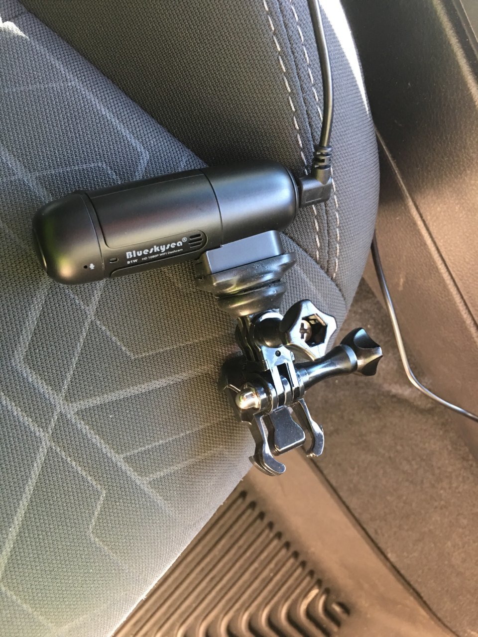

    You may be wondering what that silver disk is.... well it’s a super strong neodymium magnet.

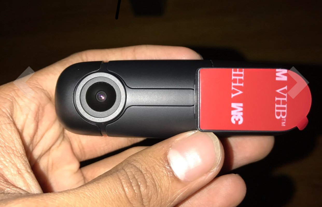

    In all my NERDiness, I’ve got a decent collection of super powerful neodymium magnets. I decided to make a sort of “quick disconnect” system for removing my dash cam if desired. The B1S has 3m tape for attachment to the windshield (see the following picture I stole from an amazon review). Now, if you are a normal person without magnets lying around, just stick the camera to the now flat circular two-pronged GoPro mount. Or if you’re me, JB weld the magnet to the mount, then stick an opposing magnet to the 3m adhesive of the B1S mount
    Now, I know what you’re all thinking at this point....
    “Hey, *RunawayCow2*, arent neodymium super strong magnets like, super powerful... and the zinc coating on the brittle neodymium not durable enough to sustain the collision of two super strong magnets?”
    Yes, you are correct. And in all my magnet-loving ways I have found Plasti-dip the perfect solution. Not the rattle can plasti dip, the thick molasses stuff that comes in a jar that you actually DIP stuff into. Also note that the container it comes in is METAL (remember, we’re working with magnets here....). I recommend dumping the PD into a class mason jar, and maybe even thinning it down for a more consistent texture.
    Again.... more missing photos of the individual dipped camera mount and go pro mount magnets dipped.... it’s ok there’s more pictures.
    After a few coats and making sure the mating surface of the dipped magnets is uniform, time for assembly!!
    1CC9BDF0-384A-4EA4-873B-7B2C39DFCE9D.jpg 876A2D6C-0CFB-4AB4-A184-04BE8EF2D393.jpg
