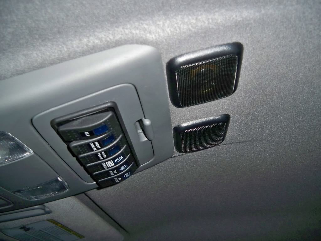

    I was thinking of doing this myself with a CB antenna. How well does mount and antenna fit into the diamond plating?
    What speakers are these? how did you install them?
