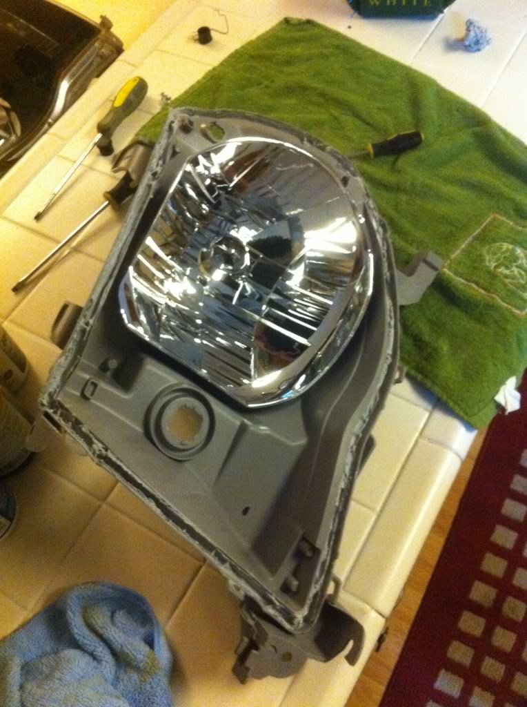

    Ok I got it. 300 wayyyyyyyyyyyyy too hot. 225 is perfect

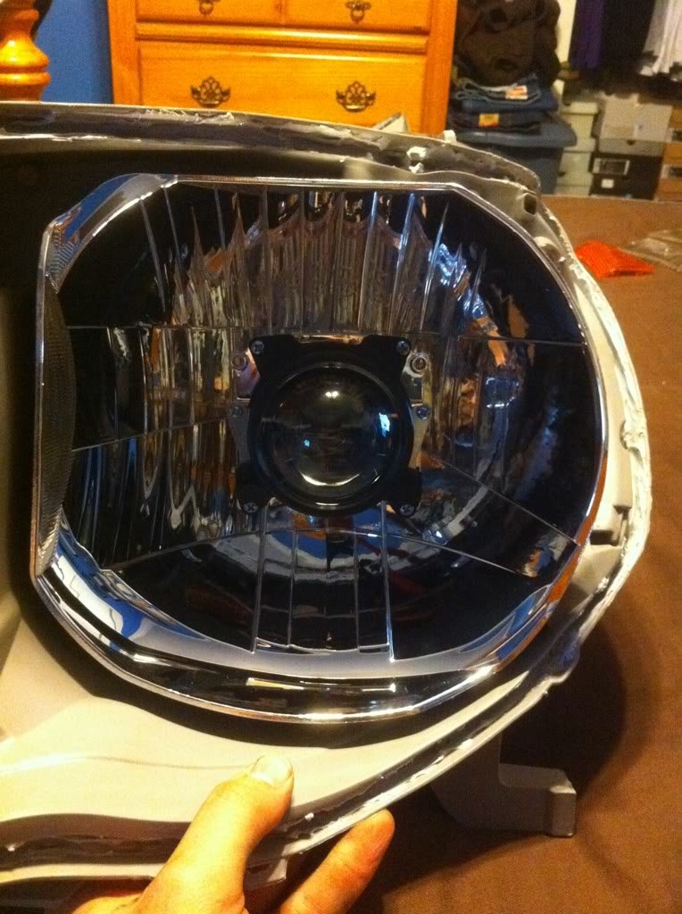

    is there a top or bottom to these projectors? i assume that the "morimoto" logo goes up?

    Damn I heated mine up to 375 for 8 mins.. but you have to make sure to turn oven off before you place the head light in there. If not you will have a nice lil supprize

    yea, i made sure that i always turned it off after i got up to temp. i just pryed the inside bottom corner up a little, then pulled it off with my hands
    i see 2 "lock nuts" on the projector. im guessing i pull both off, put the projector in, screw the first one all the way, then use the other like a jam nut?

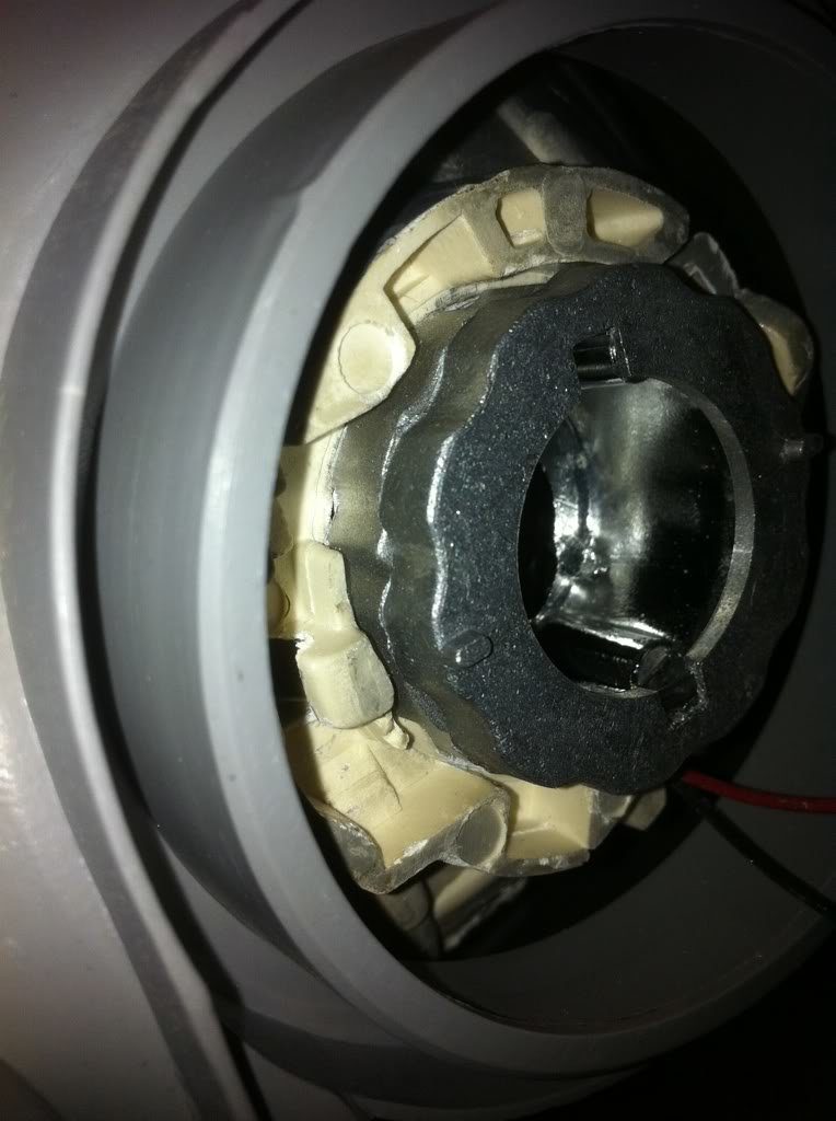

    Lock nuts like this right?

    -Satoshi Grille Upper/Lower/Triangles -LED Map Lights, LED Dome Light, LED License Plate Lights -No front license -Wet Okole -Weather Techs (digi) -Running Boards -Bed Extender -AFE Cold Air Intake 2SI Dry Filter -Tailgate Hose-Clamp Mod, Tailgate washer Mod -Combi chain lock on bed extender -no chime w/ key in ignition & open door -Fog Light anytime -Slim Cubby's 3kHID fog -bumper plugs -keyhole plug -TRD license plate frame -combi-lock storage -rear TSB -window tint -camera mod -Painted radiator/engine covers -LS460 RetroFit -Bed Tie-Downs -LED Gauge Cluster, radio, clock and AC -Bed Mat -Extra DRings -Painted center console, radio unit, ac panel, overhead console.
    wow 375...
    i do 280 for about 9 min: 290 oven off, headlights in for 9 min.

    so i guess i have the projectors in correct?

    The best I recall, they will only go in one way, with the tabs on them. BTW, did you end up with DS2s or H1s?

    i mean does the projector itself matter how its in the bolw? like is there a top or bottom to the projector? could i have it upside down? 90 degrees out? or does that even matter?

    test to see if its sitting the correct way, otherwise you be lighting up in the opposite direction when you flip your highs heheh

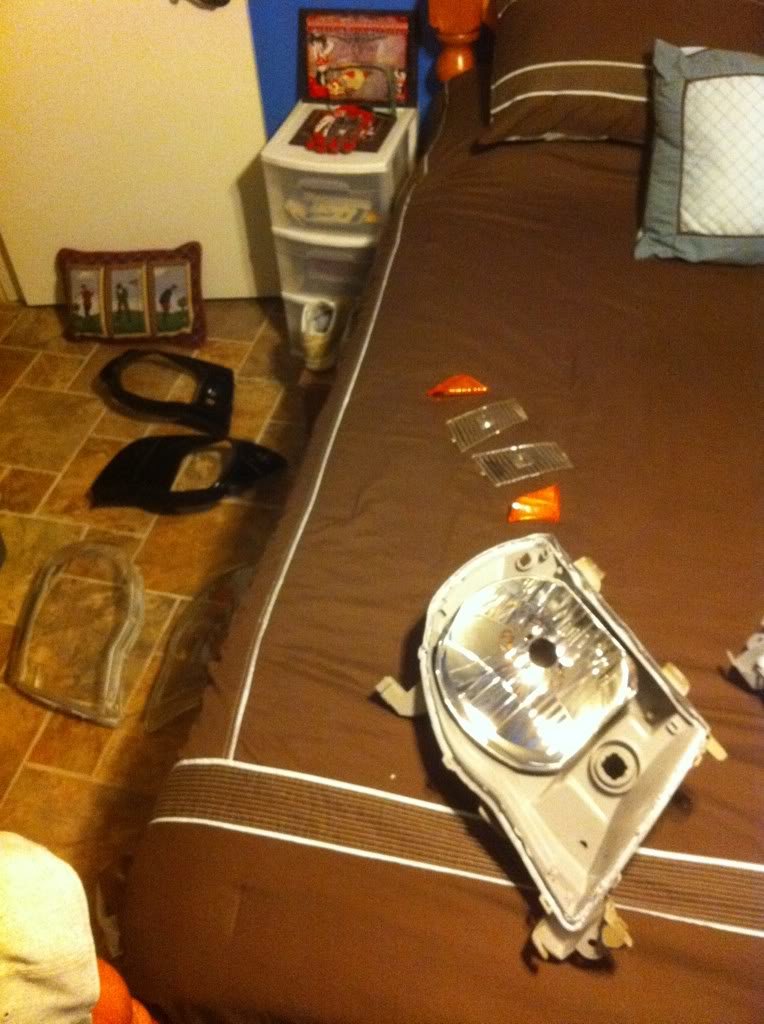

    ok, got my stock headlights out now. going to try and figure out this huge wire harness thing now. this thing didnt come with any instrustions at all? im sure they are closed by now, but really?

    but im looking at the new bulbs that go into the projector. im trying to figure out how they stay secure and tight, i think hat they left out some rubber washers or something for this. because right now, the bulb isnt staying tight at all

    The porjectors should sit with cut off shield down when you mount them in the reflector bowl. As for the bulb there should be a metal ring that will go in behind the bulb then you can thread the locking ring on there and tighten it down.

    thanks. ya i got it now. they shorted me a rubber waser, so i had to improvise. im hoping i canget yall some pics sometime tonght or this morning ;)
