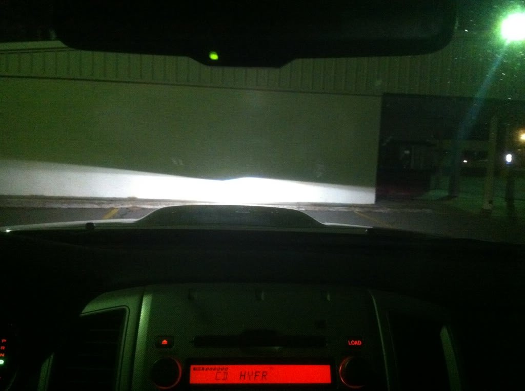

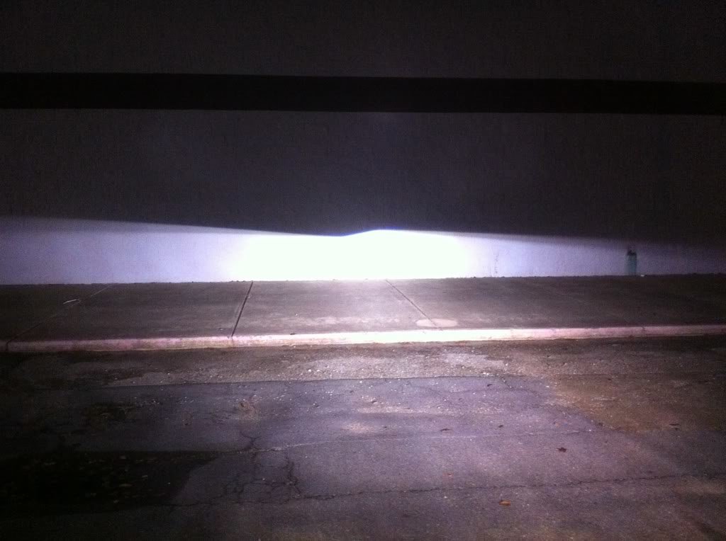

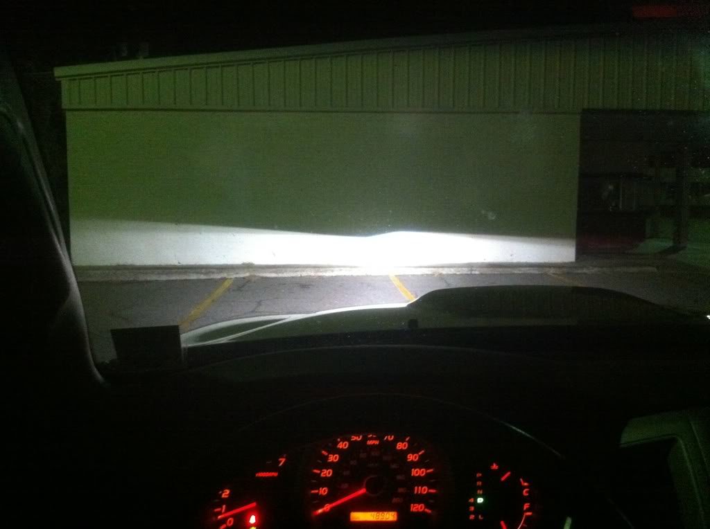

    Looks great, I did the same retrofit a couple months ago and am happy with my results. In your output pictures, are both headlights on? Normally you can see the step between the 2 projectors. Either you aimed them on top of each other or you got your horizontal rotation perfect. Here is a picture of the output from my retrofit. I think my driver side rotation is just a bit off

    Yea I aimed them ontop of each other. I'm going to adjust them again

    As far as aiming them. The distance between the steps on each cut off should be the same distance as between each projector when you are 25' from the wall.
