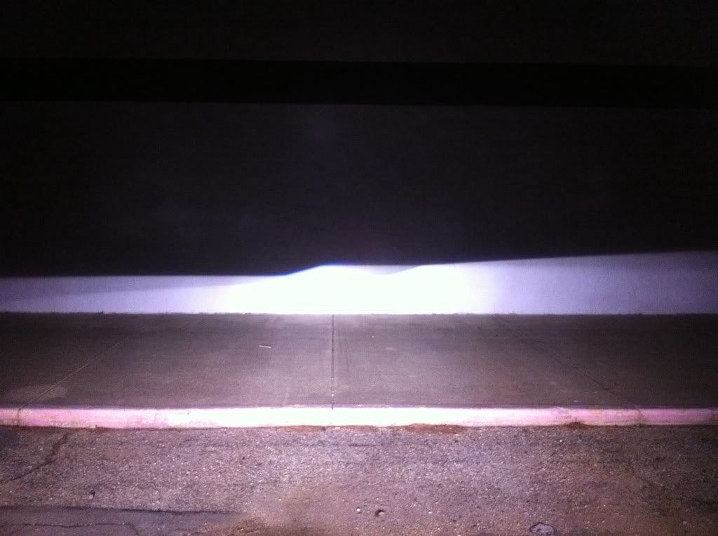

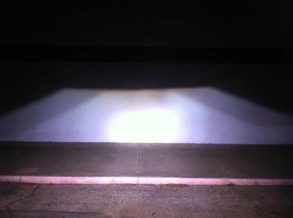

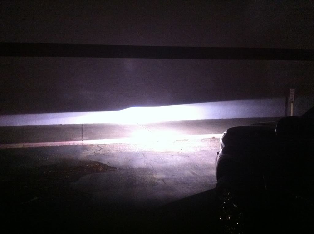

    Ok well long story short, I pulled them apart :(. I did the best I could at securing them. The drivers side is great again. Passenger side is still out some, but I can live with it for a while
    Highs (still need to adjust them up some)
    I see what you mean now about how I adjusted the steps right on top of each other. Now I adjusted them apart like they're supposed to be at 25'. Still need to go up a little bit. But it's better now. Man I just wished I had them horizontal like I did at first. Wished they would of stayed but o well. Just isn't my luck

    I know dude. I can't get them to really get tight tight. They're alot tighter now, but I can't get the passenger side to cooperate. I'm gonna fiddle with it this weekend
    I know they need to be adjusted up some, and the stupid passenger side grrrrrrr. I sure hope it stays where it is

    Just try and turn the pass side projector a little more. Thats how mine looked when I first installed them. I just took the bulb out and took some pliers and turned them a little bit. You can move the wiper fluid reservoir to give you more clearance. If that doesn't work, you can try and flip the adapter plate if you need more rotation. It doesn't take much rotation for it to look off, especially 25' out.
