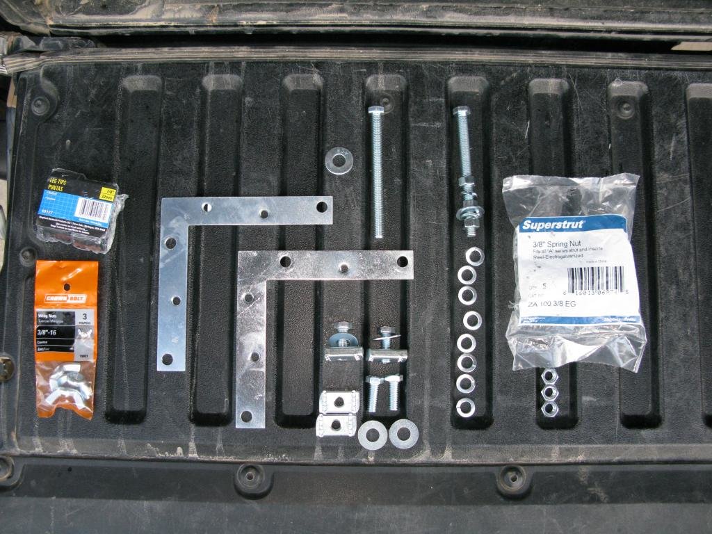

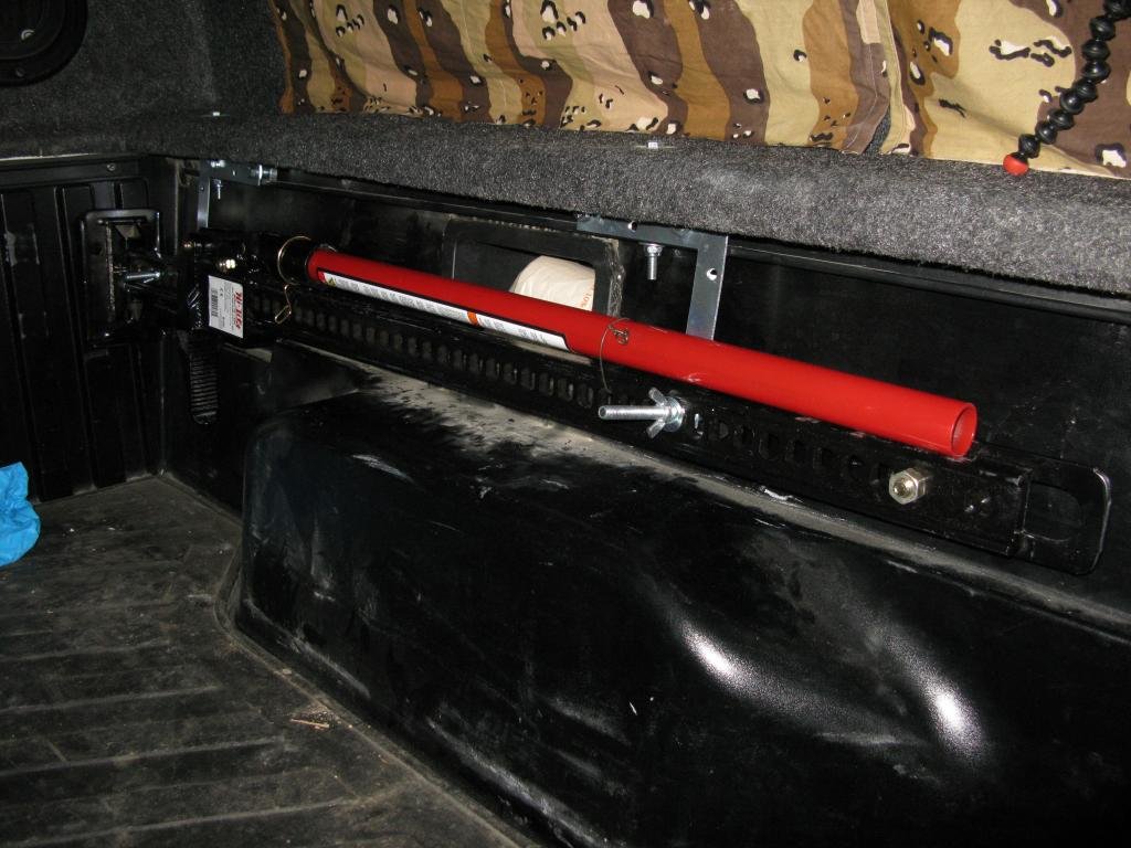

    So I have all the parts, drilled the holes larger in the L-brace but tried to use 1/4 inch to hold the hi lift. Wrong, the jack is too heavy. I am mounting mine to the side rail. Have you noticed any wear behind the mount as it hits the composite wall? Thanks.

    damn that was simple! I may try it out, but double up the L brackets to reduce the metal fatigue factor and add some strength...
    I have the Hi Lift attachment that you hook on your wheels instead.
    I carry a jack stand to put under the axle so that I have a solid (and safe) set up before working on the truck. At least that is my plan, I haven't had to do anything with it yet!

    i havent noticed any wear.

    What size are the bolts that are the "pins" for securing the jack to the actual brackets? Did you drill out the bracket any for these bolts?

    IIRC i used a edit: 1/2" bolt with wing nuts for my mounts.
    edit: way off
    he used maybe a 3/8" ?

    ya, maybe 3/8"

    3/8 .... ok thanks!

    I'd use 1/2 or at least 7/16

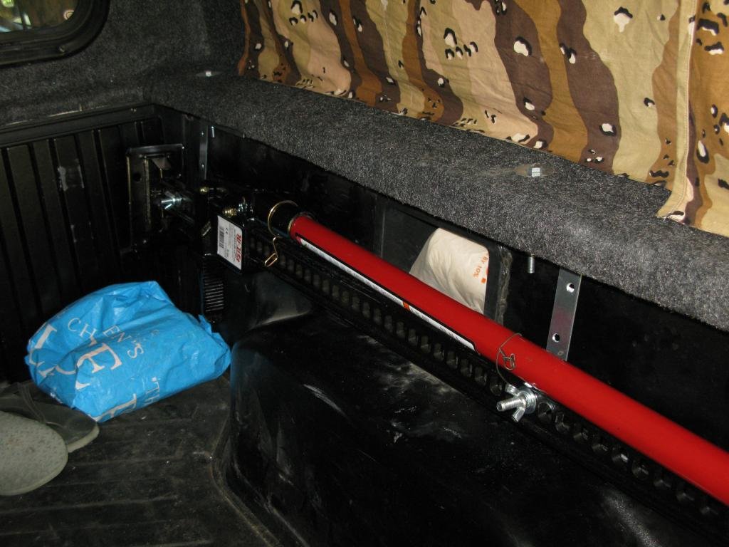

    Heads up- the hi lift is heavy as you know. i think it might swing a little when just hanging there.

    Yes it can swing a bit. But when I'm off road I usually have so much stuff packed back there it won't have much room to move.

    If you've got some strips of thin gauge metal and a way to cut it and weld it or just bend it you can make a pretty decent mount.

    yup... it rattles around a little bit when i go over bumps.
