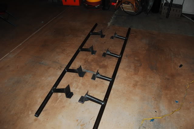

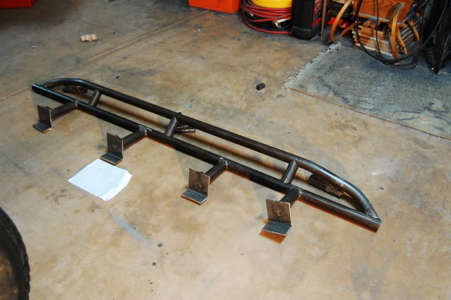

    Alright, so i've been working on these for a while but now i finally got enough work done to show off what i got:cool:
    they're all 1.75" 11 gauge dom tubing
    and the mounting plates are 3/16 plate steel.
    to make the mounting plates and cut out a piece of sheet metal, then made another cut half way through at the spot i wanted to bend it, and then pounded on it with a hammer till it was at 90* then i filled in the gap with a few passes of the welder.
    i have 4 legs going to the frame, but i'm still undecided about how many supports to put between the tubes. i know 4 will be stronger, but i'm not sure if i really need that many.....but i'll probly end up doing 4 supports in the middle.

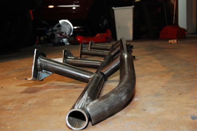

    for the outer tube, i wanted to do something original. at first i was thinking about doing a kick-out similar to beefed taco and CBI, but with a kick-out in the front and back. but after talking and thinking for a while, i came up with a new design.
    there are two main types of sliders, the kind that stick out flat, and then the kind that rotate up to tuck into the truck, but i wanted to make a hybrid of the two. So the ends of my sliders are flat and stick out straight, but in the middle they're tucked up into the truck.
    it's kinda hard to explain so you'll just have to look at the pictures:p
    so to finish them i just need to notch the outer tube of the drivers side and make 4 or 5 more center supports.....then paint and weld them on!
    i'll update this as i finish them and the i'll show install pictures and trail pictures

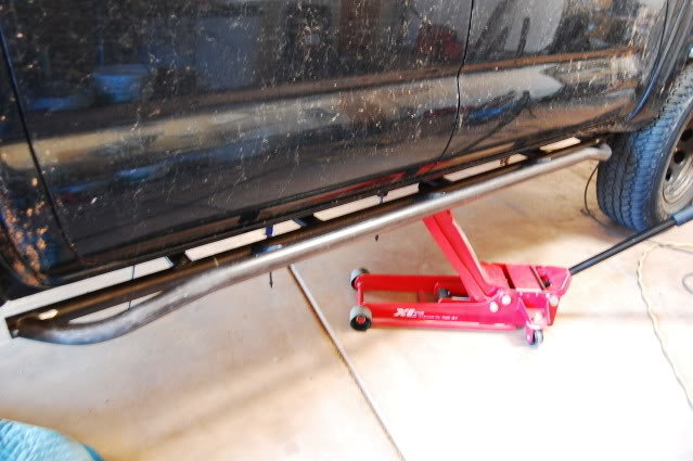

    passenger side is done
    for the drivers side i had it all notched and ready to go, but it ended up being like 2" wider than the other side. so i had to cut it down and i still need to notch it. then i have to make all 3 center supports for it. so it's got a bit of work to be done
    but here's a pic of the passenger side clamped on the truck!

    sorry the picture is blurry and is way too close to the truck. better ones will soon come.....well better ones will come when the sliders are welded on, hopefully soon-ish
    perhaps saturday night:p
