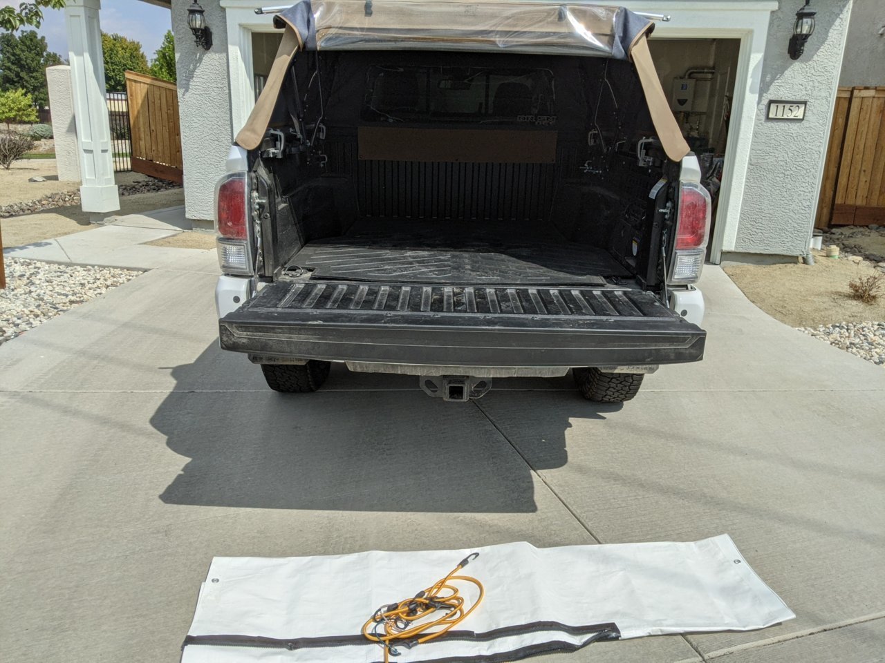

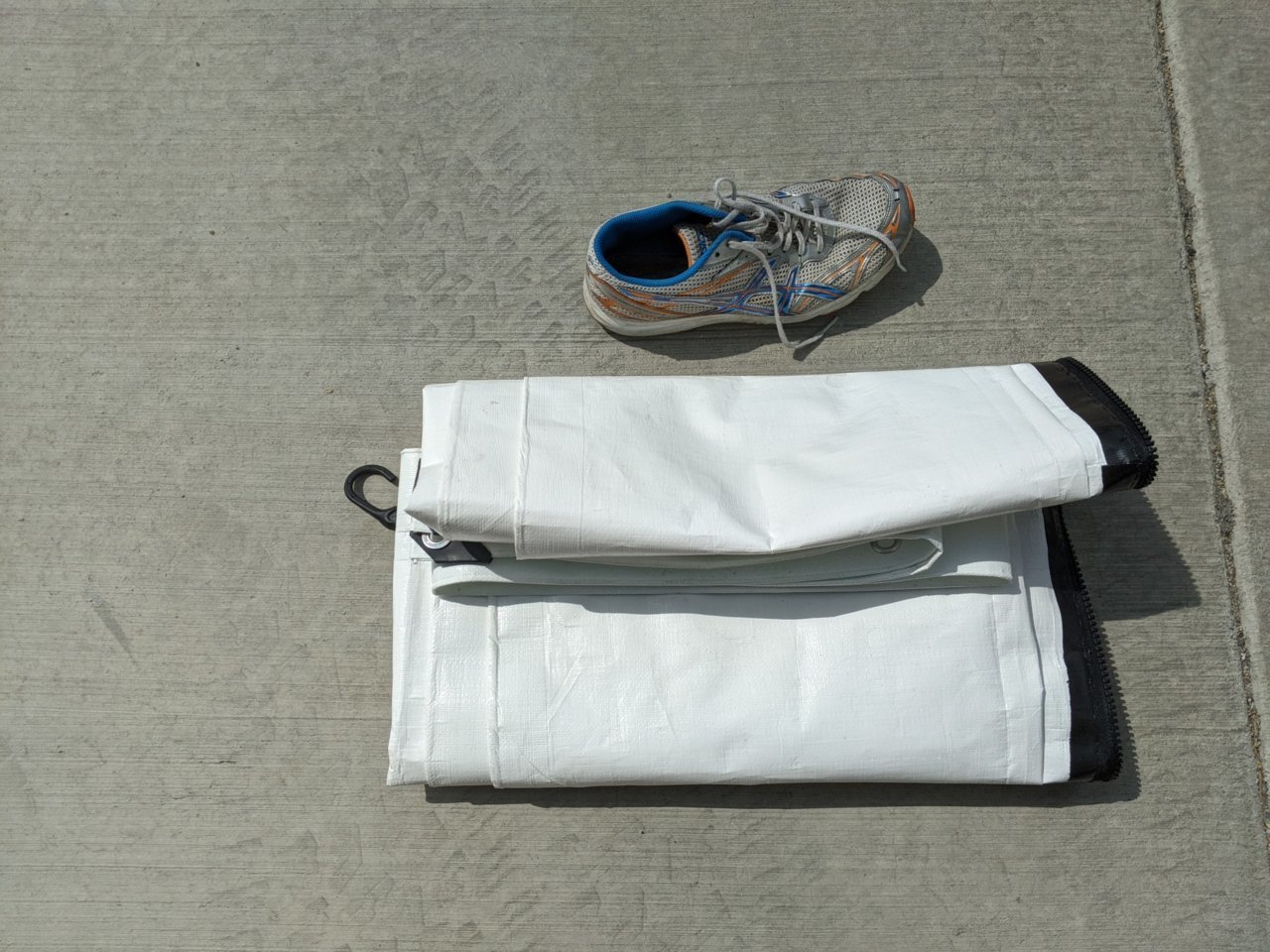

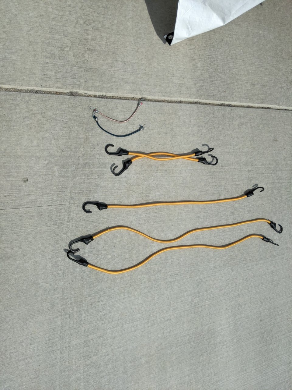

    bungees needed (YMMV, this is the setup that worked for me)

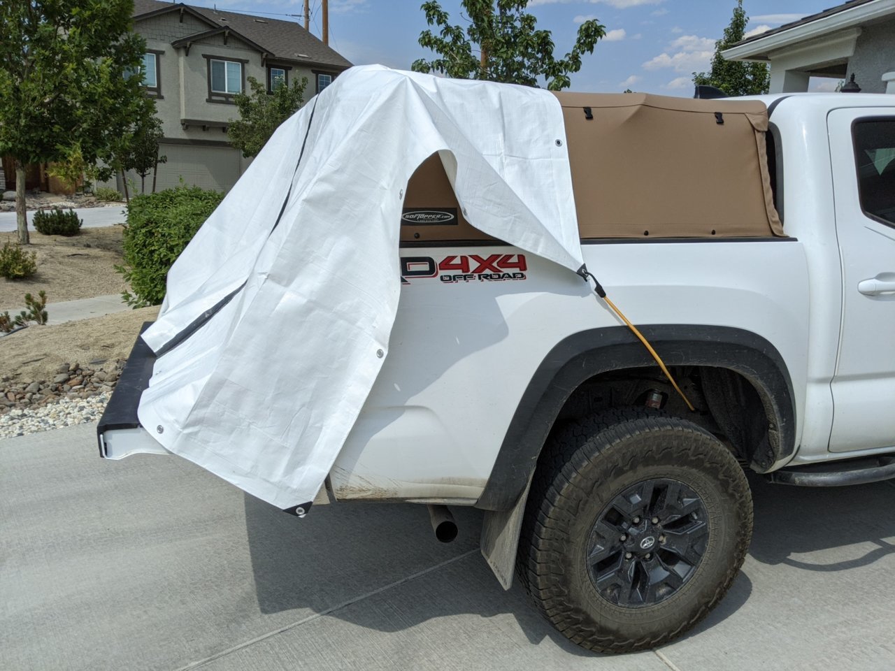

    ready for , eh, pitching

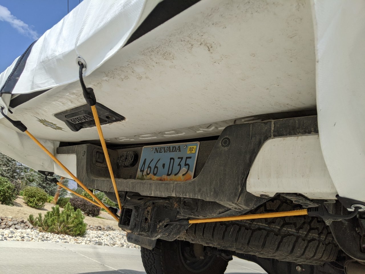

    draped and secured to the wheel well (It's super easy to set up in wind, much easier than a tent)
    sides made mosquito proof. Not sure it would work in Alaska; it did in the Sierras next to a lake.
    secured underneath the tailgate - there's probably 27 ways to skin that cat. Just make sure it wraps around.

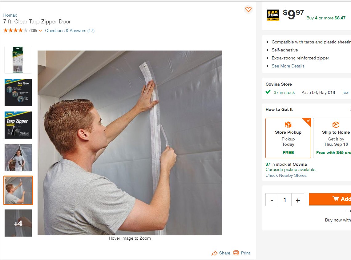

    Nice. You could've probably used one of these zippers too:

    I looked into that.
    2 problems:
    - zipper is way too long. It has to be around 4', or it wraps around the top bar so you won't be able to close it. Can't cut a zipper to size...
    - zipper is crap. You do want a high quality one.
    I need to clarify: I got a zipper that is used for boat tarps. It's waaaay strong. I secured that to the tarp (a grommeted one, kind of obvious) with gorilla tape. I stitched through that because the tape will slip when it gets hot. I put additional tape on top of the places that looked iffy.

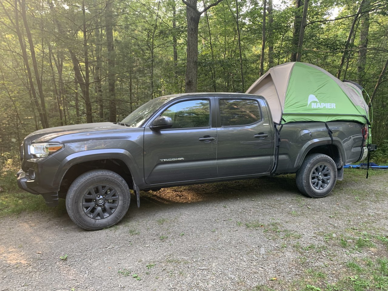

    Looks like it will work. I bought a cheap tent from Napier. I like it because it has a fly and it has a floor in it. Probably not going to last for years but it is what it is for $150.64883075360__8AA36EB3-0672-4401-BC42-87C900ABB549.jpg IMG_5202 (1).jpg

    Pretty good, Backdoc, but it wouldn't work for me because I do need the topper on most times.
    I usually got a lot of stuff in the back that needs to be be dust protected and dust is a way of life where I live. Also, it would not have protected us from the totally unplanned for storm the way the Softopper did.
    But yeah, it was a consideration. Believe me, I do not build when I can buy.
