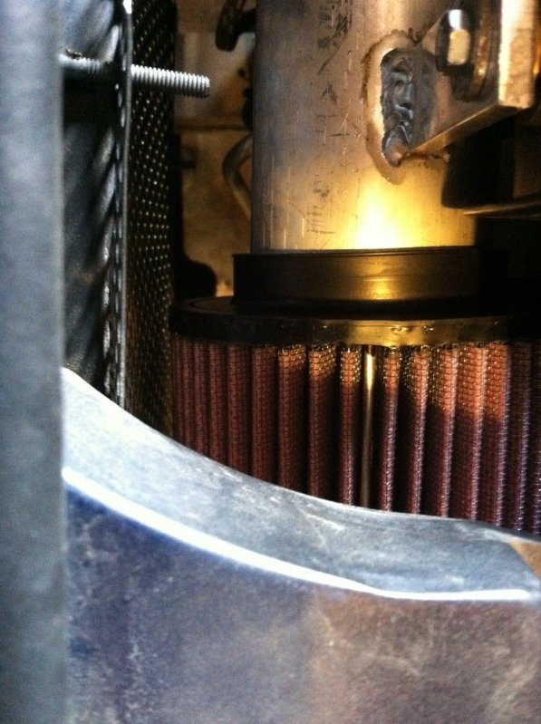

    Preparing thread for pics... I'll have $150 into it before paint. It's pretty boys!
    Some teasers.
    Materials used:
    2-3'' 90deg 16ga Aluminum mandrel bends $42.70
    1- 3/8'' aluminum bung $ 5.00
    1- 3/8'' to 1/2'' nipple fitting $ 5.82
    1- 6mm bolt FREE
    2- 3'' silicone couplers w/ clamps $16.94
    1- K&N filter $38.20
    1- 1ft 1/4'' aluminum flatbar $ 7.57
    1- Denso MAF Flange $43.14
    ______
    Total $159.47
    Waiting on flange.
  2. Mar 1, 2013 at 2:17 PM
    dually
    dually [OP] Low and slow
    Jul 29, 2008
    #8205
    3,299
    Interstate underpass
    '16 Inferno SR5 DCLB
    Saved for more pics.

    Thanks. Its pretty much a rip off of the URD system, but what I feel is better fitment. I ordered the Denso MAF flange from Treadstone today, so it shouldnt be long before its completely welded up.

    Stoked man! Any sound change? And where or how did u decide on the width of the intake tube?

    Havent ran it on the truck, as it is still lacking the MAF. 3" is pretty standard for intake tubes, and the current housing for the MAF is 3".

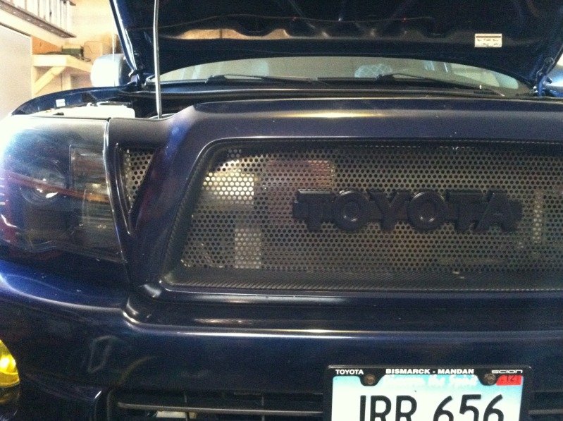

    With filter

    Nice. I was thinking of doing the same thing, but ended up buying the URD one because i barley weld and didn't want to chance it.

    great idea and it looks cool....... but that is wide open to all the water spray while driving in the rain...... how can you prevent it sucking water in to the engine? just an observation.

    Water will evaporate in the tube(if it makes it that far) before it even touches the throttlebody.
