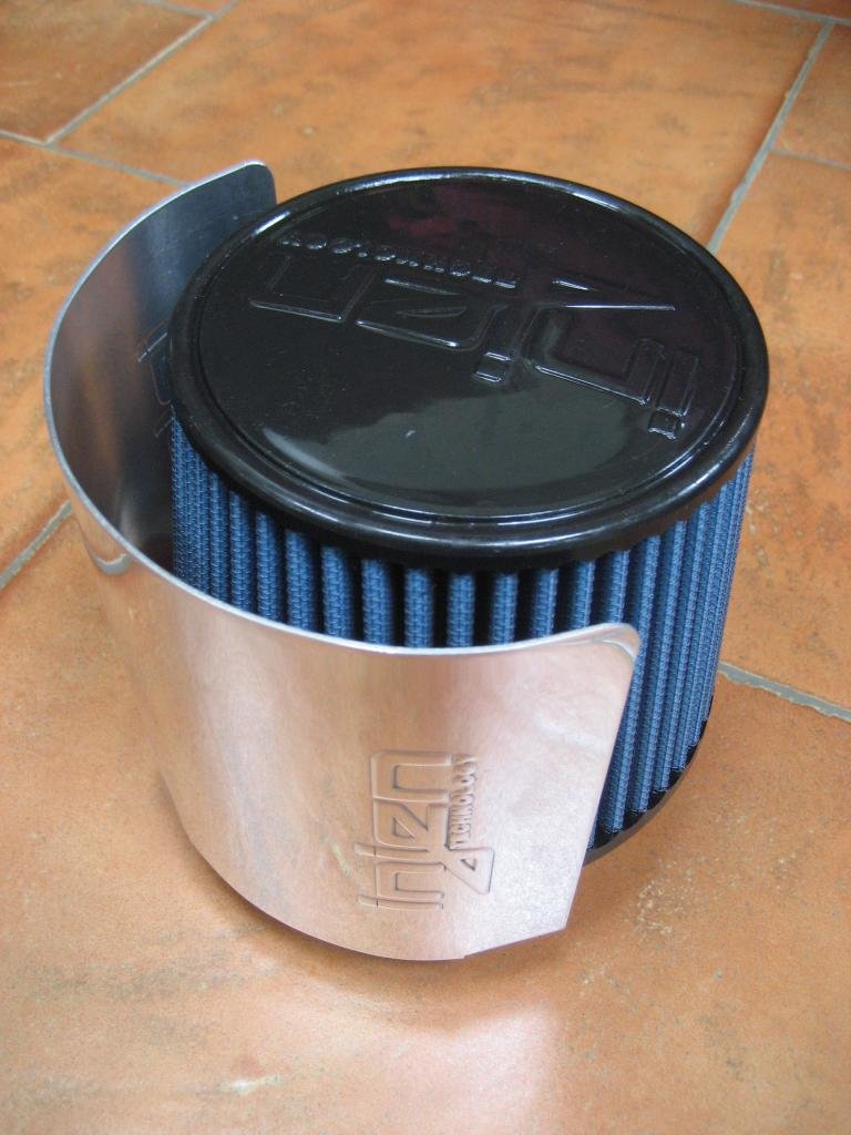

    Hey dually, :)
    I admire your creativity to actually build your own intake.
    The unsheltered filter being blasted by a particulate airstream has a very simple solution. It would be very easy to fabricate a simple guard like this one to keep particles from directly impacting your filter medium.
