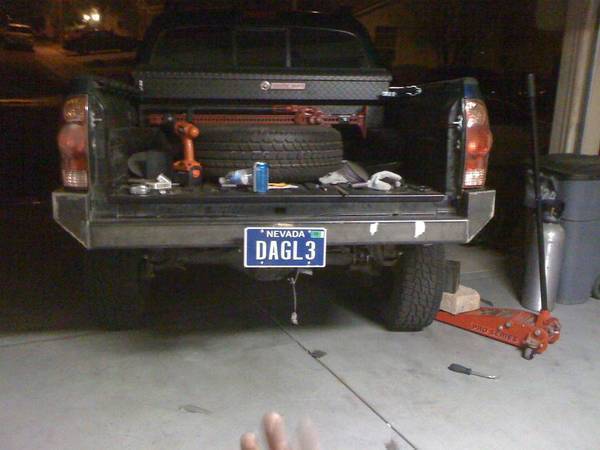

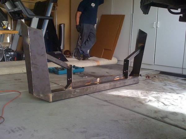

    (oops thats where my chisel went, i was using it to move the bumper down to line up the wholes haha...)
    its pretty much just 1/4" plate welded to the 4x4 main tube then i made gussets out of 2x2 square tube and theres also 1/4" plate welded along the backside of the bumper from one mount to the other side. and 2x2 square tube to support the wrap around plate.

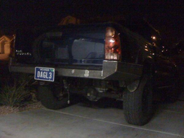

    finally got time to fully weld everything and install the hitch mount and license plate holder on the hitch mount. now the fun times begin... grinding, sanding and smoothing everything out.....

    i plan and hope to finish smoothing it out tomorrow but im still waiting on my shackle mounts to come in so we can weld it on then i dont know yet if im gonna powder coat it or paint, depends on what kind of hook up i can get on powder coat.

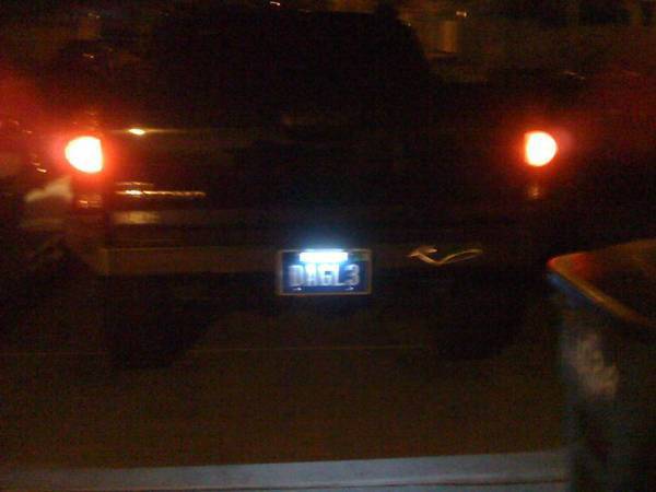

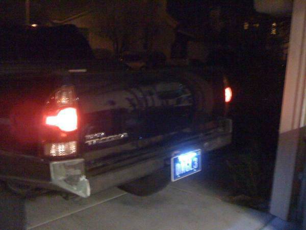

    07 dc 4x4 v6
    put the girl friend to work today!!!
    installed some LED license plate lights, that way i can drive at night without getting pulled over.

    What is the thickness of that square 4"x4" tube in the rear?
  18. Mar 17, 2011 at 12:03 AM
    #38
    DonnoD
    DonnoD [OP] Well-Known Member
    Jun 6, 2010
    #38459
    960
    don
    las vegas
    07 dc 4x4 v6
    1/4". everything is 1/4" except the top cap that runs below the taillight and bedside that's 3/16"
