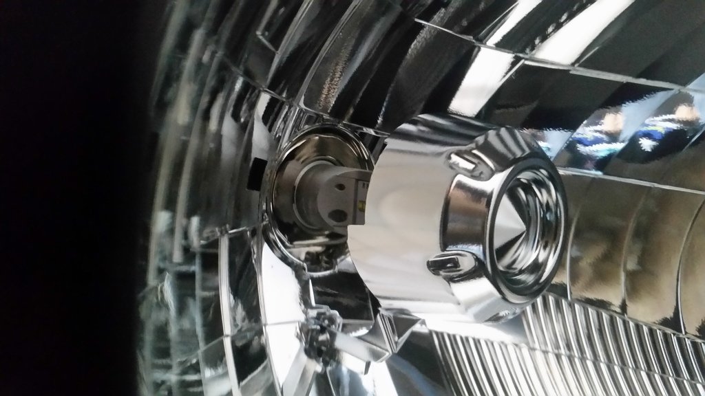

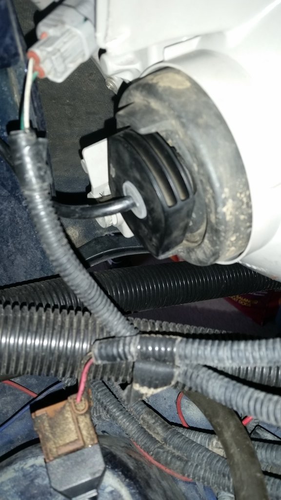

    The bulb install: Not as straight forward as I thought. The bulbs on initial install are a bit difficult to get secured. I was changing out my previous Torchstar LED bulbs for these and I must say the Torchstars held in there much better without having to modify anything. I ended up battling the headlight retainer spring for a good while to get a nice solid fit in there on both sides. For whatever reason, the passenger side decided to give me the most trouble. I ended up pulling the headlight assembly on the passenger side to get a nice secure, anti-wiggling (if that's even a word) fit in there. Not all assemblies are built the same, but when and if you upgrade to these, make sure you get a nice secure fit while you are installing the bulbs. My headlight assemblies see a lot of rough roads, so I wanted to make sure they were as tight in there as possible. Plan on having to tweak and bend the retainers to get a better fit in there. You may have to pull your headlights to be able to work on them better. Even after loosening up and moving my windshield washer reservoir out of the way, it was still not enough for what I needed to do. So be warned. After installing the bulbs themselves and securing the springs, you install the rubber grommet back on, which installs very nice and easy. Following that you screw on the aluminum heatsink's supplied and continuing screwing on until it's tight. Done.

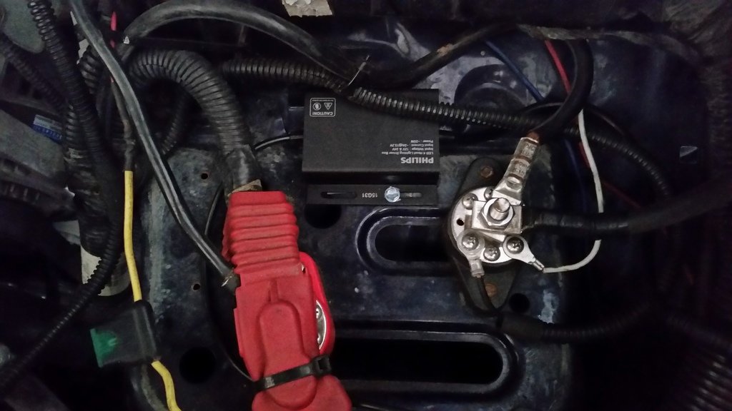

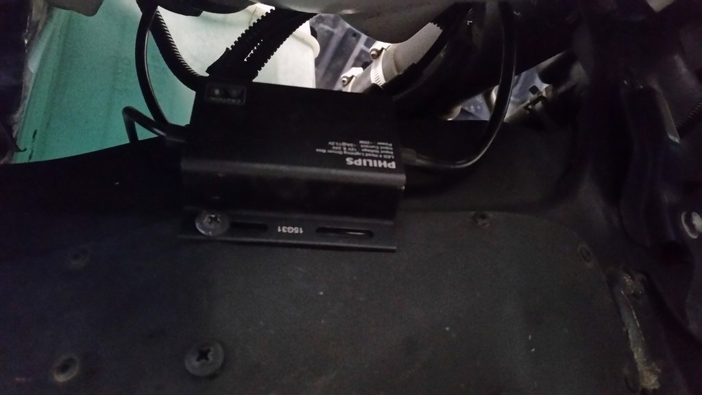

    The ballasts: This part was not all that bad. It was more finding a location as to where I could essentially bolt them up. I did not have any remaining double sided tape and the old tape adhesive that was on there was needless to say all used up. So I saw it more as a cushion at this point against the metal and to mildly protect from vibration. I relocated my battery a while back so the battery tray area under was a perfect candidate for the drivers side. It bolted up nicely right behind and in between the two access terminals for the battery. I ran one small self tapper through the metal. Nice and secure. The passenger side was a bit more of a challenge, I wasn't wanting to enlarge the ballast slots for running a bolt through too much on the ballasts so utilizing any current bolt up location was somewhat out of the question. I recently had the radiator support bulkhead area (the wings which extend out from the cab mount bushing area to the fenders) worked on and strengthened a bit. So there were already small rivets and bolts in place. Luckily there was a bolt right under where the headlight mounts up to on the support, so I removed one of the self tappers out, installed the ballast and rebolted it up. Nice and secure as well. Two plugs is all it took to get the headlights running, one for the main harness from the truck and one for the new headlight itself. Waterproof seals.
    Driver side ballast:
    Passenger side:
    Installed with heatsink on, ready to fire up:

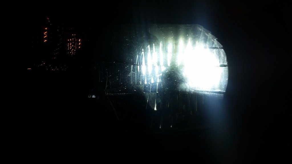

    Impressions: Initially, I fired up the headlights and as usual, instant on just how I like it. Cool. After installing one, the other side still had the old light in and I was able to notice a very distinct cutoff difference between the Phillips one and the old one. It was very distinct coming from the Phillips side. It also appeared noticeably brighter. Though it was daylight I was in my relatively dark garage so I could still notice a difference. Night time driving proved to make these truly shine. Driving around, they appeared much MUCH brighter over the old ones and that distinct cutoff made them appear close to how driving around with Xenon retrofits with their respective angel eye headlights looked like. I really enjoy it. The high beams are really good as well and get a great amount of coverage when selected. I think the lows are so strong now that I actually GAINED coverage in useable light and overall throwout over my old headlights, yes Halogen is included in that small list as well. The advantage to these over all the other aftermarkets is that they have a small built in reflector right on the LED chips just like Halogen's do which allows for a correct cutoff and not such a scatter of light like all of these other brand's. It is built by Phillips also, and by running these over other's, you know you are going to get quality LED chips and a build. None of this made in China stuff.
    The only small caveat to all of this which I have noticed is when cranking up the truck and the headlights are already on (that auto mode that we have) there is a noticeable flicker from the lights. I am not entirely sure if I should be worried or not for the ballast's as these lights have a much decreased amperage consumption over Halogen's and definitely Xenon's.

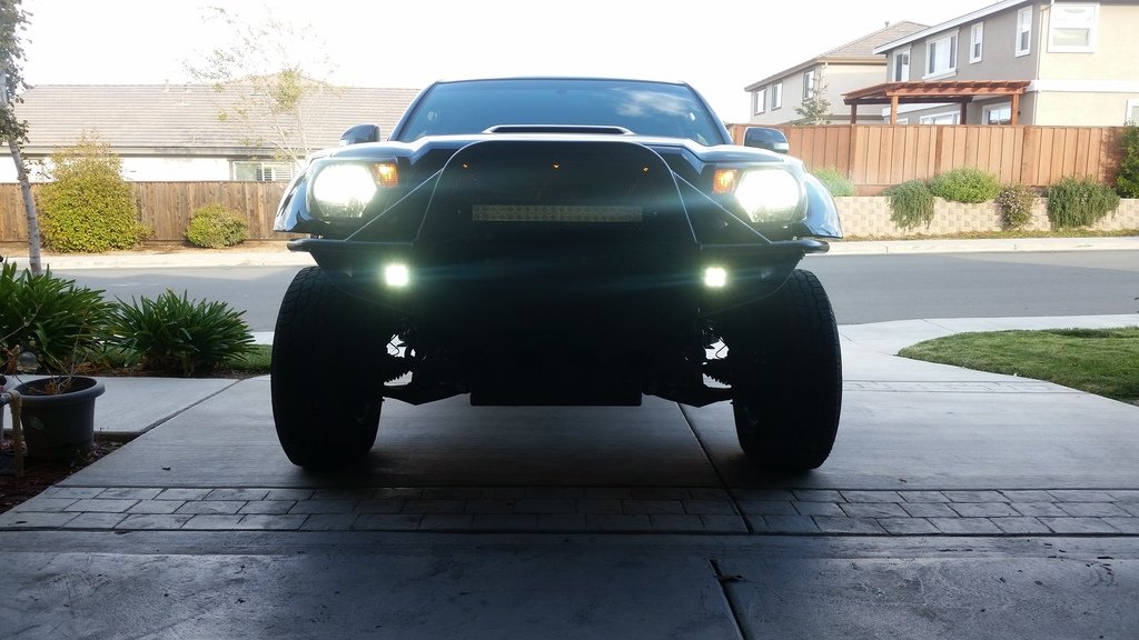

    Installed:

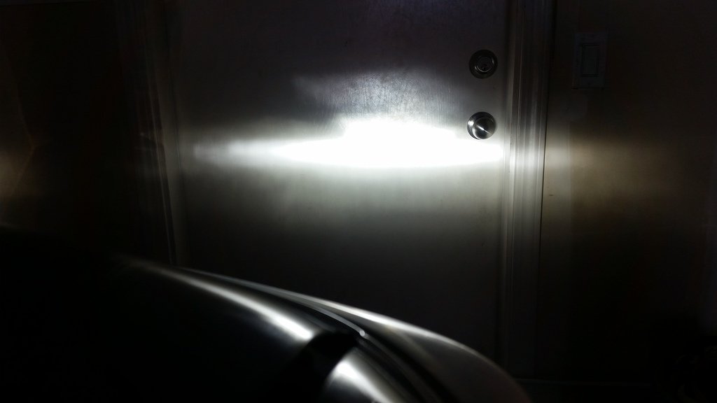

    Cutoff on wall from 2-3 feet away:
    Overall: After logging several hundred miles of driving on these over my old ones (some 68 miles at around 12am with no noticeable eye fatigue) I am very happy with the outcome of my buy and If I had to, I would purchase these all over again. Even if I had to put my name on a waiting list or not. Well worth the price, and well worth the benefits. A small little added plus is that they ended up matching my LED pods color over the old ones. They definitely make me want to go for a drive on blacked out backroads now. They actually appear to be right on par with my center light bar which I have installed on the bumper after I tested them to see if they were or weren't as bright as the bar which I definitely wasn't expecting. I am never going back to anything else after these. More pictures available on request. Happy driving!

    You have any pics showing cut off from 20-25ft away? 2-3ft doesn't give very good perspective.

    I do not at the moment but I can get them for you here very shortly. Even from much further away the cutoff due to that integrated reflector they have on the bulbs make them very crisp on the road. Luckily it is getting dark out here in California, so I can get you a better idea here in a bit.

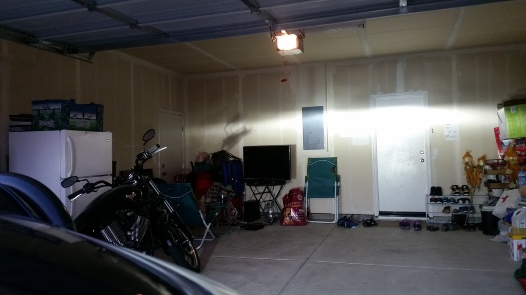

    Okay. This is the best I can do right now given it is still sundown. Keep in mind my driveway is sloped, hence why the lights are aiming so high, but I hope this helps.
    25+ feet away from the wall. Still very defined.
