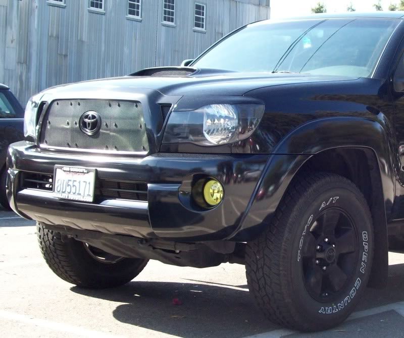

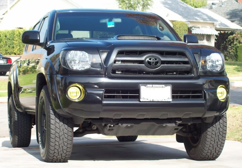

    Hey guys, within the next 2 months im gonna be doing different intake temp testings with the scangauge II, the first test is with the K&N... one with the lund screen front grille on, and the other with just the stock grille...
    TEST 1
    Temperature outside 64 deg
    - K&N CAI with LUND screen front grille
    Red light- 96 deg
    Residential- 89 deg
    35 mph- 85 deg
    65 mph- 69 deg
    TEST 2
    Temp. 64 deg
    - K&N CAI with STOCK grille
    Red light- 91 deg
    Residential- 82 deg
    35 mph- 78 deg
    65 mph- 67 deg
    * The Results clearly show that the LUND Screen Grille didn't flow nearly as well as the stock grille.

    Do you have a picture of the grill your testing?
  12. Dec 3, 2008 at 4:41 PM
    tacoskim
    tacoskim [OP] Tuned By Gadget
    Mar 13, 2008
    #5252
    2,384
    Los Angeles, CA
    09 TRD 4x4 Pyrite Mica
    Stock
    LUND Screen Front
    stock

    Oh snap! I didn't know that the Lund grill looked like that. man.. that just looks like a bad idea, lol. :eek:
    Now I could see a slight drop by changing over the stock grille. When you had first described it, I pictured it as more of a mesh type screen.
