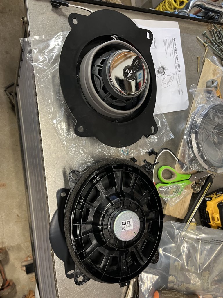

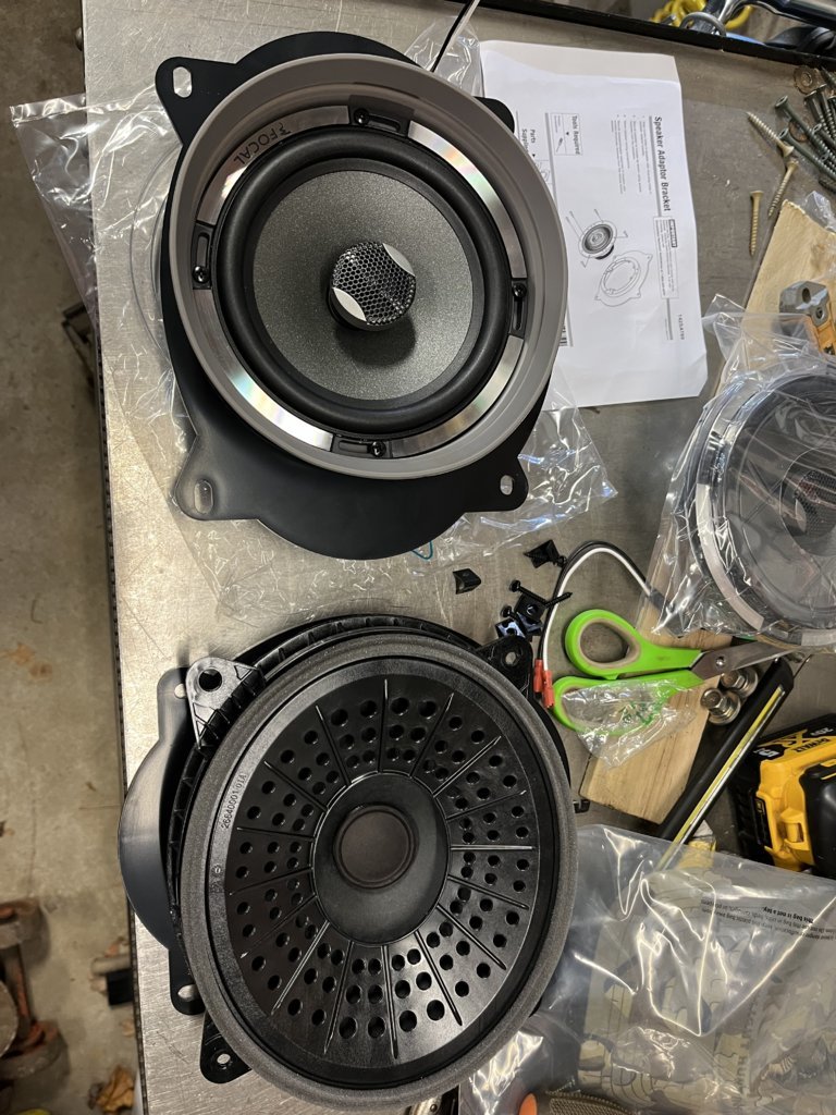

    This is the difference between my focals and the stock door speakers. Absolutely no comparison in the weight and the quality of the stock speakers compared with the focals

    Your speakers are ugly, I prefer my spaghetti strainer colander version of the stock oem....:rolleyes:

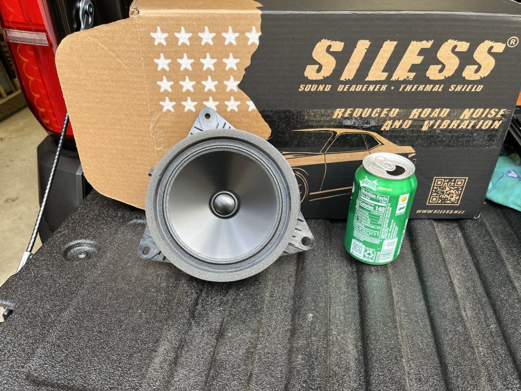

    The can of sprite weighed more than the rear door speakers

    Are they simple plug and play? Or do you need to do some trimming or mounting stuff?

    I got them from crutchfield and they include the speaker adapters to the doors and they also include the speaker wiring adapters.. very simple to install. While I had the door panels off I installed sound deadening to the door skins and the inner door panels to keep the vibrations to a minimum.just remember that when you swap out the stock 2 ohm speakers to new 4 ohm ones you will definitely need a larger amp to power them.
