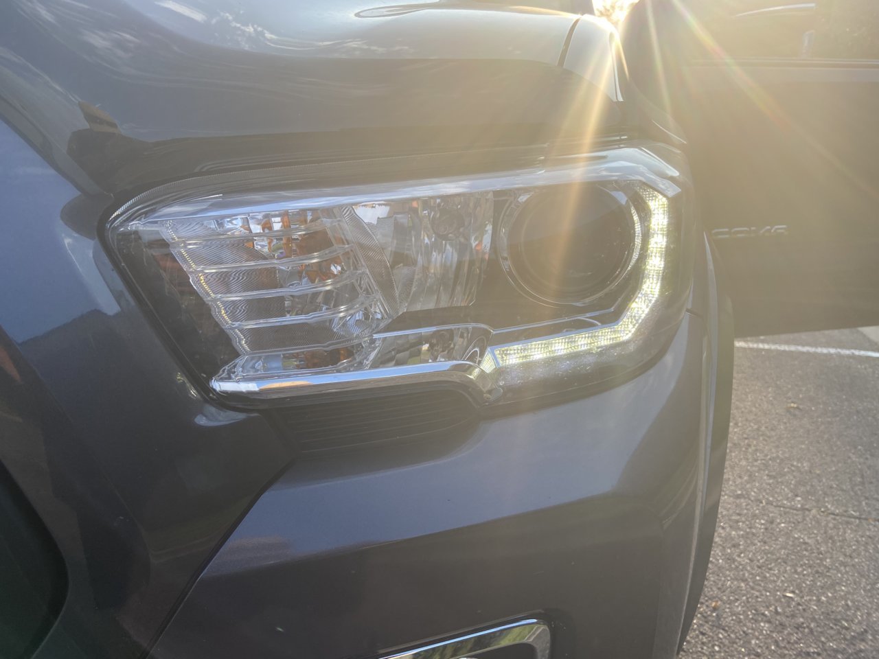

    Update. Problem solved. I pulled the Blue DRL relay in the engine bay (the small box next to the big box). All is right with the world.
    My truck is from CANADA. :canada::canada::canada:
    2016 limited. I’d like to be able to turn these LED DRL’s off when in the “O” position.
    Anyone have a mod for this?

    Yea that is the issue. It’s mandated by the government here that all vehicles have DRLs at all times, so we get no DRL off option.

    In Canada, drl is required to be on. In USA, it’s optional. If I’m wrong then I’m wrong.
