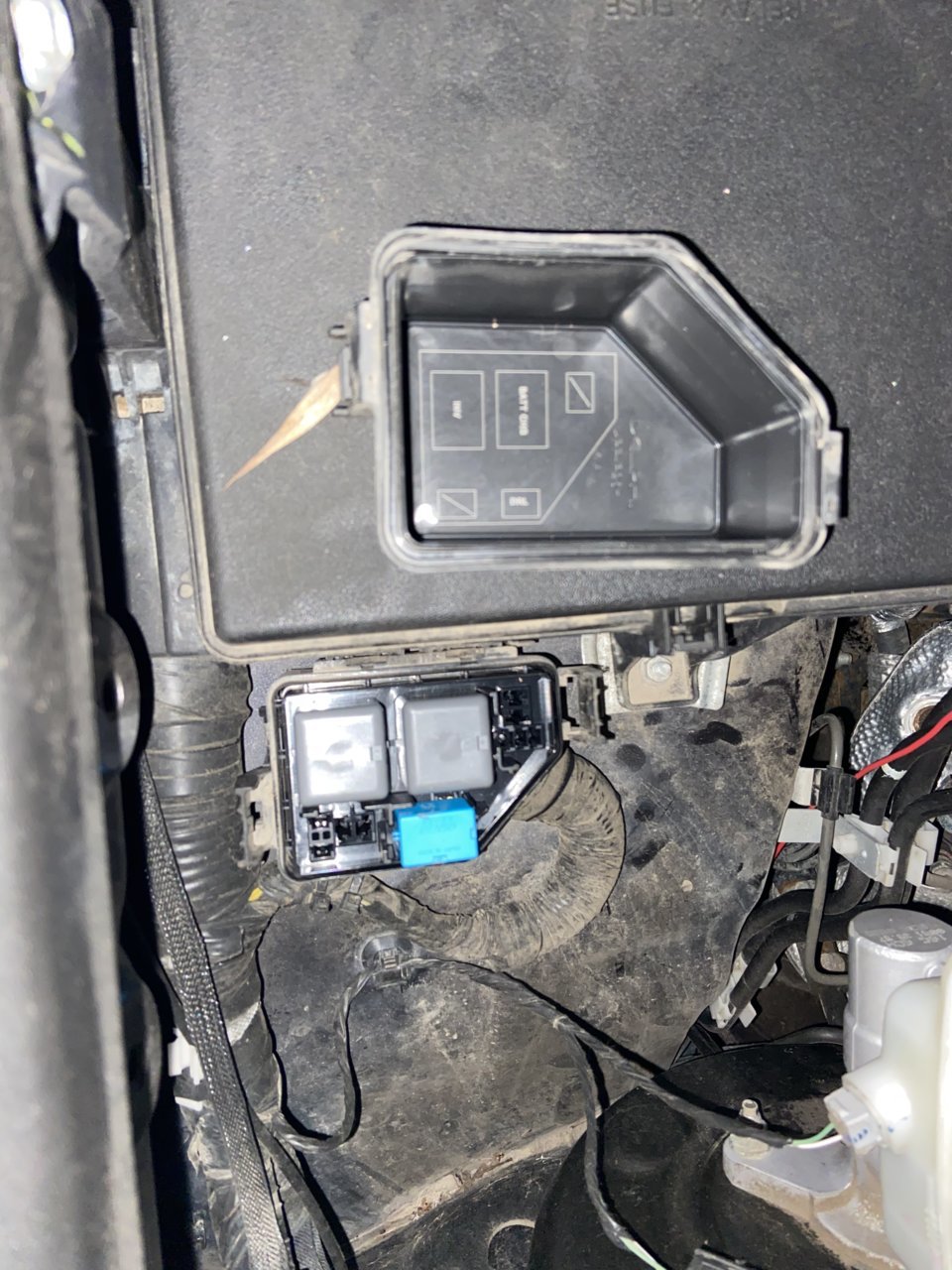

    "Fuel level low, please fill up. SORRY."

    The drl has its own plug. Unplug it and power it with the side marker lights which has a switch

    i didnt care for the DRL either, i just unplugged them.
    that way i can just run fogs only if i want.

    No i meant just use a t-clip and piggyback it. No fuse is neccesary because the side marker light already has a fuse and switch

    Solved my problem!
    All I did was pull this blue relay in the engine bay. O is off, Auto is Auto, the next click turns them back on along with the amber side markers, tail lights, and fogs if I want them on.
