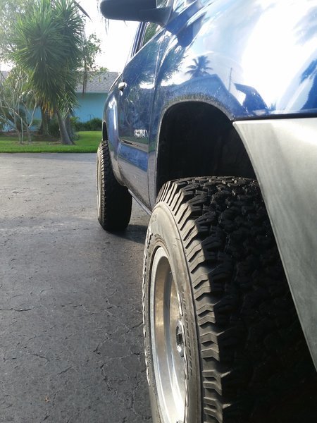

    Note: The surface is not flat. I realized this wayyyyyyyyy to late. I suggest looking at the gaps between the wheels and fenders.

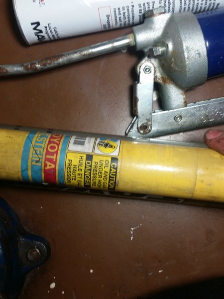

    TRD bilstein with no lift
    TRD Bilstein with aal

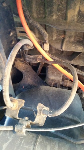

    Here is a look at my stock brake line length (longer ones are on the list)

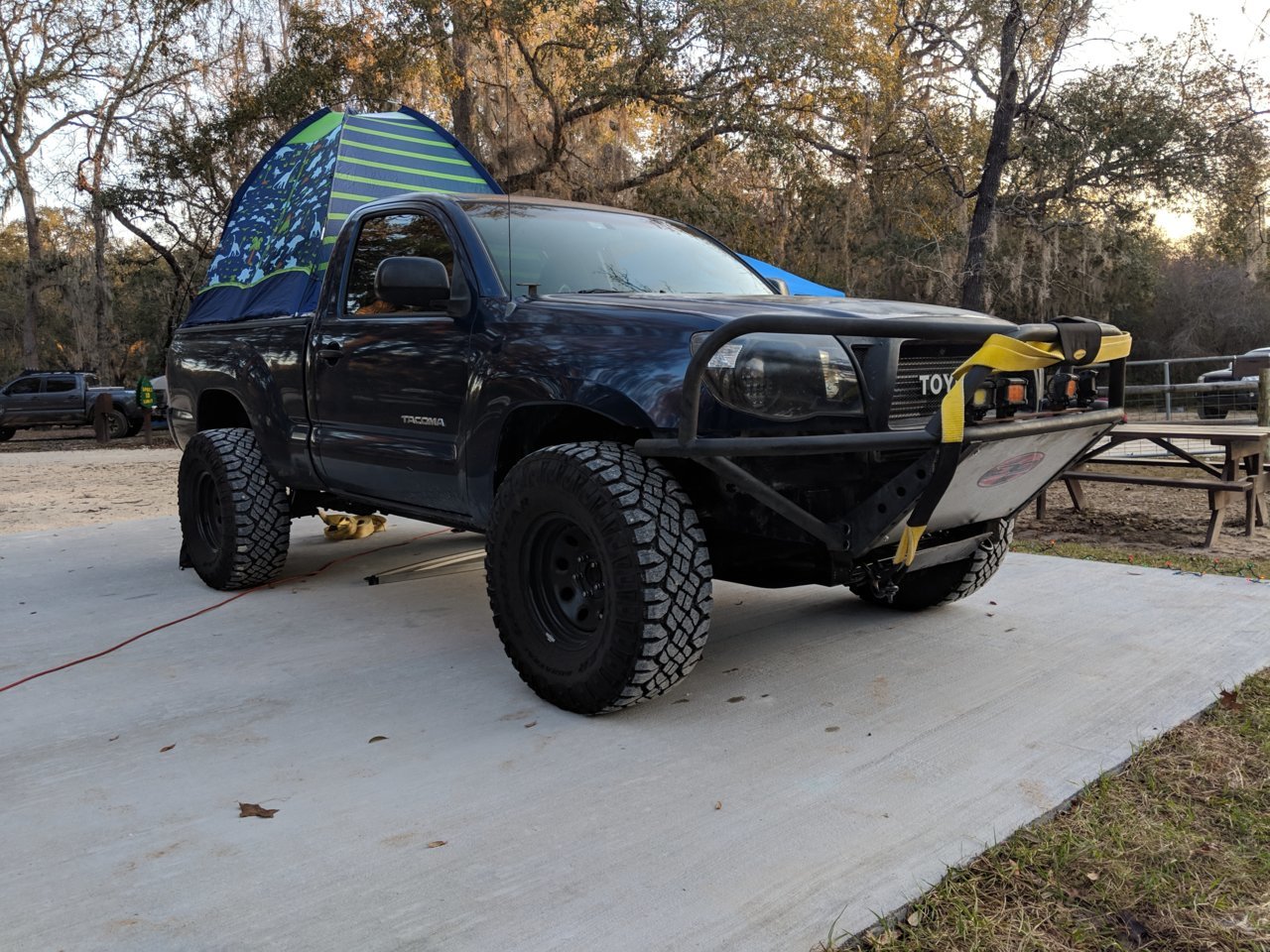

    So I here's how it sits currently
    The front is the same however I am a 6 lug in the rear. I used a 2016 leaf pack with the overload leaf removed. I have a 2007 trd off-road elocker axle. I have a driveshaft spacer to make up some extra space as well as some leaf spring clamps to help control the axle wrap spring overs have. My rims are now specific to the front and back. I had 5 lug adapter in the rear but they were a big hassle when I need to do a brake job and had to be cut off.
    Goodyear duratracs 33/12.r15 on cragar soft 8's 4in bs and -13mm offset. My Mickey Thompson's had to big of an offset at -44mm so the 33's rubbed

    The trd bilstiens are pretty easy to get and pretty cheap if you keep an eye out locally. I've gotten a set for $30 and another one for a case of beer. As for installation I got them in without jacking anything up because I was lazy.
    Now my fox shocks I just got I had to jack my truck up a lot and apply some persuasion. (I've been meaning to add this too )

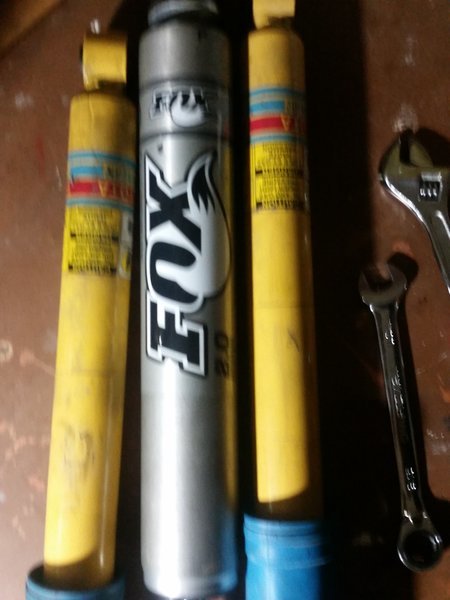

    Here's the shocks next to the trd bilstiens
    Here's the top view it's about an inch bigger

    I want to say stiff but that's not a proper way of explaining it. I have hardly anything body roll and when it moves down it only does it once. They were definitely worth it for the price I got them for. :D
