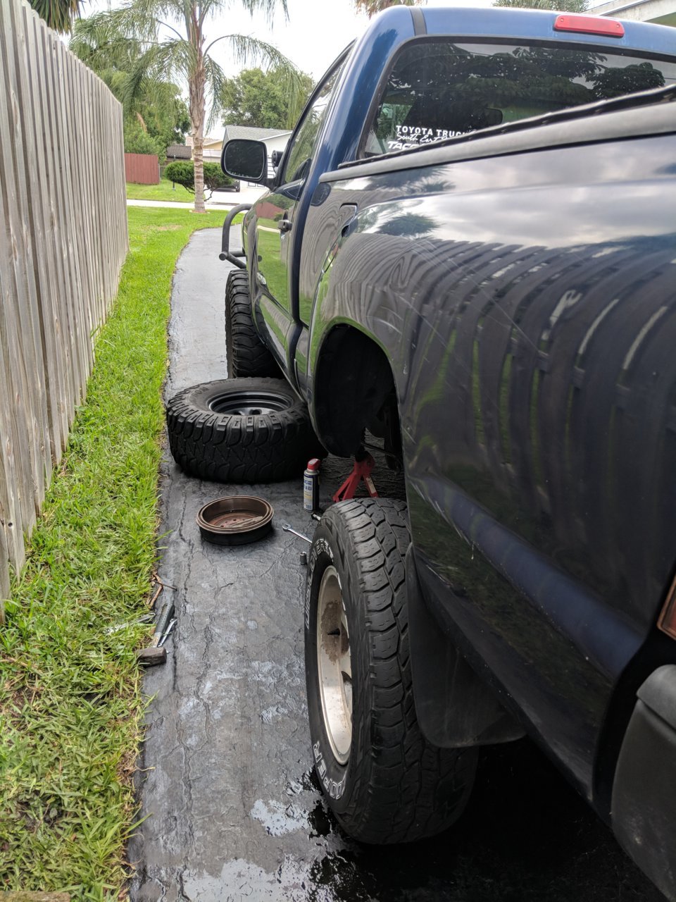

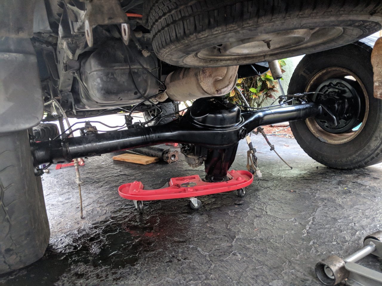

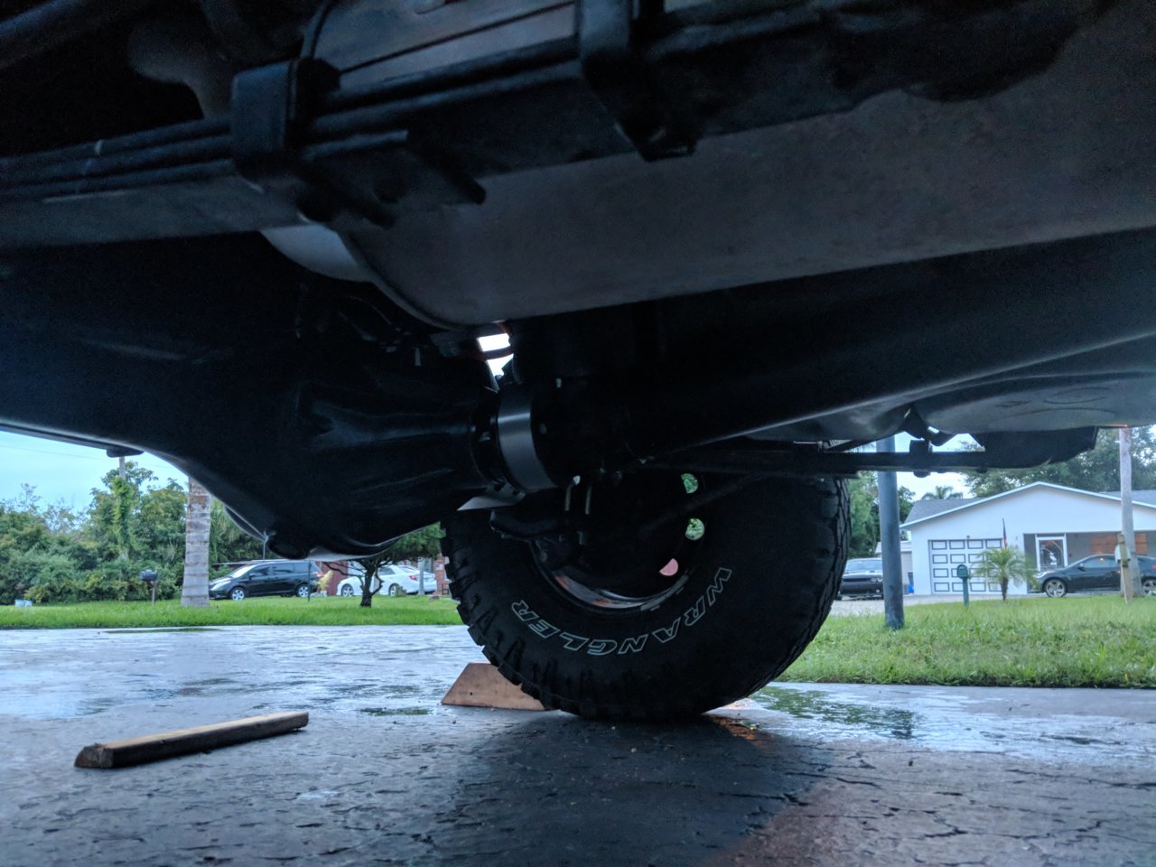

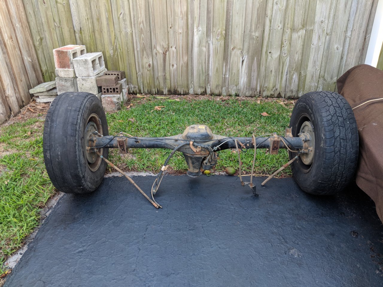

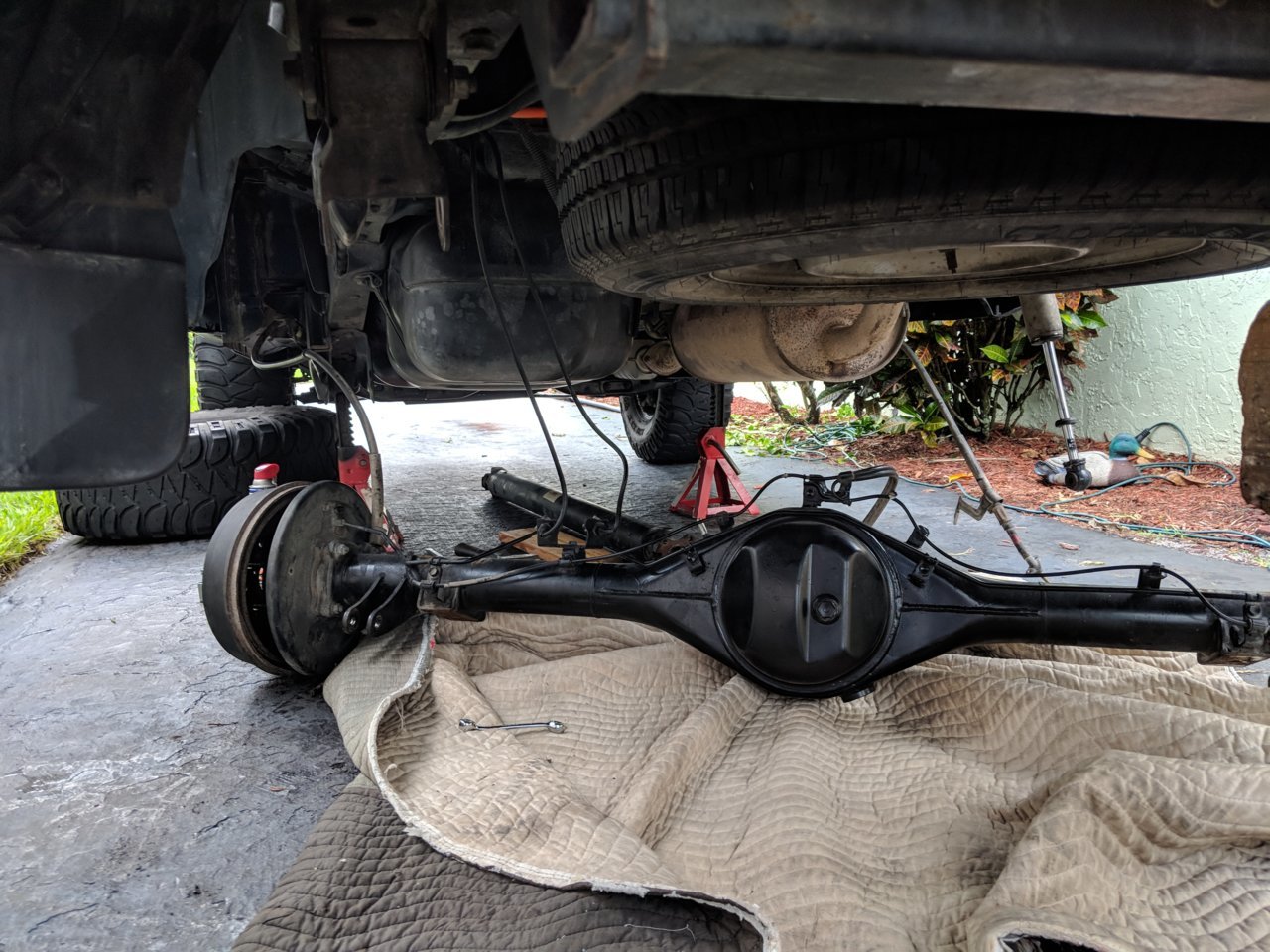

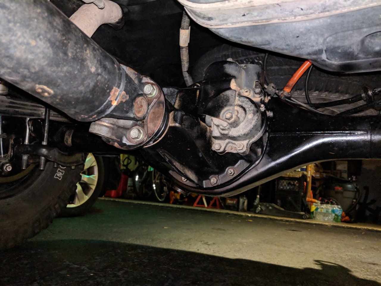

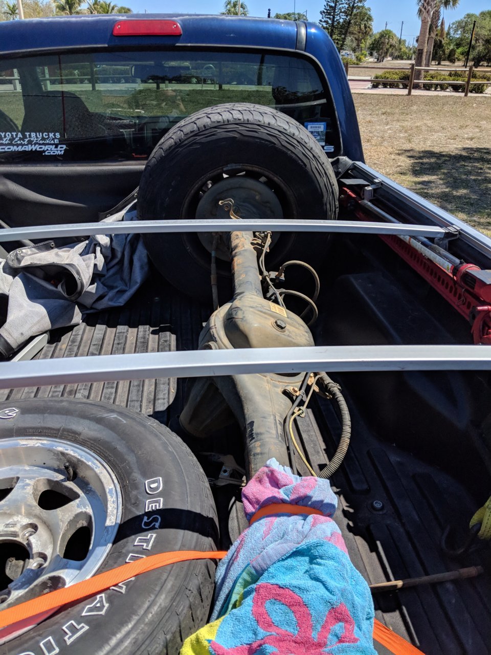

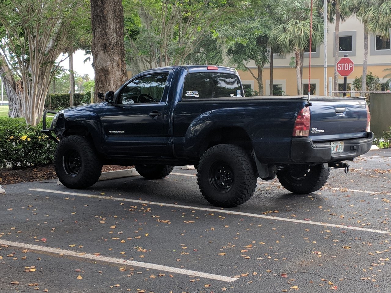

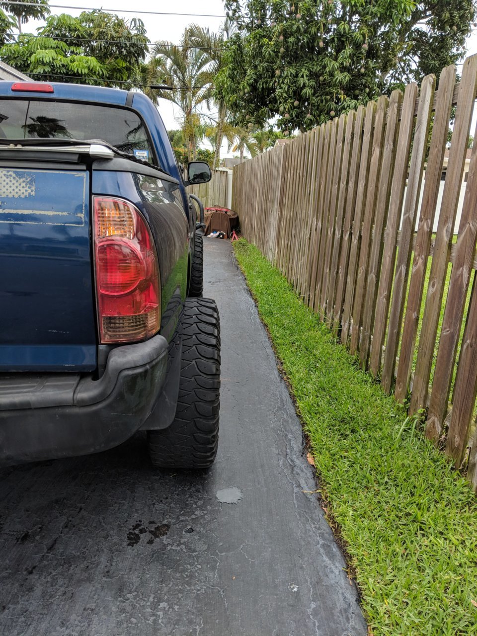

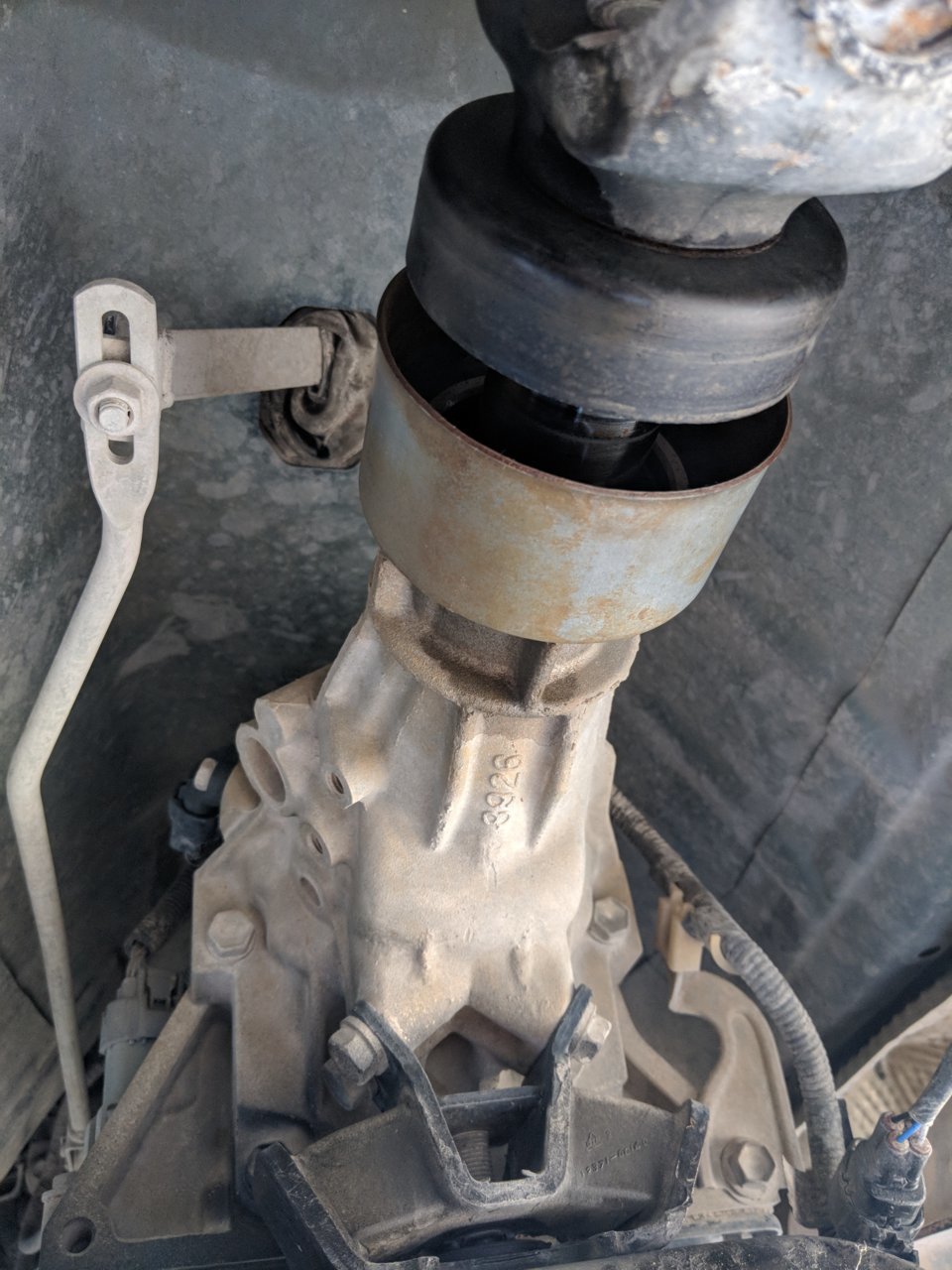

    And now the ....6 lug elocker axle swap (With SOA Swap!!!)
    Problems:
    So right off the bat I want to note the problems I've run into. Now don't get me wrong I have no regrets doing this but there was definitely some hiccups along the way.

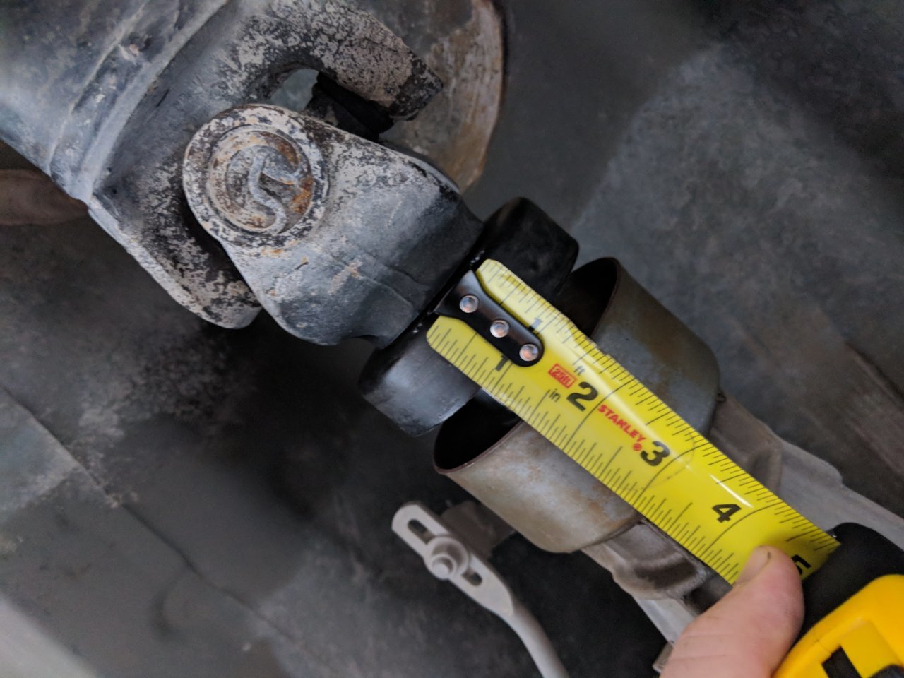

    First up the drive shaft was too short and required a 1.25" spacer
    The second issue which took the longest to dial in was the leaf springs and axle wrap. I used 6 lug leaf springs from a 2016 3rd gen and it turns out 3rd gen leaf springs are 1" taller than 2nd gen 6 lugs. This caused the rear end to be wayyyy to tall and stiff, so I removed the overload spring. Now that the height and stiffness seemed about right I had to fix the clunking when stopping and going caused by axle wrap. I ended up using 4 leaf spring clamps, but there is still an occasional clunk. Apparently this is just common with Toyota spring over axle leafs. With all that being said the rear end feels good its.
    I did also need an adapter to go from 6 lug back to 5 lug (for now) and this added an extra 2" in the rear
    Now for some random install pictures
    Getting the axle
    Out with the old (Look at dem extended brake lines lol)
    Rolling in the new
    And in this picture you can see how thick the rear is compared to the front (1.75" more)
    With new tires
