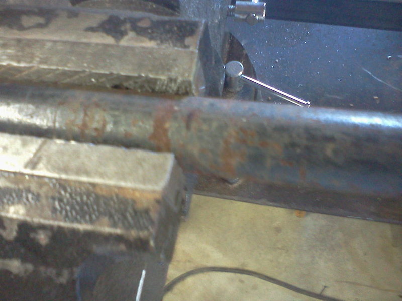

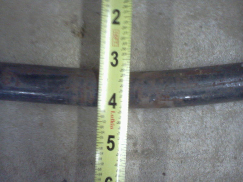

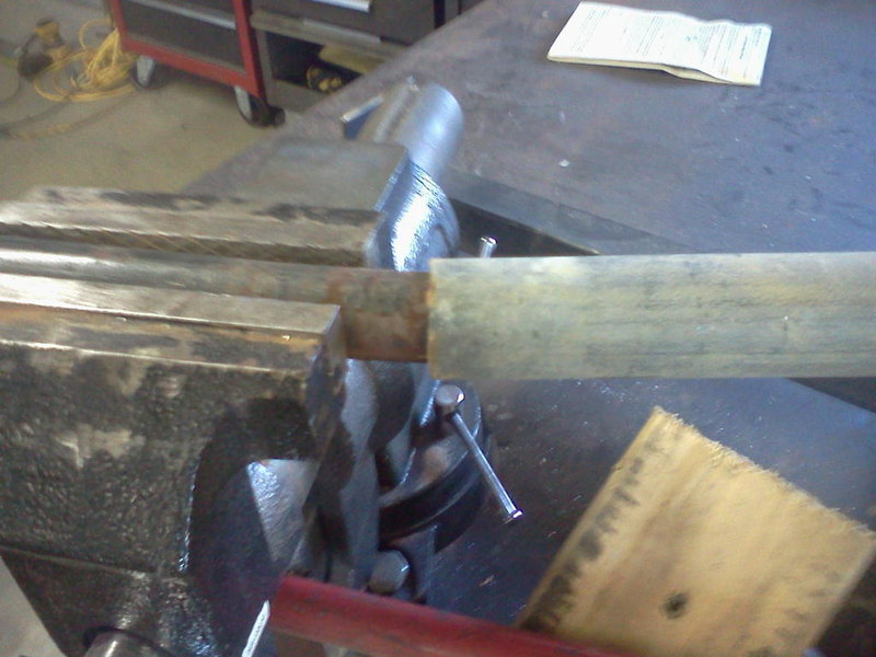

    well decided to build me a light bar. i used a old weight lifting bar. All it is its heavy duty piping to me haha. so ill show you the progress pics. the over all length of the bar is 59.5" long.So i measured between the th chrome parts oon the bumper and it was 27" between them. I marked that on the bar put it in the vice and bent there. I put a long pipe on there to get more leverage.Right now im working on tabs for the lights. Sorry in advance for the unorganized post.

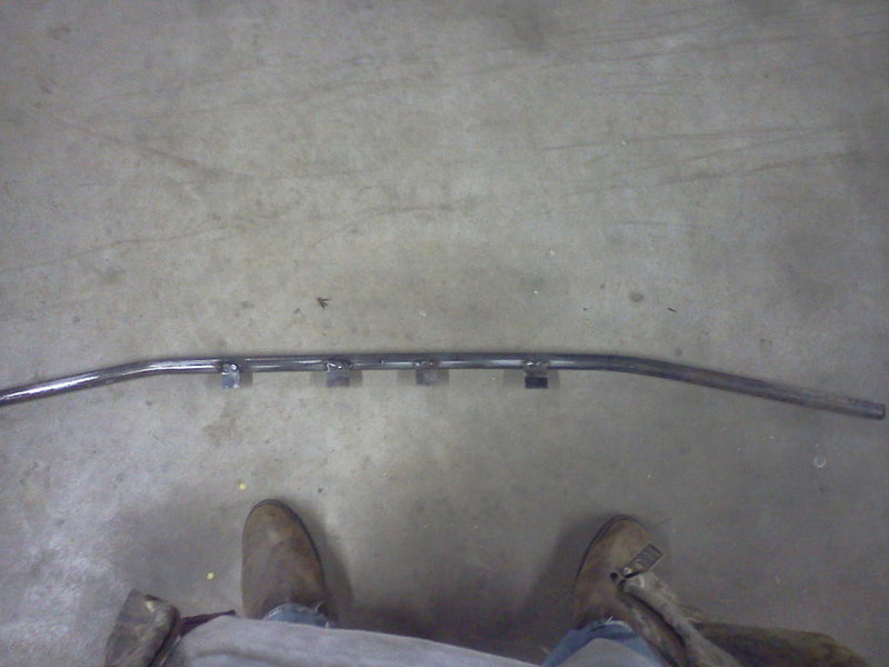

    got the light tabs on
