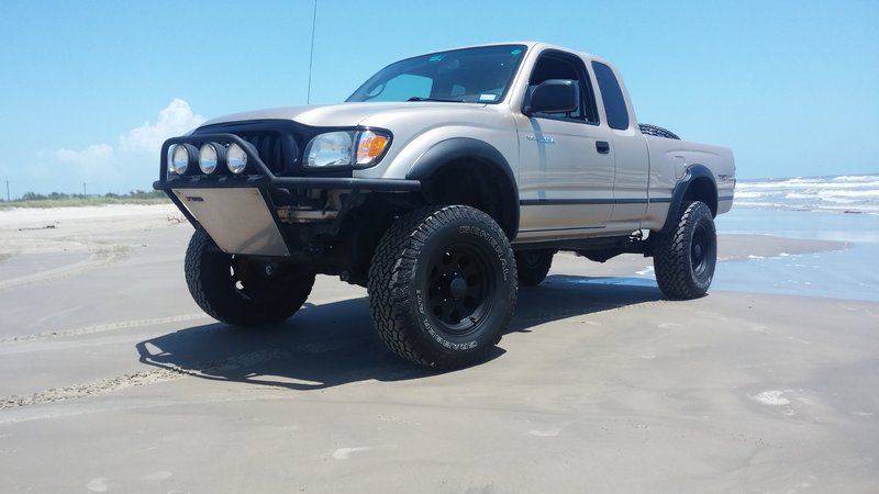

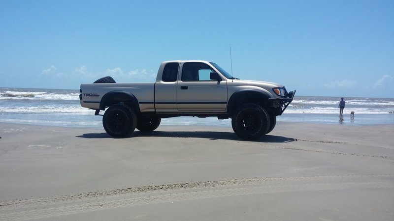

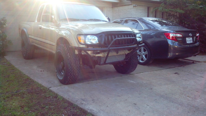

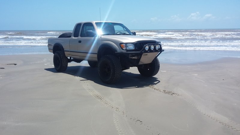

    2004 Tacoma Prerunner TRD offroad

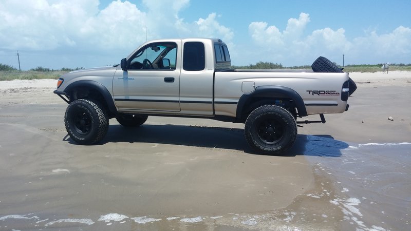

    2.5 lift , rear Bilsteins 5125 265/75r16 tires and aftermarket wheels Front tube bumper Airbox Decplate Mod Interior Bedliner floor MORE COMING!!!!
    2004 Tacoma Prerunner SR5 3.4l TRD 105k miles
    front: 3.5 Lift Bilstein 5100s + spacer and Light racing UCA on the way.
    rear: 2.8 Lift shackles with Bilstein 5125s
    tires/wheels: General Grabber at2 265/75/16, Ultra Pacer 16x8.

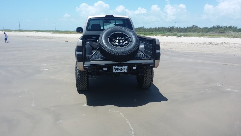

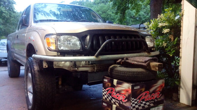

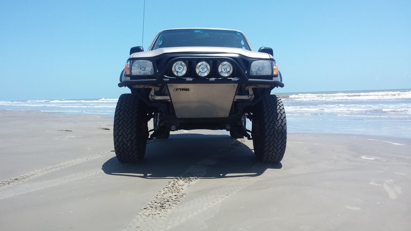

    Front Bumper: Baja style bumper made by me! aluminum skid plate.

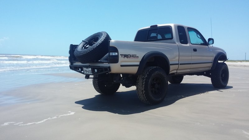

    Rear bumper: Baja style bumper made by me too and hidden hitch.
    Tire gate and 5th spare Ultra Pacer 16x8 wheel and cheap good used tire, lol. BTW, I made that one too.
    Lights: 55w HID headlights + 3 round fog lamps also 55w hid front, 2 18w led back up light + led inside and rear lights.
    removed interior carpet and painted the floor with bed liner due to a do a lot jet ski riding and i don't want a smelly carpet.It is super easy to clean , doing the same in my next truck.
    motor is stock except for Deck Plate Mod in the air box.

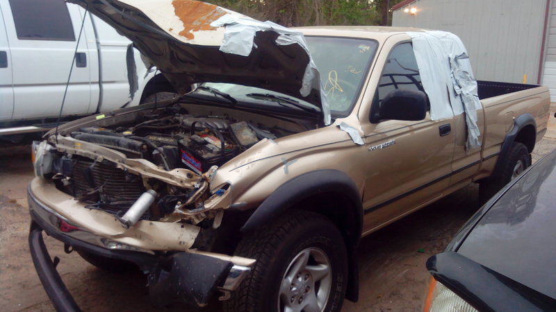

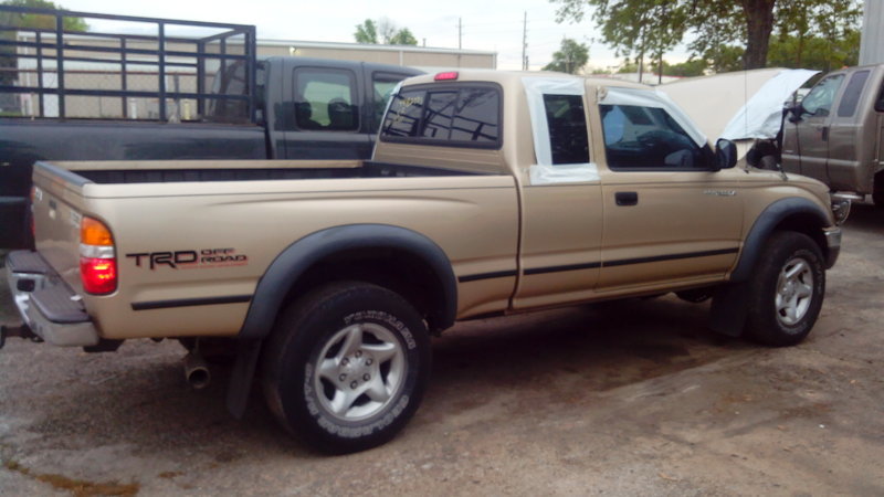

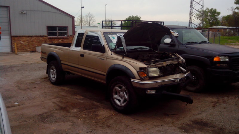

    I originally purchased this truck in a deal because it was hit at the front driver side, no frame damage. I was thinking about to make a full conversion to a long travel but other things came out and I ended with this build what I love and still working on it.
    Some pics when I bought it:
    IMG_20150326_185702.jpg IMG_20150326_185650.jpg IMG_20150326_185725.jpg IMG_20150421_080724.jpg IMG_20150421_080735.jpg
