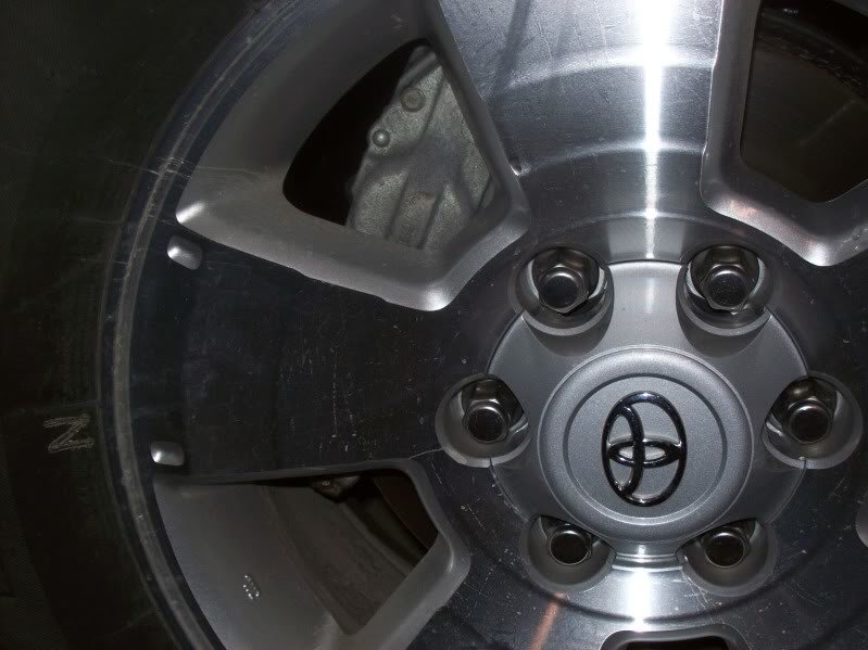

    For Reference: Bone Stock '09 TRD Sport w/ Towing Pkg

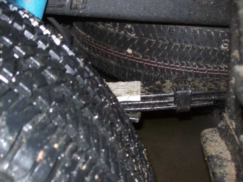

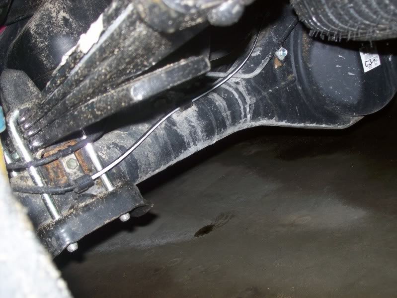

    Mod #1: Tranny and Rear Leaf TSB

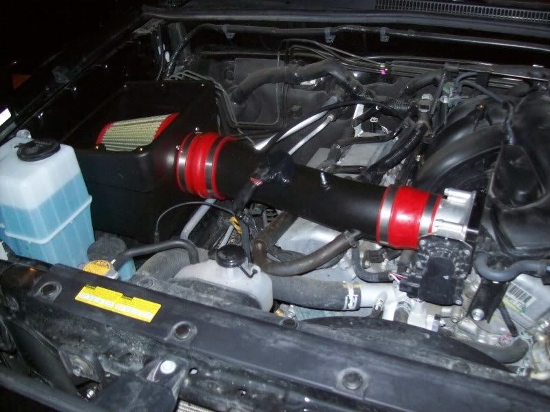

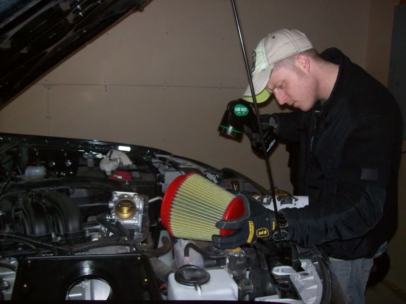

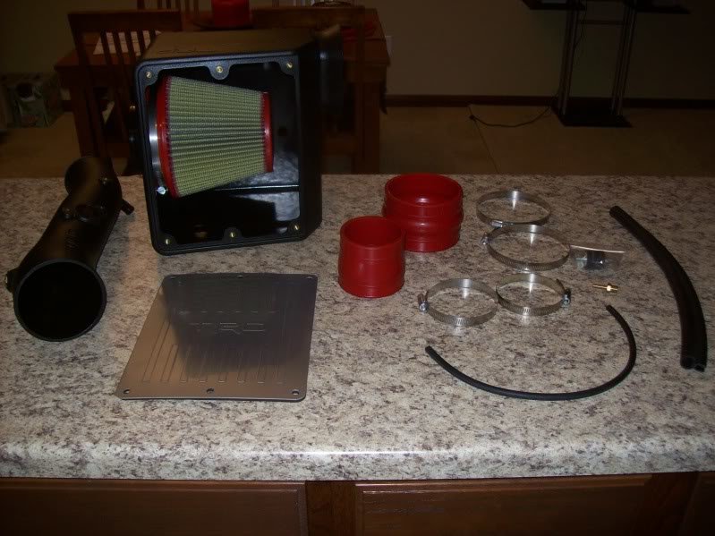

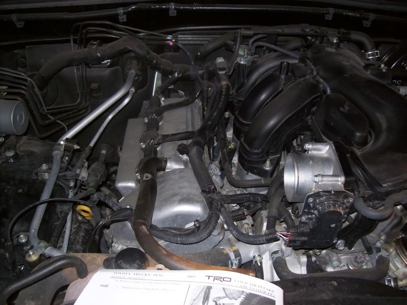

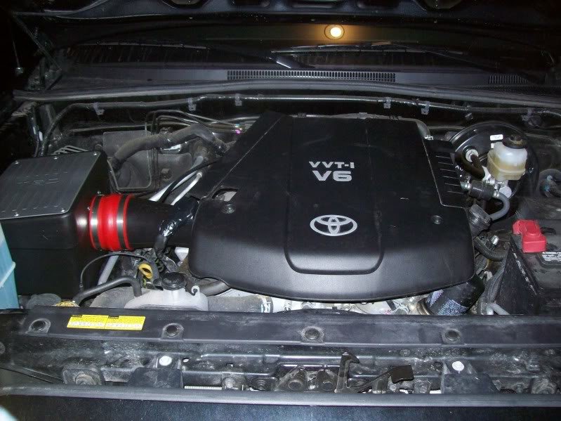

    Mod #2: TRD Cold Air Intake
    Truck passes "shake down" test.
    Celebration:

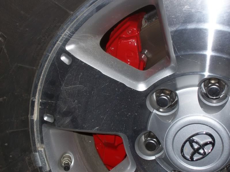

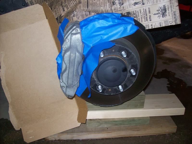

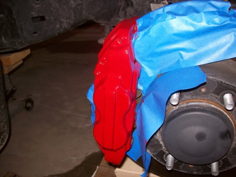

    Mod #3: Paint Calipers
    Take your time with this!! Be patient. I did 3 coats and waited the 24 hours before I drove it. The paint was glossy and smooth when I finished.

    Lookin solid. We will have to get together this summer and have a SE MN mod day. What are your impressions of the CAI thus far?
  10. Feb 9, 2010 at 2:56 PM
    Jon M
    Jon M [OP] Well-Known Member
    Jun 22, 2009
    #18781
    145
    SE Minnesota
    09 Tacoma SR5 TRD Sport w / Towing Pkg
    Thanks.
    I like the CAI. Haven't experienced (nor did I expect) some massive performance gain; but it's there. But when you get on the throttle, you definately know it's there! Wicked loud. But don't hear it at all under normal cruising conditions.
    I went out cruising around yesterday afternoon right during the heart of the "blizzard", didnt' get too crazy or anything but when I got back I took the cover off of the filter box thing and there was no water or snow or anything in there.

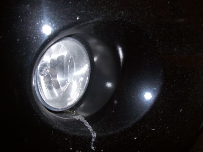

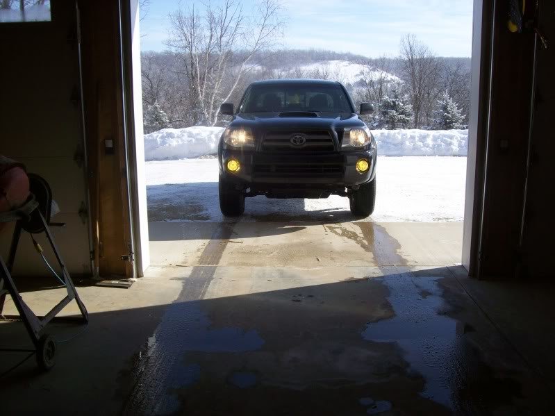

    Mod #4: Lamin-X Yellow Fogs
    Not all that unusual but I love the look.

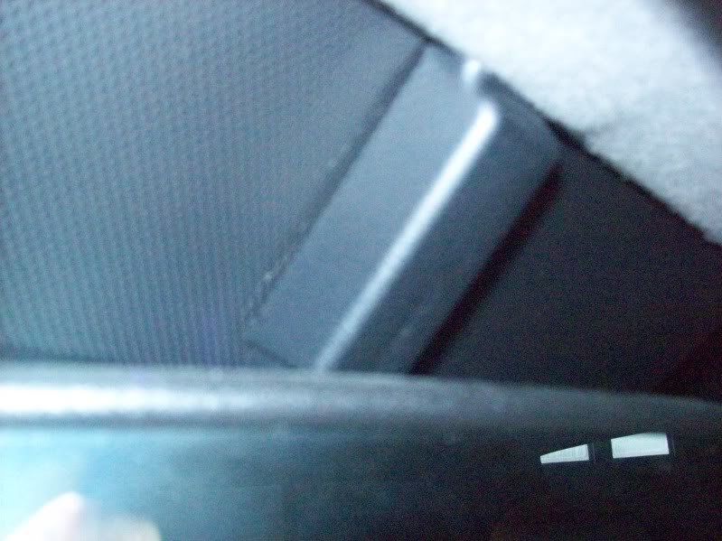

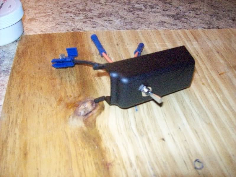

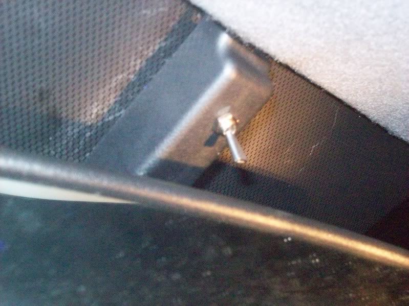

    Mod #5: Anytime Back-up Camera
    This was kind of a pain in the arse (for me anyway). So just a few pics; and then I'm going to finish my Bud Light. :D

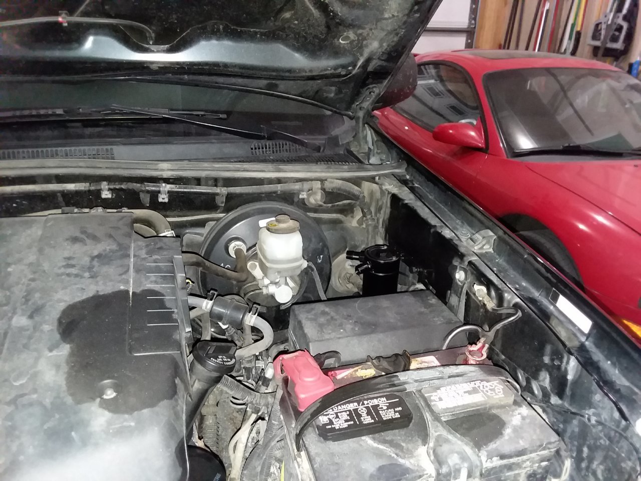

  17. Feb 12, 2020 at 9:37 AM
    #17
    Jon M
    Jun 22, 2009
    #18781
    145
    SE Minnesota

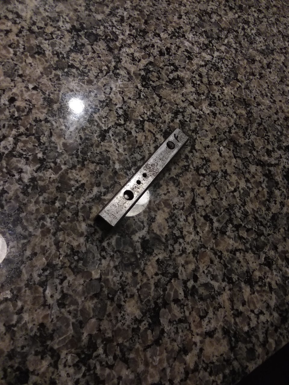

    Oil Catch Can Mod
    I went with this one: https://www.ebay.com/itm/Oil-Catch-...e=STRK:MEBIDX:IT&_trksid=p2057872.m2749.l2649
    It's good quality; the fittings ARE NOT plastic. I put teflon tape on all the fittings. I had my wife perform a "leak down" test on it and she was unable to blow into it or suck from it while the other port was sealed.

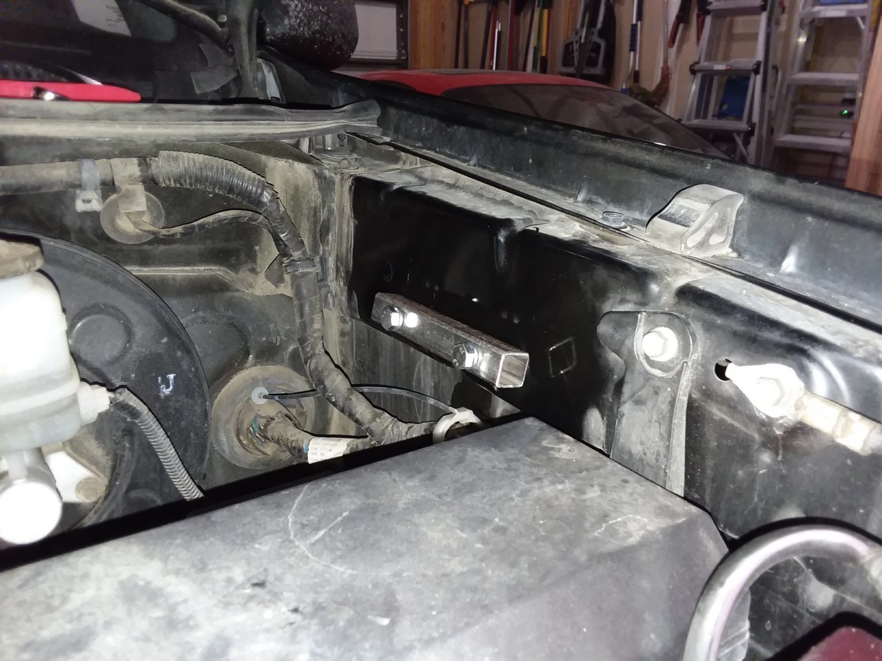

    I used some scrap square tube for the mounting bracket. I drilled the holes on my drill press and used the stock hole locations in the engine bay.
    I mounted the ring (that came with the can) on the metal bar after I painted the bar. I also hit the 2.5" long M8 bolts with some paint.
    I didn't really "clock" the can at any particular angle.
    Then I attached the transmission cooler line (3/8" ID). I didn't remove any hardware to get to the stock hose. Just reached in there.
    The biggest issue is that the fittings that came with the can are way larger than the fittings on the engine. I really had to work to get the hoses on. I then clamped the hoses with hose clamps at the can and reused the factory fasteners at the engine; and hit the clamps with some paint.
    I attached about 16" of hose to the drain valve for short term monitoring. I will eventually run longer hose down near the oil drain plug and empty the can during oil changes if I can go that time interval of emptying the can.
