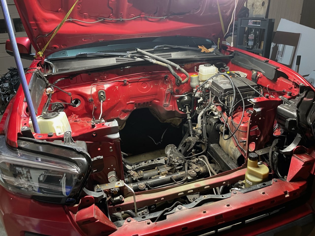

    here we start with the LF3 all pulled out and stating with a empty engine bay
    the easy part of this is i already have most of the needed swap components done. Electric power steering, fuel system is already done using the 2nd gen bucket fuel bucket and aeromotive pump
    So i picked up a 2014 L77 with a 6L80E transmission out of a low mileage Caprice PPV car, ive always loved using these motors in LS swaps ive done, they are all aluminum 6.0s with a cam they make good power. Any buy using the 6l80 i can easily put a transfer case on it with no issues
    so i took the oil pan off and sat the motor and trans in the truck to see what i was working with
    oil pan clearance will be no easy task, the front diff is in all the wrong places, trans tunnel has plenty of room.
    for exhaust manifold the factory caprice manifolds fit but the flange is pointing straight down which is pointing close to the front crossmember so i had to figure something else out

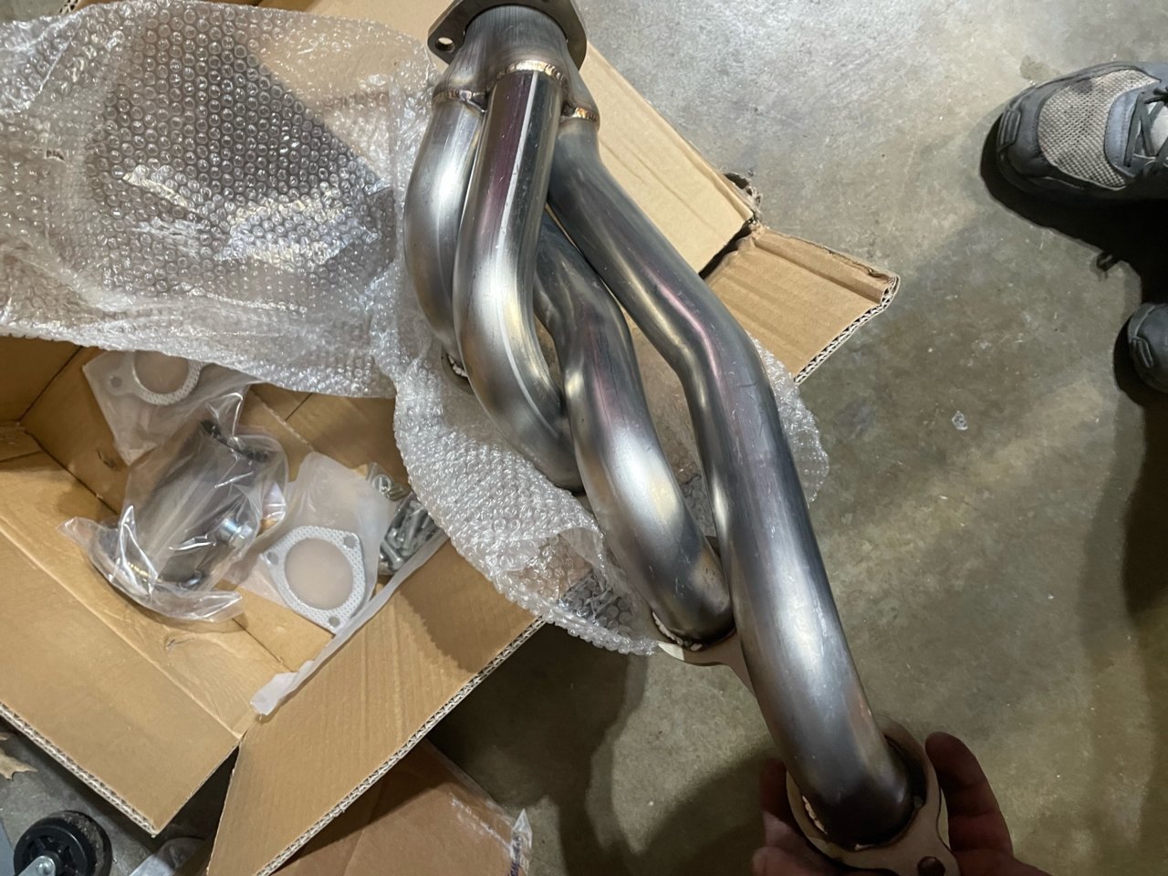

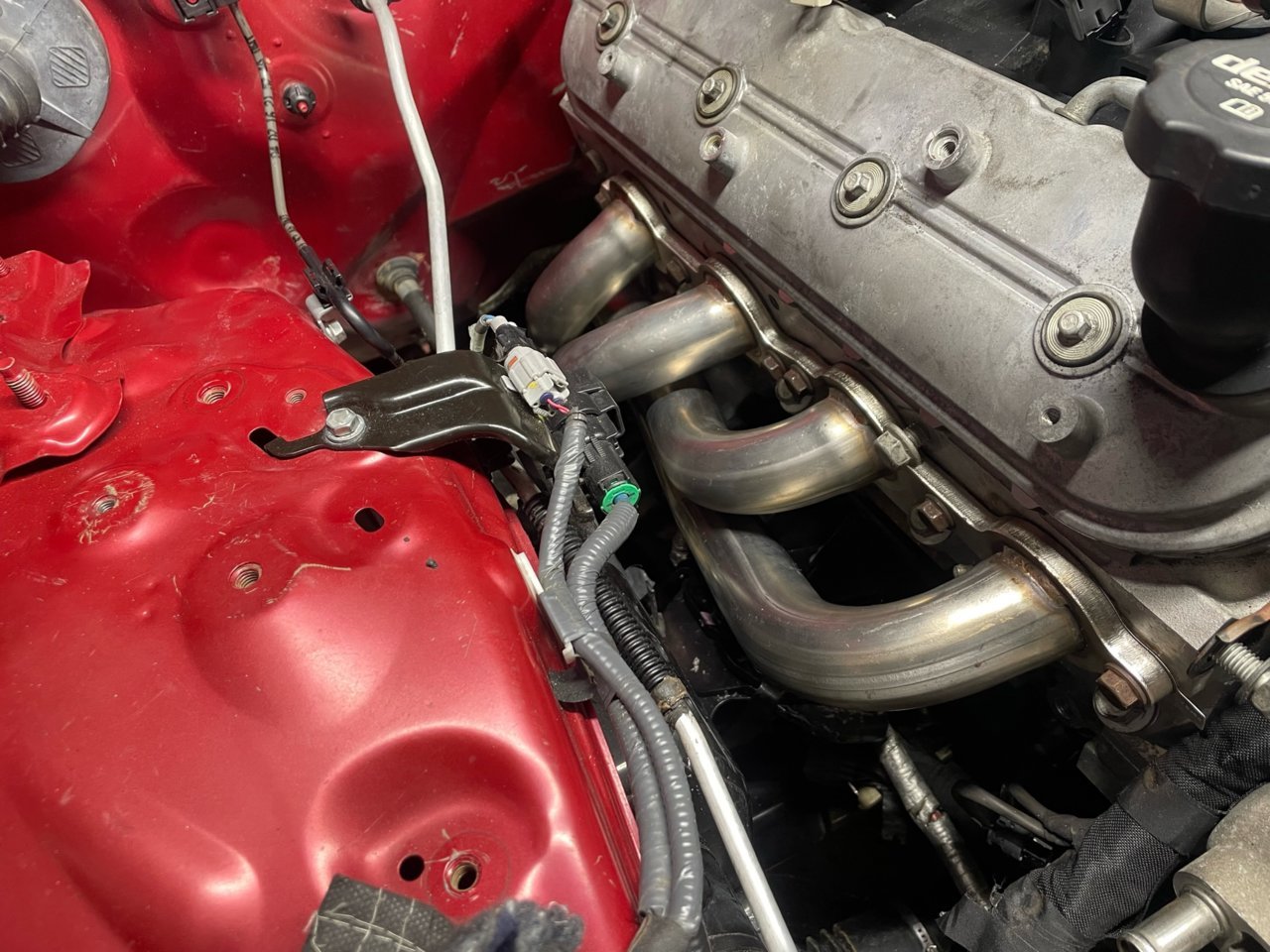

    picked up a set of trick flow mid length headers
    clearance was perfect of the passenger side
    drivers side it hit the steering shaft just a little so ill have to heat it up and put a little dent in it but nothing major
    Motor mounts are done but i forgot to get any pictures of them, they were really simple to make and im using the stock tacoma rubber mounts, i didnt have to cut anything off the truck, very easy to mount the motor and trans in the truck.
    The oil pan i pretty much have done too. i basically bought a steel pan off of speed way motors and cut to fit and rewelded.
    thats what i have done now, my plan is to have this on the road in a week or so
    ill first have it going 2wd since i already have a driveshaft that will work so thats easy

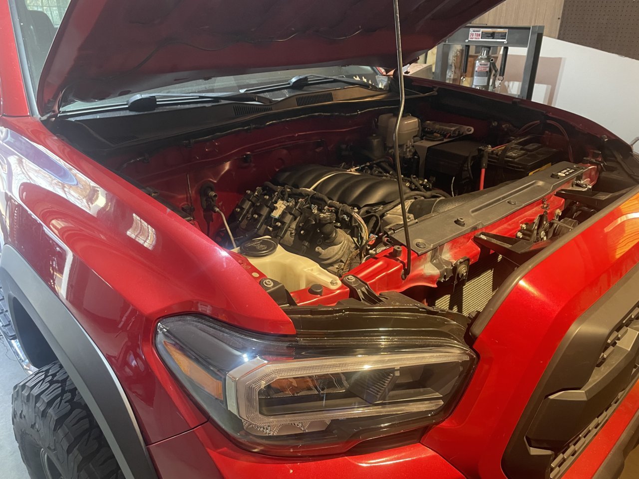

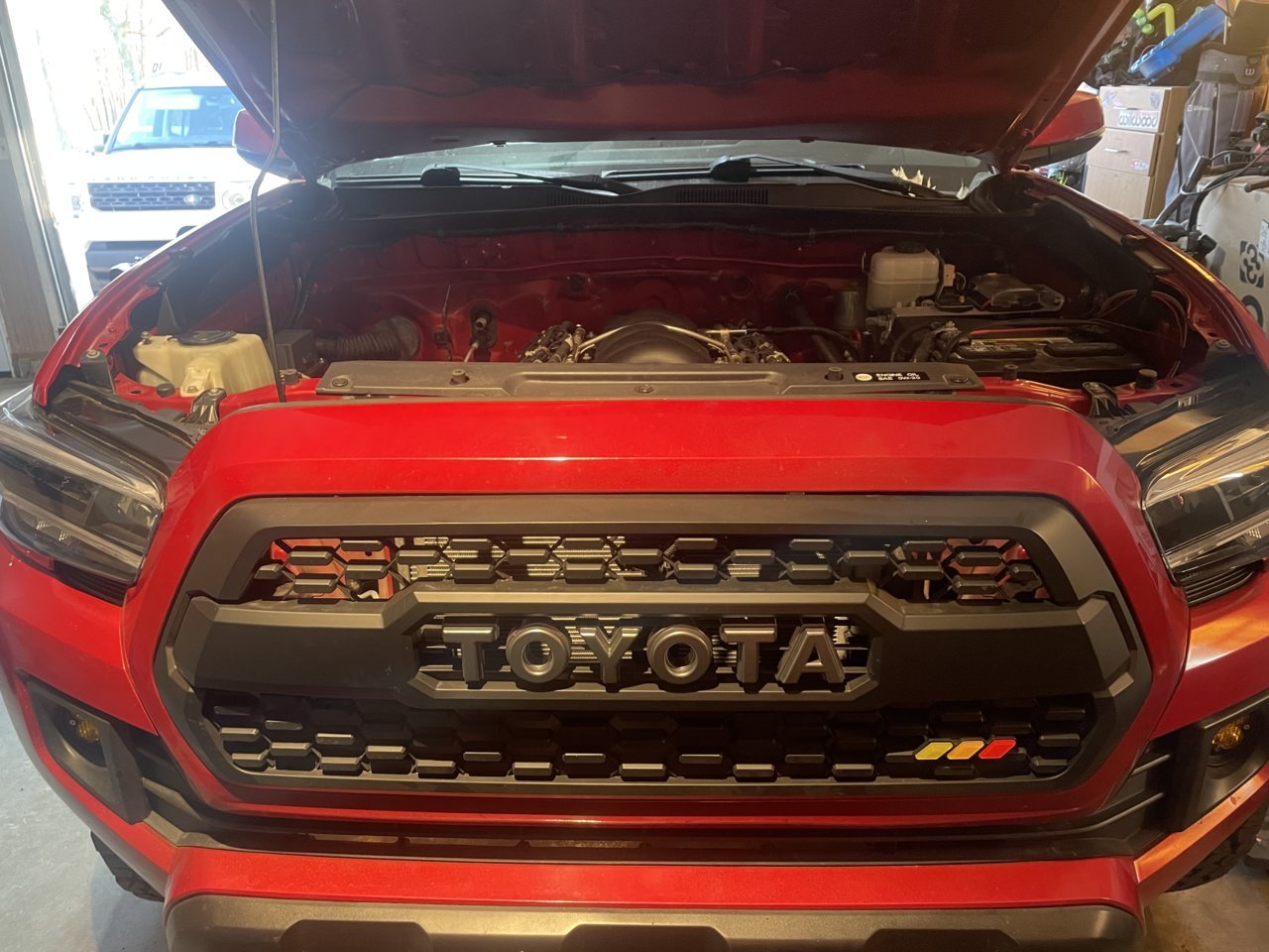

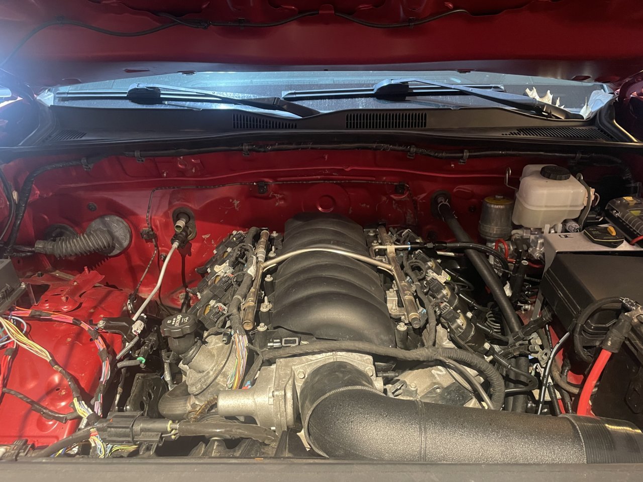

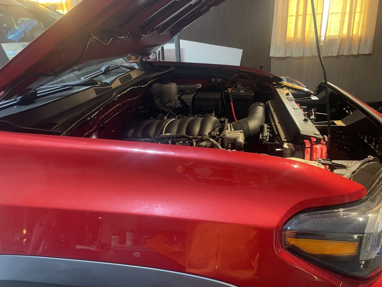

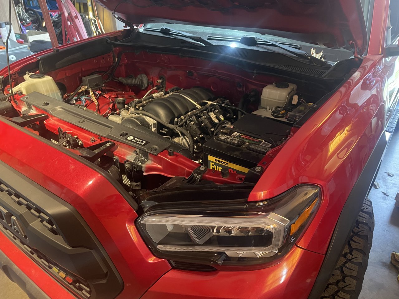

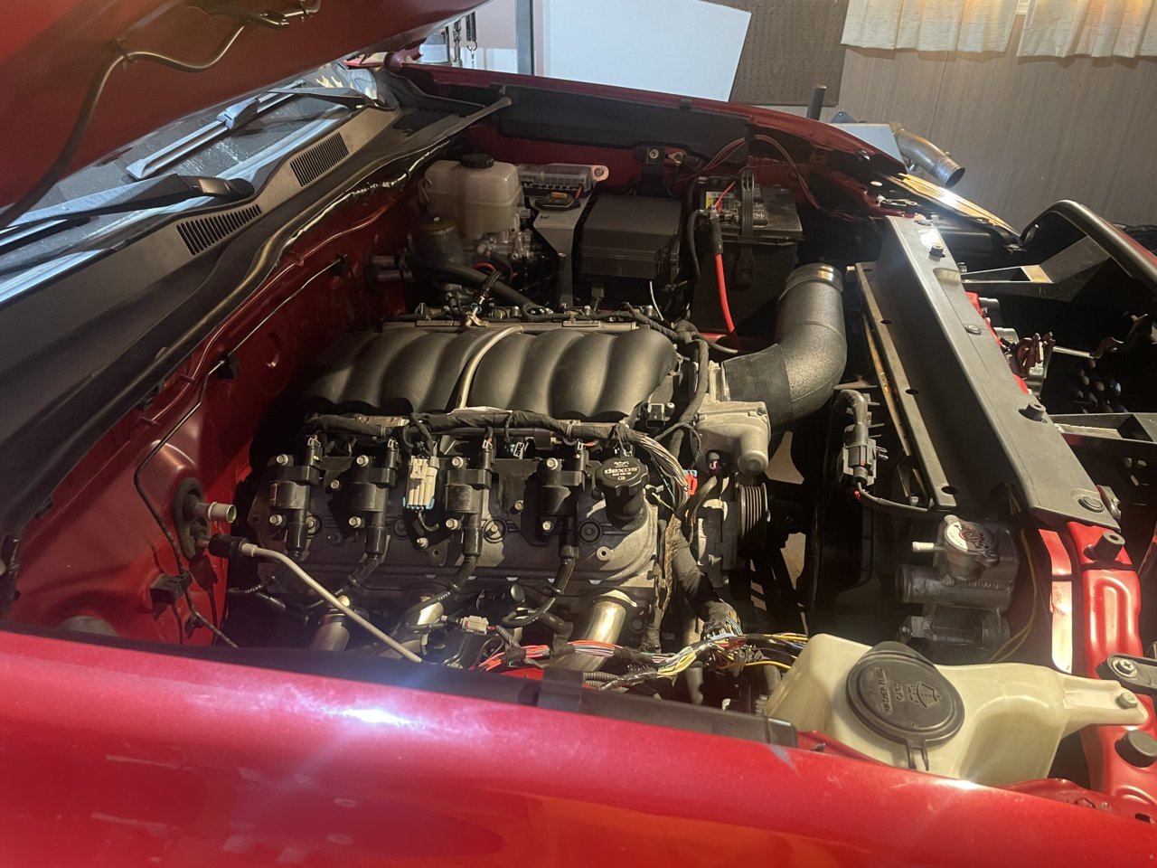

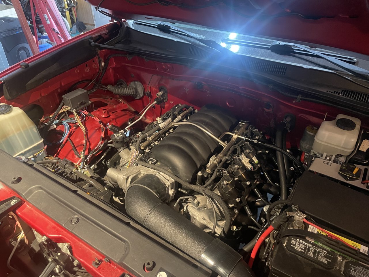

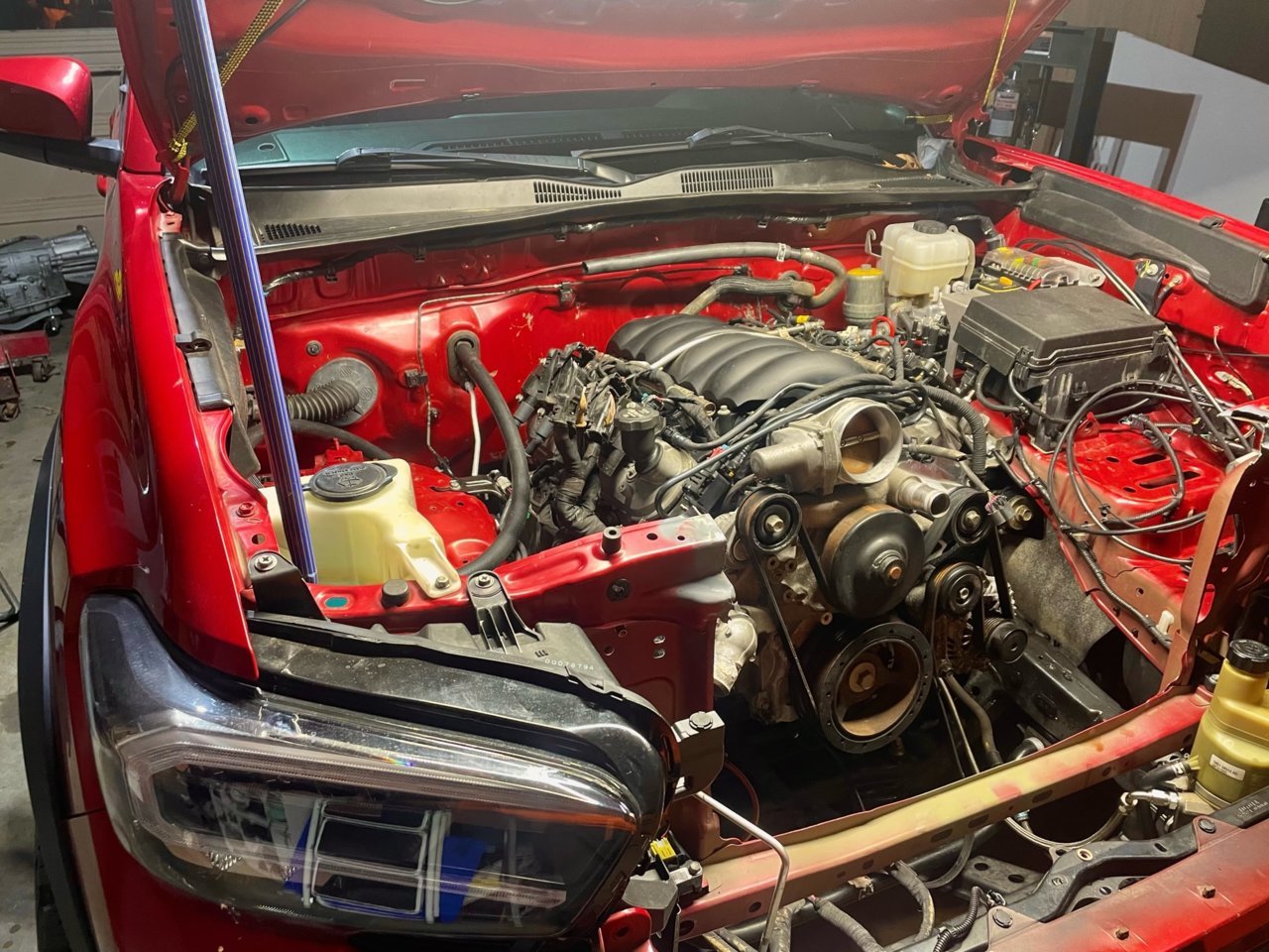

    Well I’ve pretty much got the swap all done, couple small things to finish like radiator hoses, and loom up all the wiring
    95004AAB-AF5E-4019-9C52-764E1ED81595.jpg 4742A49E-1A67-4DAF-92DE-988B2218AB64.jpg B94EB24A-FAB3-4CE9-9076-10EE2F8B705B.jpg E4DE90A7-AA5B-4F63-8883-E7A9450D1DA2.jpg B4FC8292-9491-4070-84C1-FFB6282F8563.jpg EAC2E1AA-CCA6-4138-829E-F09D2FB32164.jpg 0DCE3B72-BE04-4D4B-B3D4-49603D16D88F.jpg
    It’s crazy how small a LS looks in the Tacomas engine bay compared to the stock engine

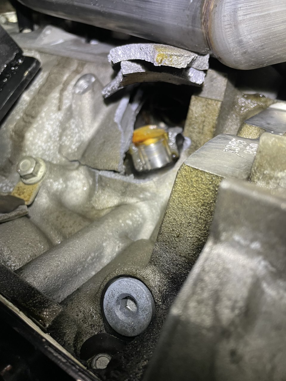

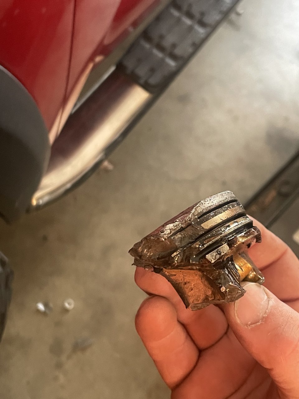

    so after I finally got everything done I loaded up a base map and started to crank the engine over. About 5 seconds of cranking a piston decided to exit the building. Only explanation I can think of was something was wrong with the engine from the get go, I bought it from a salvage yard with a warranty so hopefully I’ll have no issues getting another
