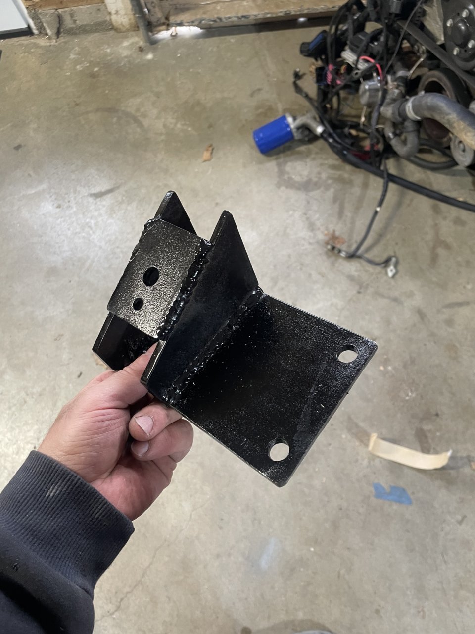

    I need engine mount pics. How did you keep the stock ones with the LS? I guess it's too late for me since I already chopped them off and had custom made ones and getting ready to weld them to the frame. But neat!
    and Trans mount? how! did you reuse the oem crossmember or get a universal one?

  15. Apr 7, 2023 at 8:50 PM
    #35
    Drewthecarguy
    Drewthecarguy [OP] Well-Known Member
    Jan 17, 2023
    #415663
    104
    Drew
    2016 TRD OR
    3.6TT Engine swapped, Icon Stage 4, SCS wheels
    this is what the engine mount looks like, this was before cleaning it all up and properly painting it this was just a quick coat so it wouldn’t rust, this bolts to the side of the LS and it sits on the Tacomas rubber mount, super easy, and for trans mount I’m using the 6l80s rubber mount on a 3x3 aluminum thick wall square tubing bolted to the factory trans crossmember, once again super easy

    x2 on any moar pics of the oil pan cutting and welding modifications. :popcorn: It would be neat if the oil pan and mounts were offered as a kit. :stirthepot::burnrubber:

    If I didn't already chop my mounts off, id be asking you to make me these... Fuck.
