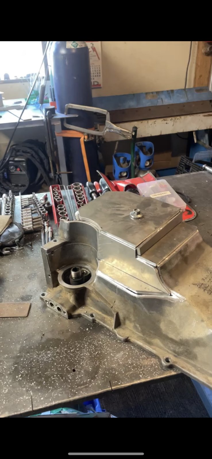

    Green truck
    Was there no off the shelf oil pans that would give the clearance you need? Working on a 5.3 into a first gen and can't really find if there is something that will work that isn't custom made.

    As far as I’ve seen a front sump fits pretty easily since it’s rear steer on the 1st gens.

    While that is true, I haven't come across very many 3rd gen T4Rs or 1g tacomas that have the 4x4 in place with the LS swap. While it'll all become a lot clearer once the 5vz is out and the LM7 is bolted to the R150F, I am just looking to see if others have found a solution for front sump, low profile pans. There are a lot out there in the market but it's a crap shoot trying to get one before wedging the V8 in. I'm not certain that it can be done without a custom pan. While the steering is in the rear, the diff is still there on the driver's side and the engine bay is much smaller than a third gen.

    No off the self pans what so ever, hardly any room with the front diff in there

    Yeah I am worried about that. Did you happen to take pictures of your pan you modified? I know it's not apples to apples but I would be curious how you modified it. Much appreciated!

    This is how much I took out of my oil pan and I in hindsight I should have taken more out. IMG_2022.png

    Thanks! Sadly my life took a left turn and the LS project was shelved.
