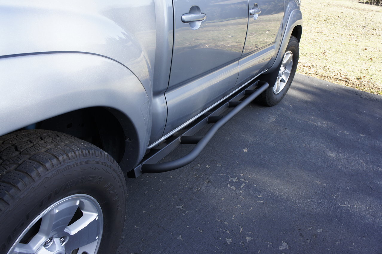

    Mobtown Sliders

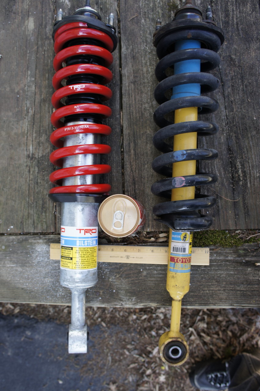

    Just picked up a lightly used PTR13-35150 (2nd gen) TRD Pro Kit. Previous owner had it installed on a 3rd gen with mixed results. With warmer weather I will start the the install.

    Old vs New
    Front installed
    Rear installed
