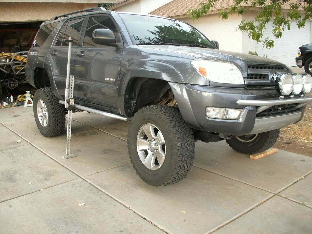

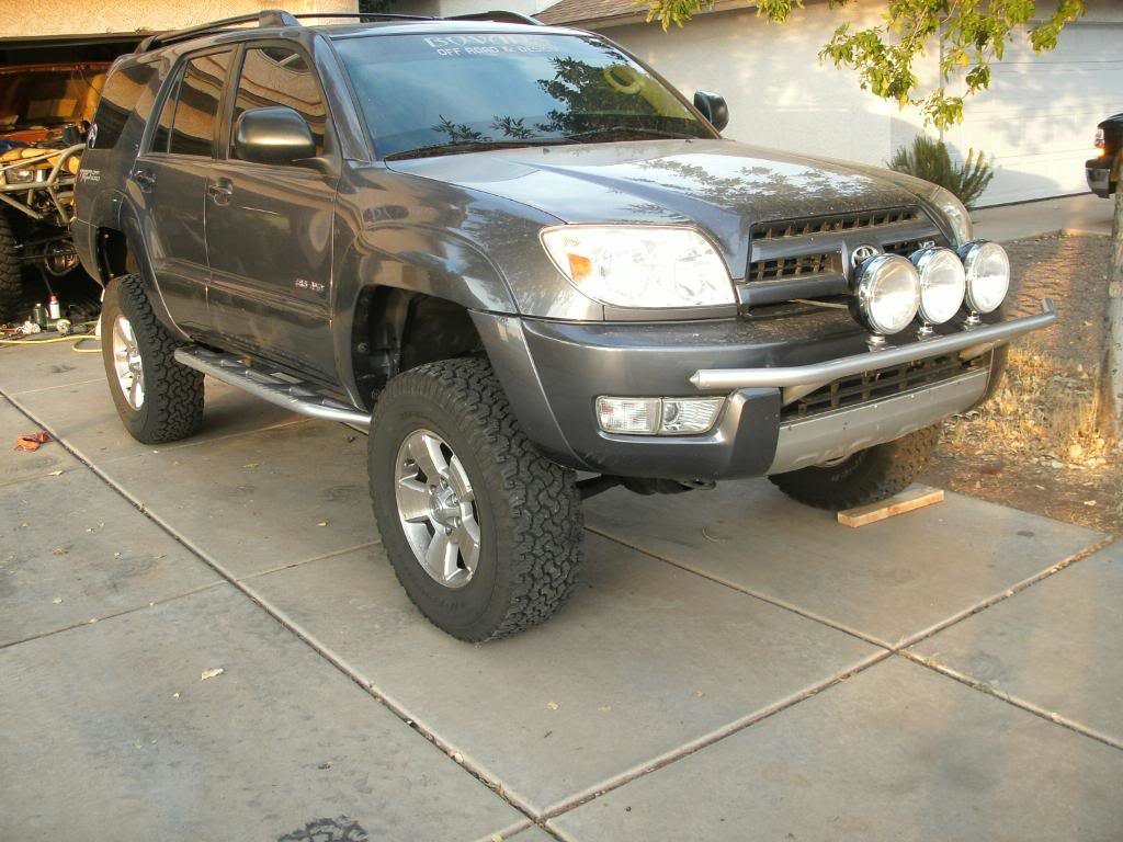

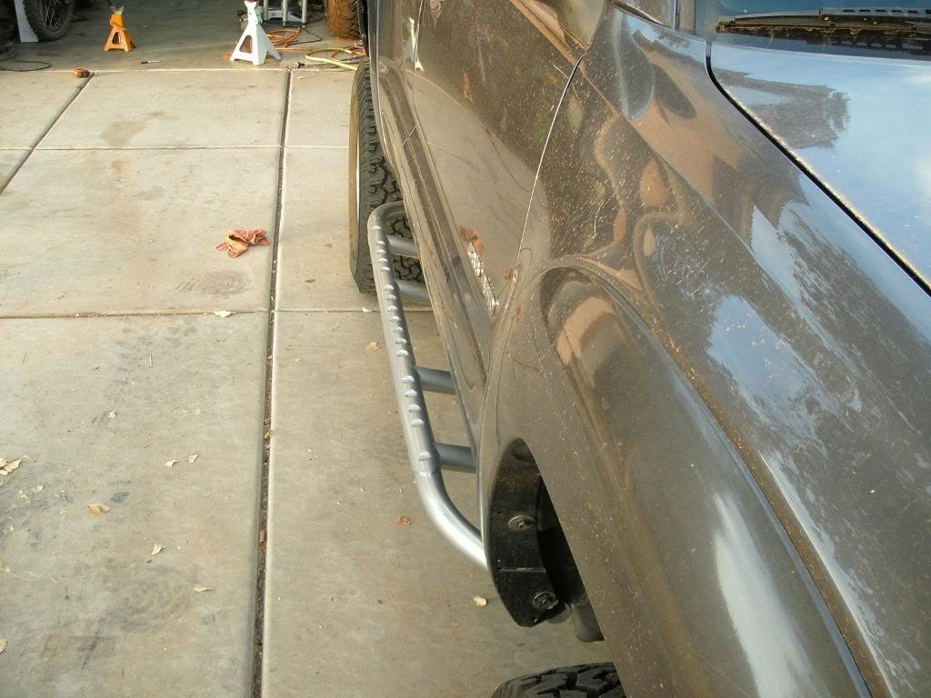

    well since my runner on tons is taking longer to get finished than i tought i figured i better get wifes runner a little better equiped for a snow run this winter. built a little light bar and put 3 procomp 130's with hellas 100wt yellow bulbs in them
    then figured i better whip a set of sliders just in case(i dont drive so well)

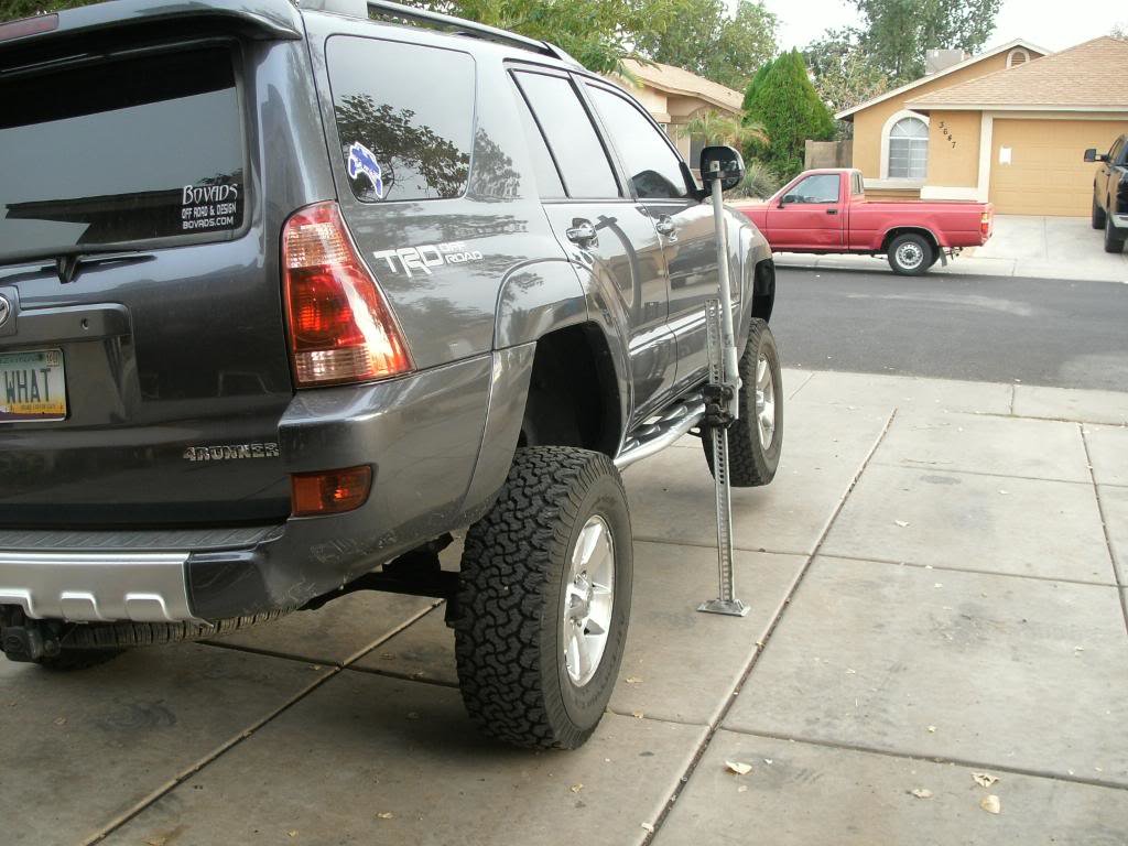

    i wanted to do something different for a rough surface so i tried something different. built normal sliders, 1.75" dom, with 4 attaching legs (little over kill for such a short wheelbase) but then i cut another peice of tubing longwise and drilled 1" holes in it, then welded it to the top of the slider
    kinda hard to see in pics
    it came out okay but nexttime ill do it a lil different yet.
    so then next was the driveway test
    well seemed to work so far
    guess well see in the real world

    thanks for all the comments. yes i "whipped up" the sliders:D i do a little fab work every now and then. the tube ends are a billet steel end that slips into the end of the tube to make a "swoopy" finish

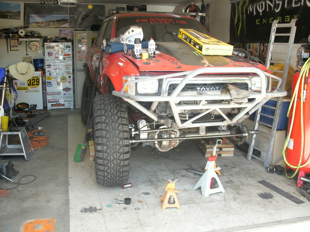

    heres my big project
    '90 4Runner on 1TONS , linked front and rear, and 40" creepys
    and yes the "WIFES" runner gets wheeled all over NM, CO, UT, and AZ

    Well had a long weekend, so among a couple side projects(sliders, bed bars) i finally got this thing roll out the garage on it own!!!:D
    4D's, 60 front, 14 rear, 3 linked front, 63" chevy's in rear. this thing sits low and wide. 23" to belly with 20psi in tires!!

    98
    it was already there, it sits lower now than it did on 37's with leafs, and yota axels.
    and if ya must know i backed into the garage with runner on the trailer and hit the house, i know im a dumbass, it was dark with no spotter, drive by brail:D
