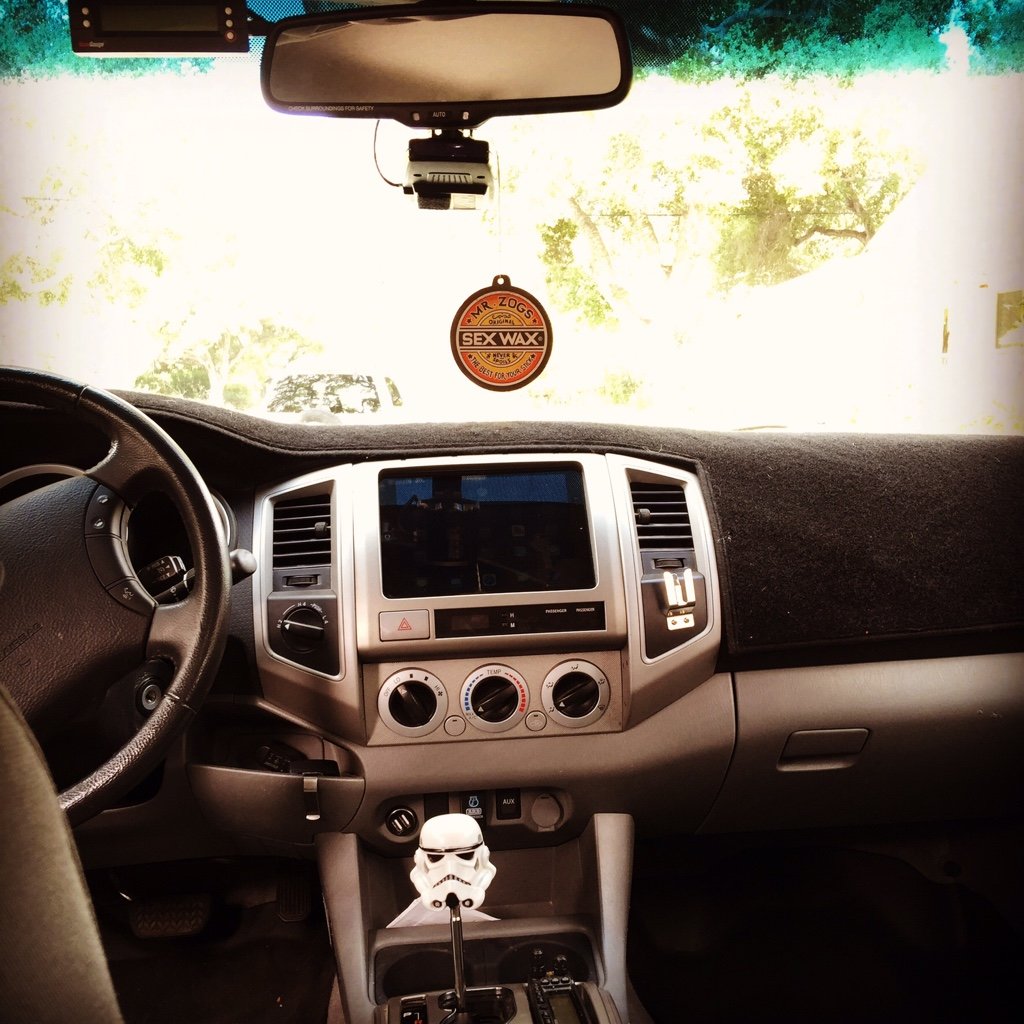

    Ipad in dashkit

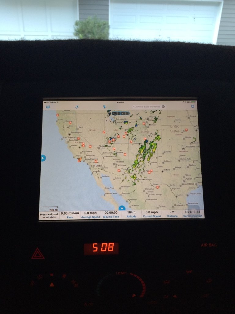

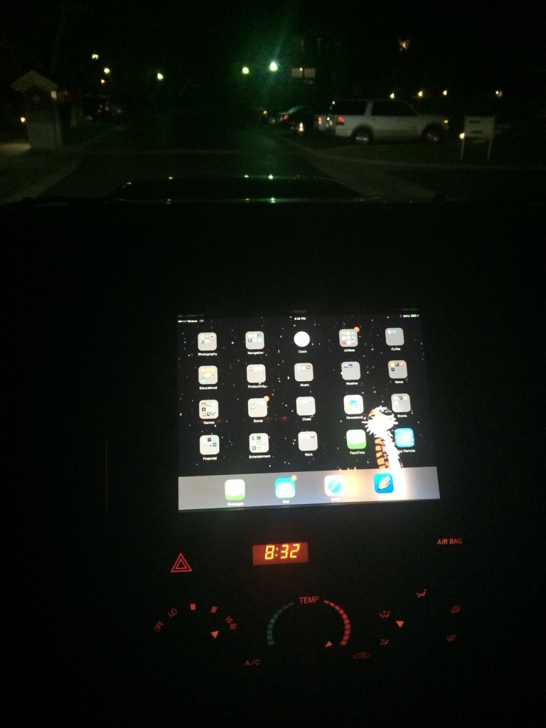

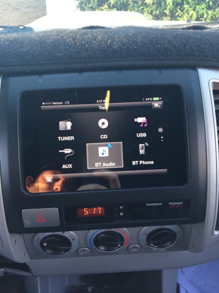

    I've been using my ipad for GPS since I got it. I run an app called topo maps (can't remember price) along with a blue tooth gps adapter (gns 1000). This lets me download topo maps of the area I'm in and still be able to see where I am without cell service. Has worked perfectly so far. The main thing for the kit is now this set up looks like it belongs in my truck I don't have to run a ram mount and have cables everywhere. Everything else is a bigger plus since you have ios in dash. Shane's set up actually integrated my steering controls better then I already had th and the sony app is a 4 star because it could be better but it's still great since you can literally access everything in the radio from the ipad. Example picture of the app below.
    Also here's a picture of the app too.

    Hmmm that looks like a great alternative to buying an aftermarket head unit.

    There's a bunch of options to connect it, for me there is actually a headunit sunken behind the ipad which wasn't expensive to set up at all. Still cheaper then a double din unit.

    Awesome! Thanks for the reply. I've already started a list of Apps on my build page that I'll get when I install this system.
    I was also looking at 'TOPO Maps'. It looks like that app has some of the highest quality Topo maps available for iOS. It appears that the maps were developed from the same survey used to create the military maps that I'm used to. On his website, the "older" paper maps look identical to standard military maps, minus the military grid reference system (MGRS) overlay. I'm hoping that the modern rendering of these maps will allow me to add the MGRS.
    The iOS platform is the reason I'm making the switch to the iPad from my double din unit (AVIC-Z140BH) - the options for improvement / development and increased functionality are endless. I also appreciate the ability to easily upgrade the hardware as better products become available. Instead of having to buy an entirely new head unit + install to increase functionality, I can just replace the GPS receiver, or iPad, or radio - which ever is needed, for a fraction of the cost.

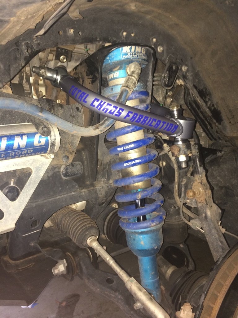

    Ordered my heimed upper arms and will be picking them up from DMZ fab saturday, install will be next weekend since I have 2 tests this week.

    TC heimed upper arms are in 220d22942c2d127109d9f392e12174cc_d90e08d32c86af7a35732e332d513053b0c2af63.jpg

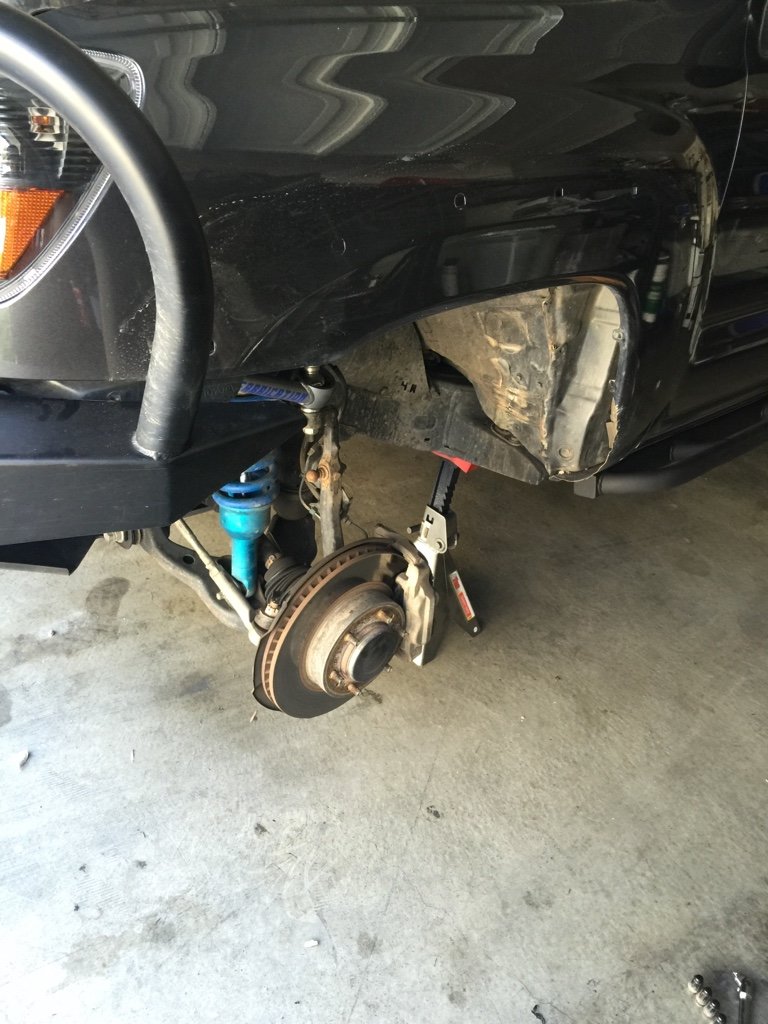

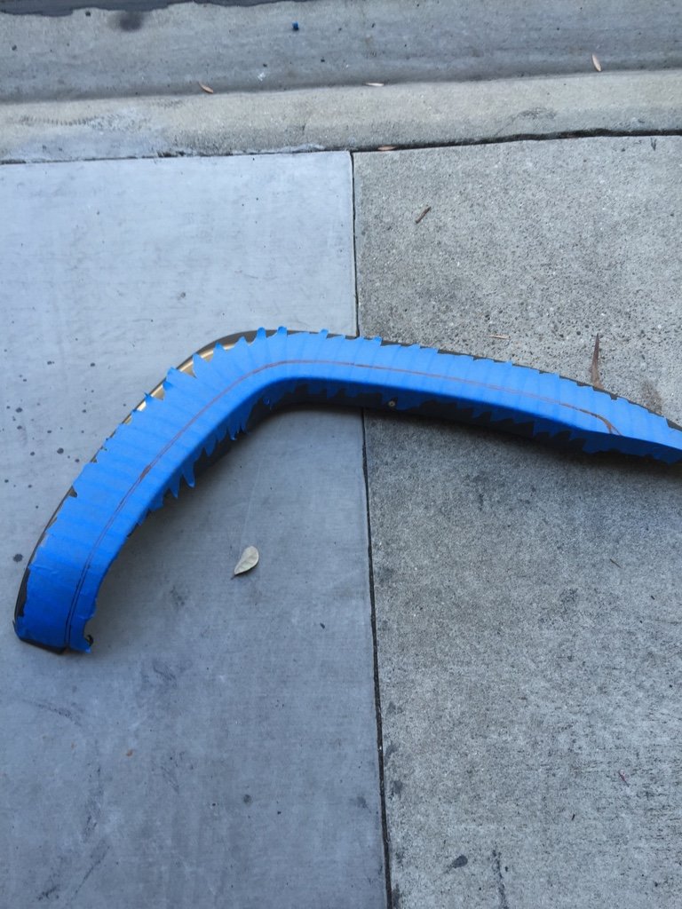

    Started the prep for 35s today. Cut the flares and marked the fenders. Waiting on a tool from McMaster to finish. 5ada3fc683059975154092ce690a45b8_522bbfec2c734655850d4dd2368d23ff8e9bfba1.jpg787fd4d7b4825e8c8748395a95e2451e_ff99942996c06a9daf214f2c93c29cc11ea17c1b.jpg
