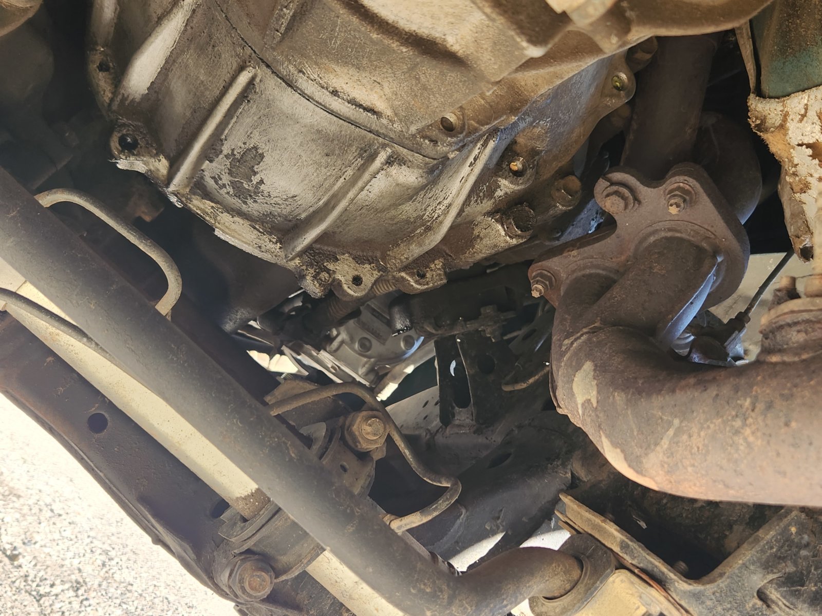

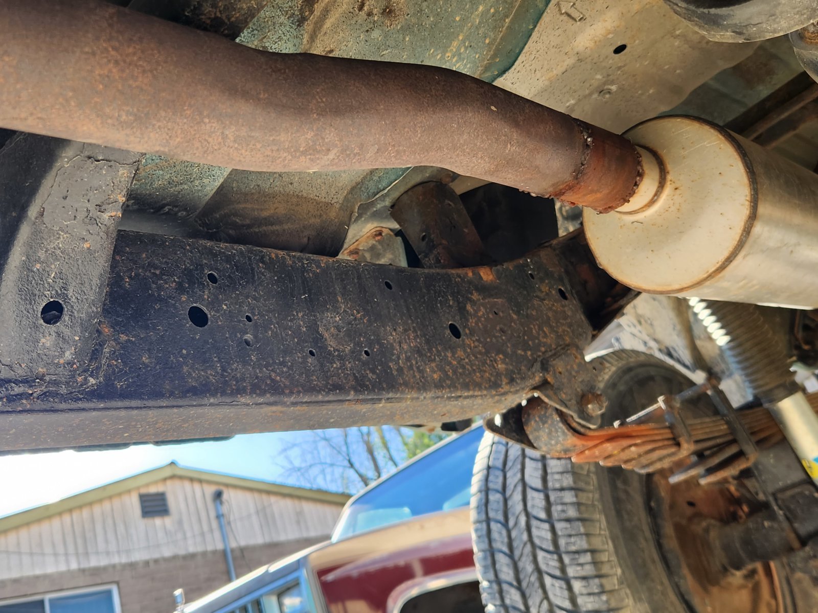

    Well I haven't gotten the maf cleaner but I did clean the throttle body with very very very little brake cleaner. From looking at the picture above or below on this post I think it's fair to say it hadn't been cleaned for quite sometime. Worries me really on what the rest of the inside looks like. I still need to post some more pics of the frame I'll get my phone charged a bit and do that. Once again thanks everyone.

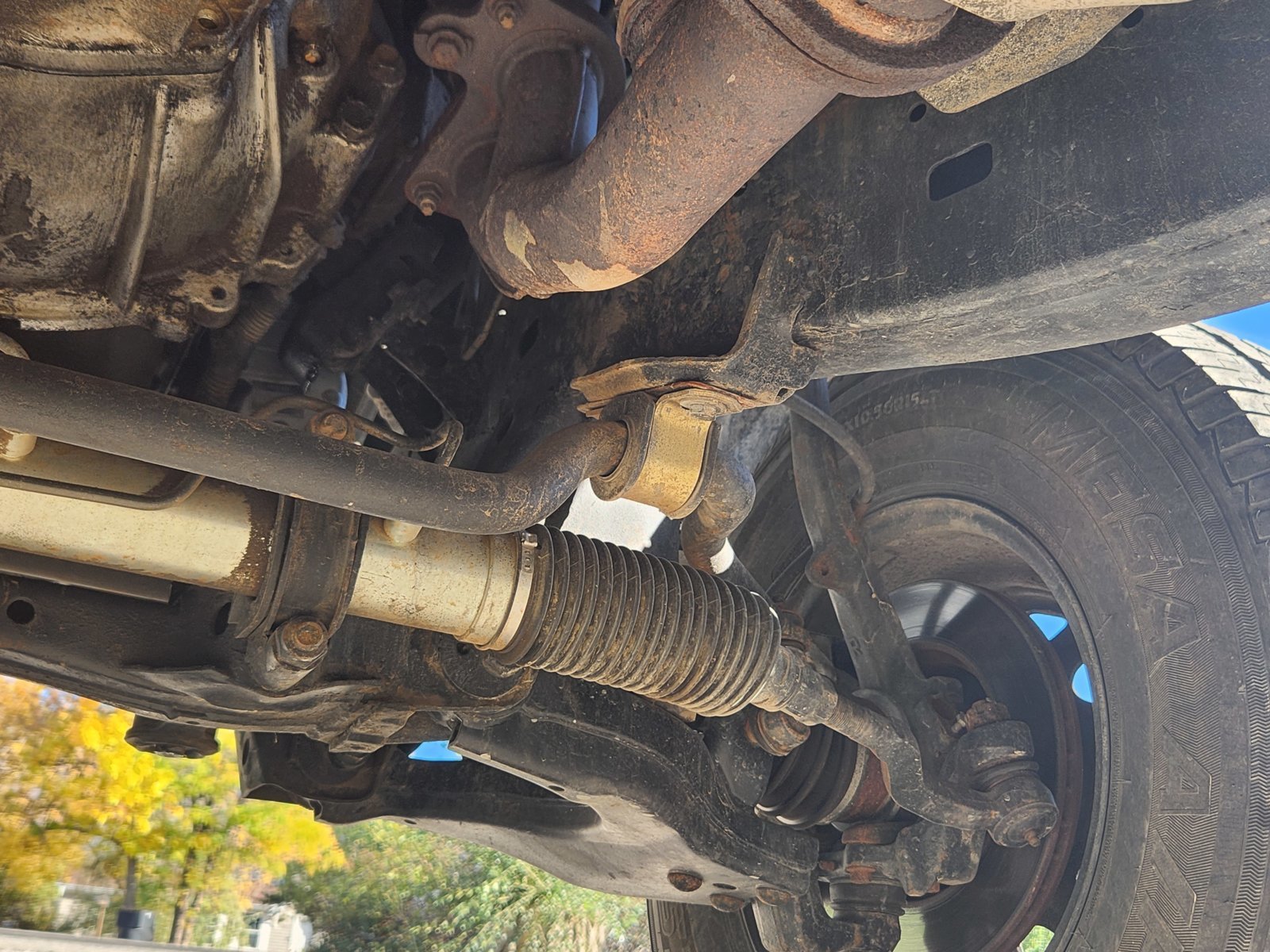

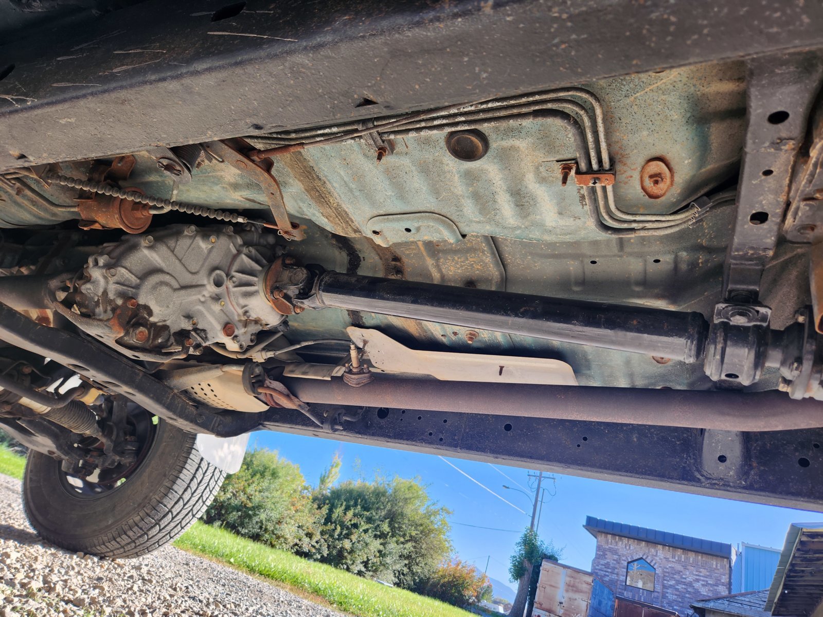

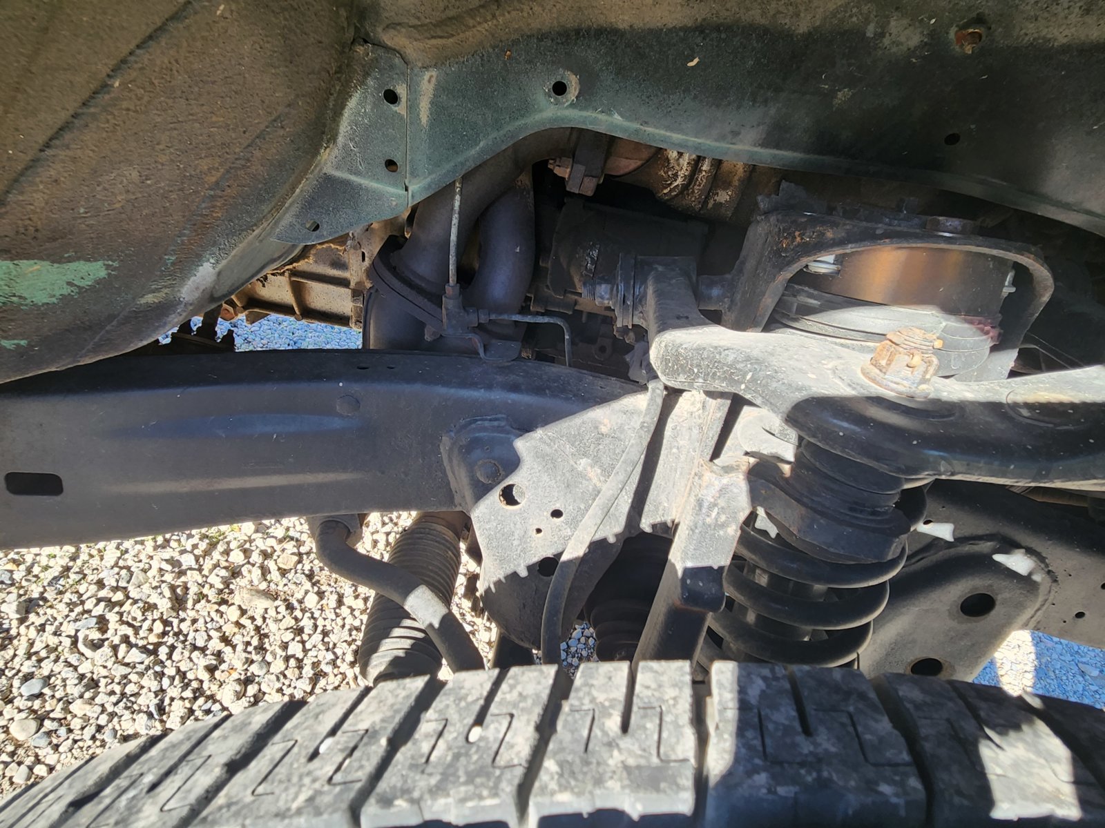

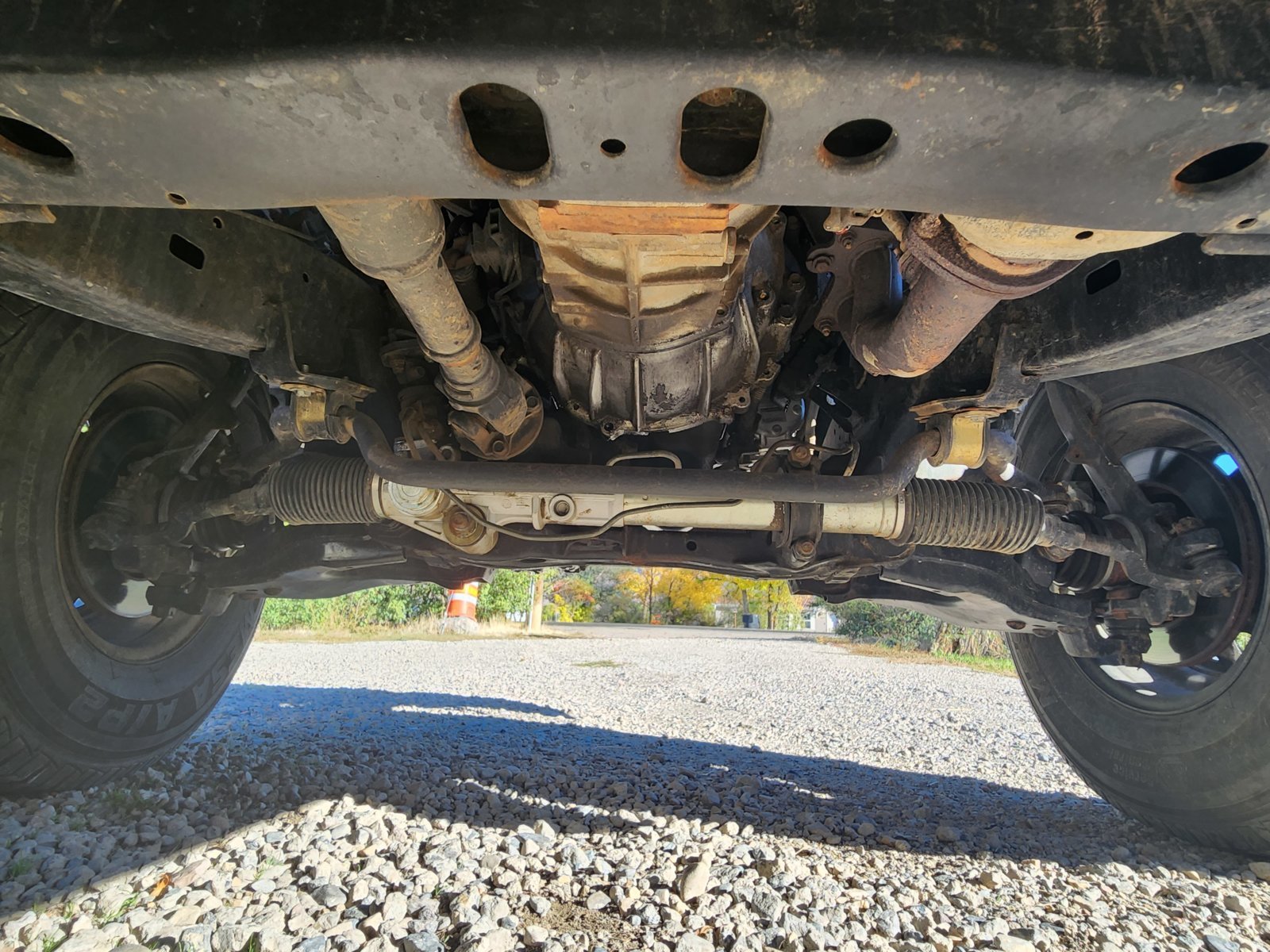

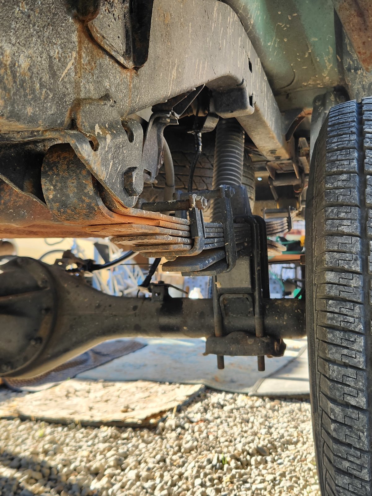

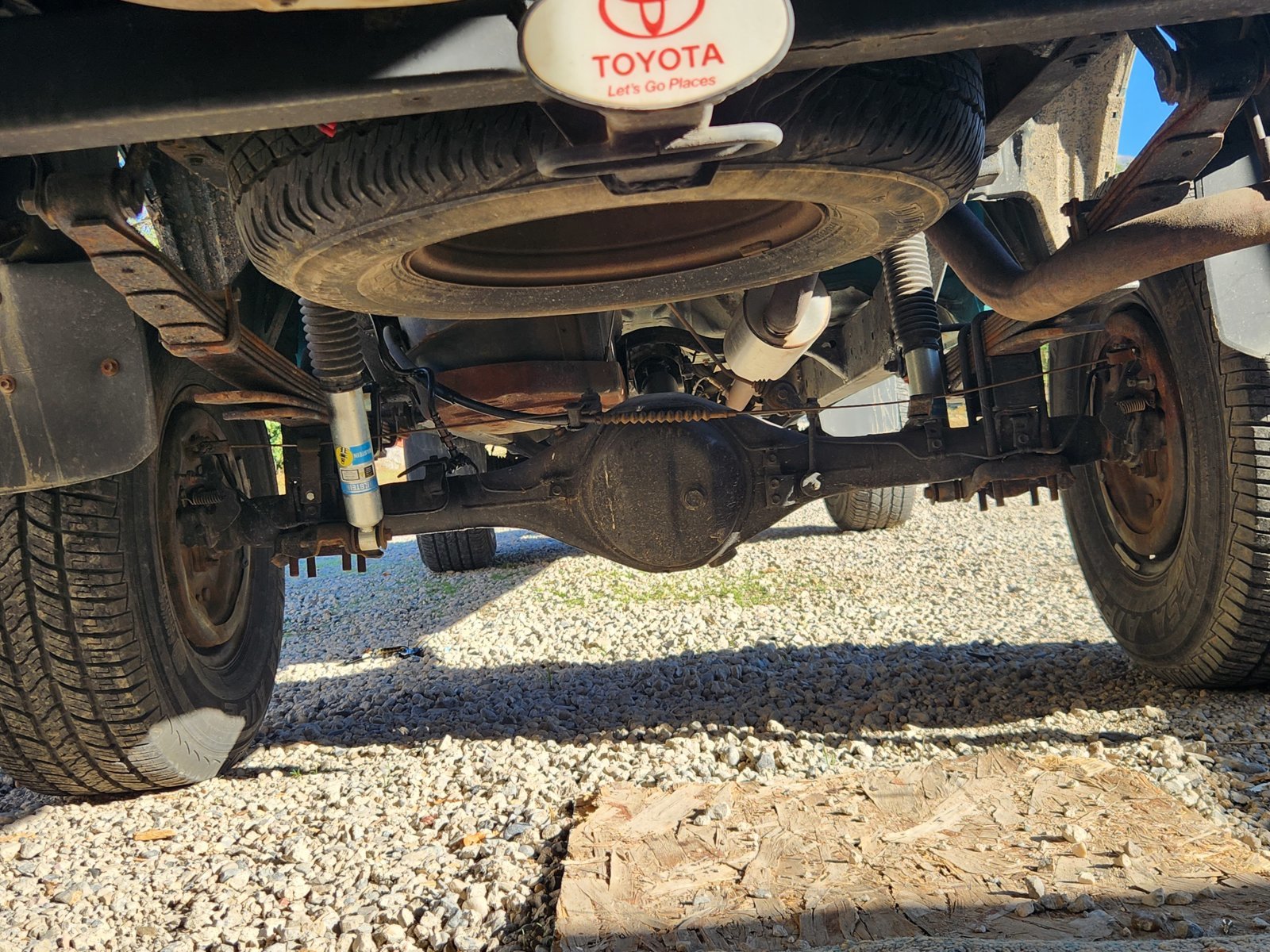

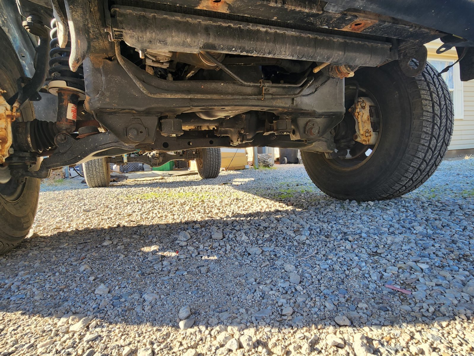

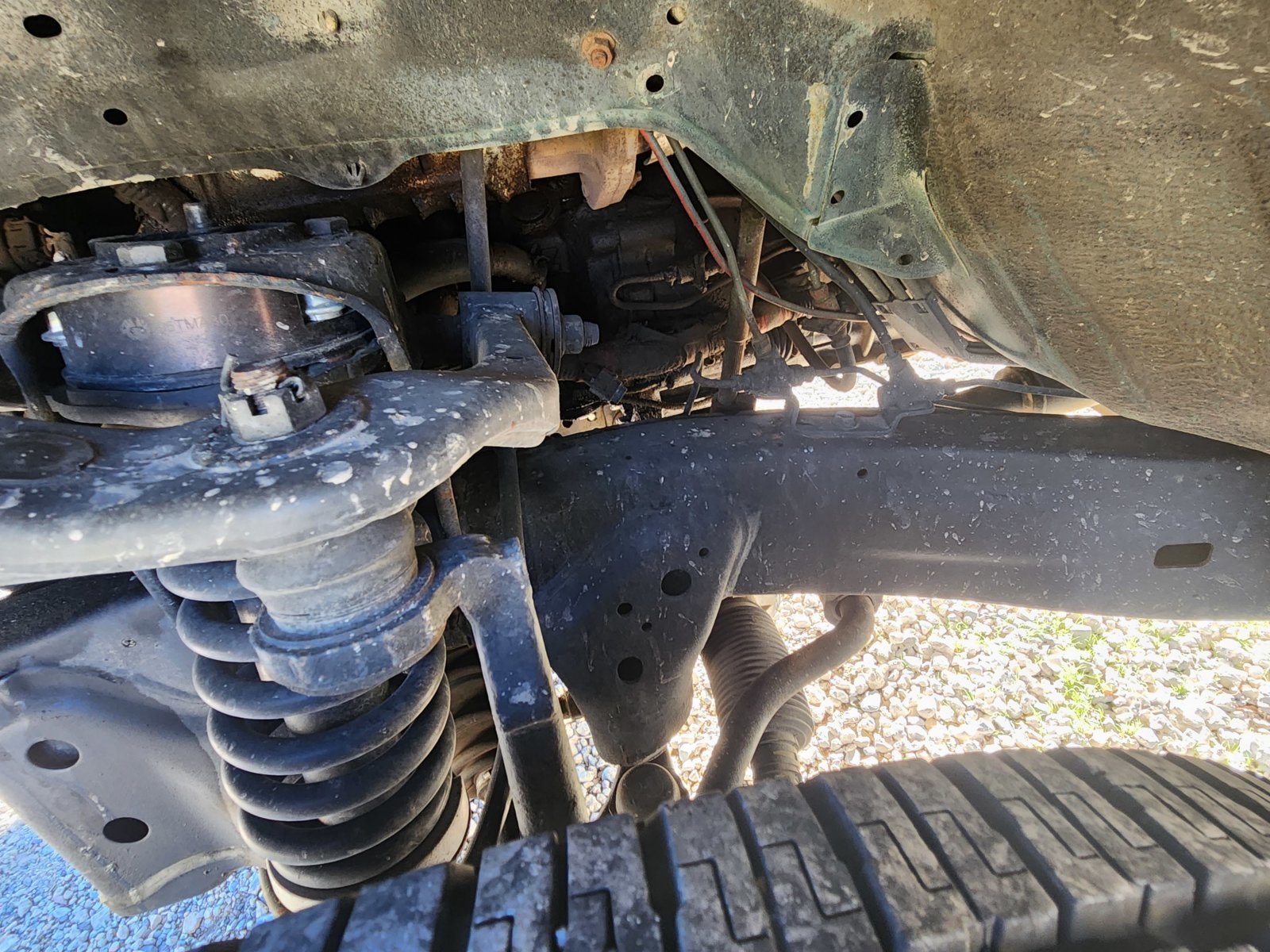

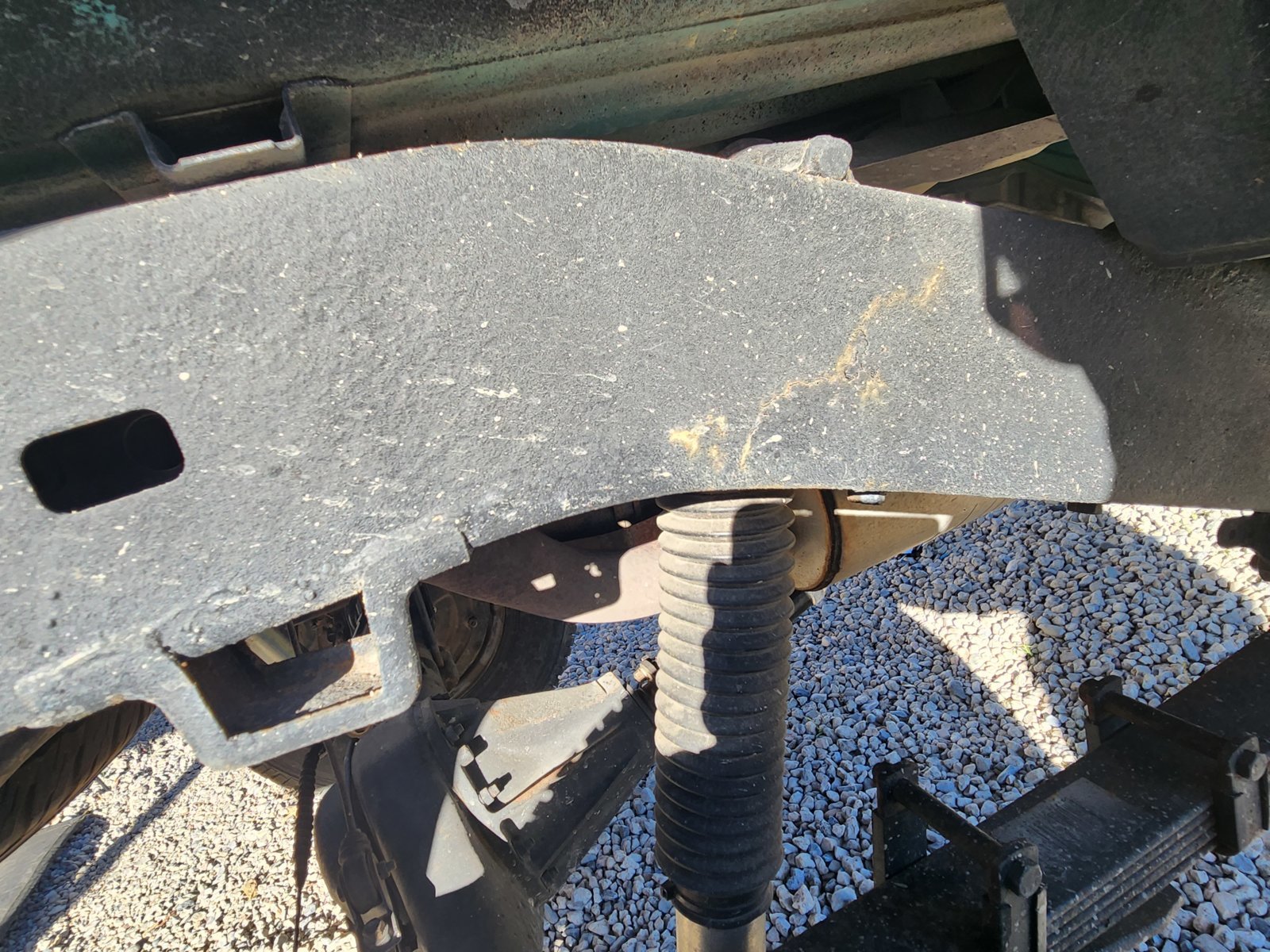

    I just took a few pics of the underside with what Lil juice I have left.

    Wow. I don't think anyone thought it would look that nice underneath. That's good news. There may be some rust issues in front of the rear leaf springs. Hit those areas with a hammer to see if there are any actual rot issues. I would certainly look at the spark plugs to see how old they look. Worth replacing if worn given your issues and how cheap plugs are. The MAF is definitely worth looking at as well. It is cheap, quick and easy to clean. Also, if you're in the midwest you should look into fluid filming the frame and underbody to keep it decent.

    Your truck doesn't look that bad under there.

    I think your brake hose is leaking

    Good eye.
  15. Oct 18, 2023 at 7:10 PM
    #55
    Speedytech7
    Feb 20, 2014
    #123587
    58,110
    FCQM+VG Cheney, Washington
    It's less Tacoma and more mod
    That's the right side for the brake line the bracket was just bent down vertical for it for some reason

    Seems likely the OE brake line was a bit short when the lift was added. Couple more from the “what’s wrong with this picture” exercise:
    It appears there’s a bolt missing from the caliper
    And swaybar endlink bushing is shot
    Gap between the steering rack bushing and the rack
    Whoever did the alignment on this should be punched in the throat. Wheels are straight and look at the bellows, drivers side is compressed and passenger side is extended.
    And some minor stuff like wheel well skirts and skid plates are missing.

    That's probably what's clunking around when I hit bumps. And the compression thats favored to one side how serious is that and is that something I could possibly do or special tools needed? Thank you for real I appreciate it
