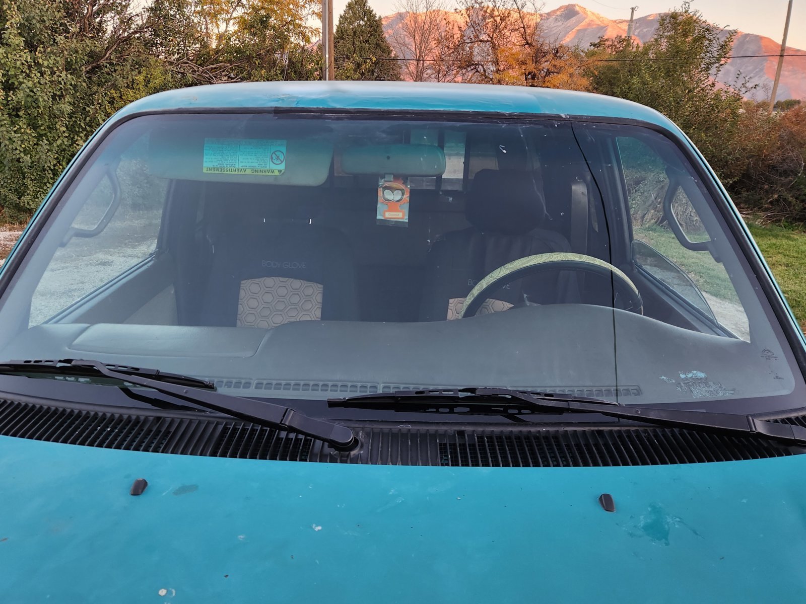

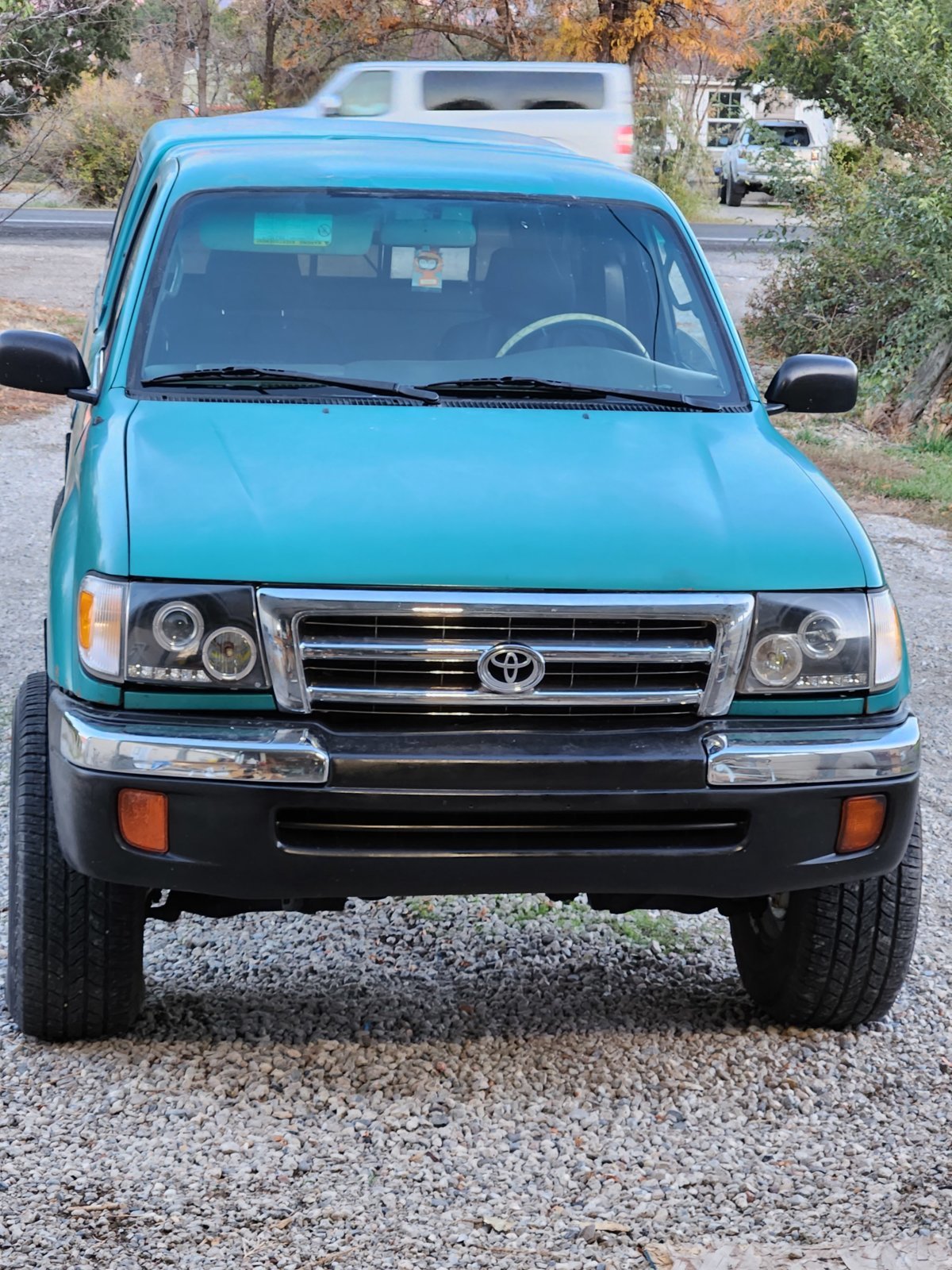

    So here are the pics of the color match on the topper I ran out of paint in the fourth quarter but I thought that might happen since I had half the paint to work with compared to the primer I was using. But I made sure to get all tye areas that are the most visible. I will have to go buy another can or two to finish it up maybe this weekend. I had a few really big cracks I had to patch up with those fiber glass sheets and resin. No rear door unfortunately I might just pull the frame for the rear door on the white topper I still have and somehow finagle it on there or something idk.
    I took a couple pics of the front to show you all since I took care of the rust hole that was right above the windshield I know it's not a complete fix for it and rust is a bitch. I figure if this truck was any younger I would go for a more serious fix. However I did grind out all the rust that was under where I painted, patched the hole with jv weld steel stick then rust reformer body filler primer paint then clear. I am so excited to have that thing covered up and looking better. I feel as though I can feel proud of my truck. What you guys think of the color match shell. I thought it was going to be to much and I wouldn't like it. But I do I really do. Anyhow I feel good after all the real maintenence I have got done so far as well as the unnecessary cosmetic details I have taken care of. But really with the rusty hole above the windshield covered and feel halfway decent about how it was done atleast with money in consideration I'm super proud of my truck. Enjoying where I'm at in my journey and excited for the ups and bracing myself for the downs that are still to come. Happy with the progress.
    Let me know what yall think of the pics. TIA everyone.

    Looks good! After some of the big jobs (like the roof) take a break and work to take care of the little stuff too: missing antenna, gas door... little details make a big difference: In the immortal words of the great Jake Blues:
