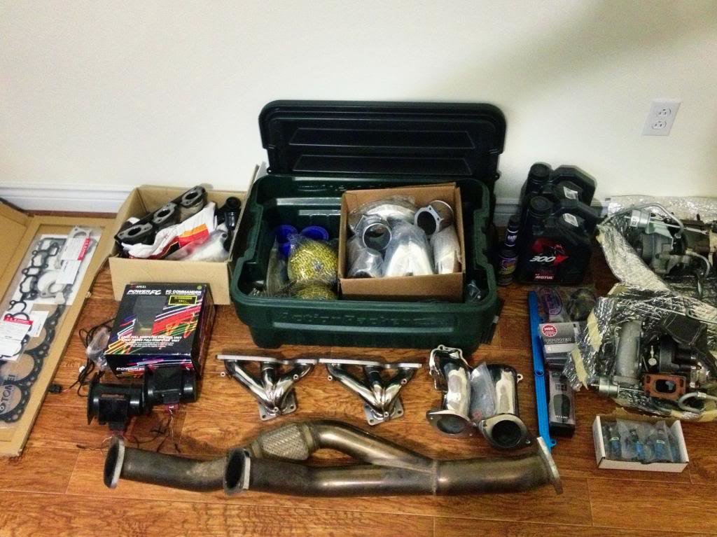

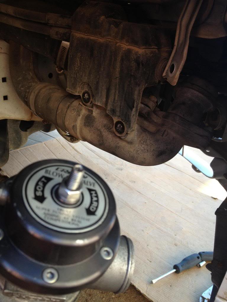

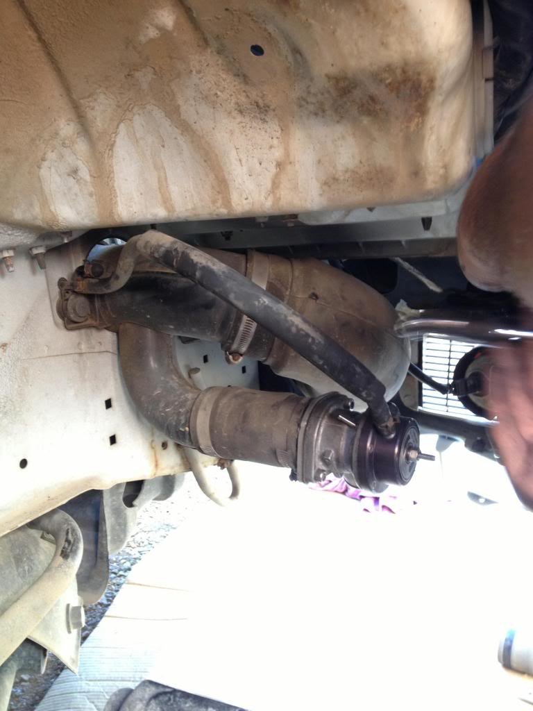

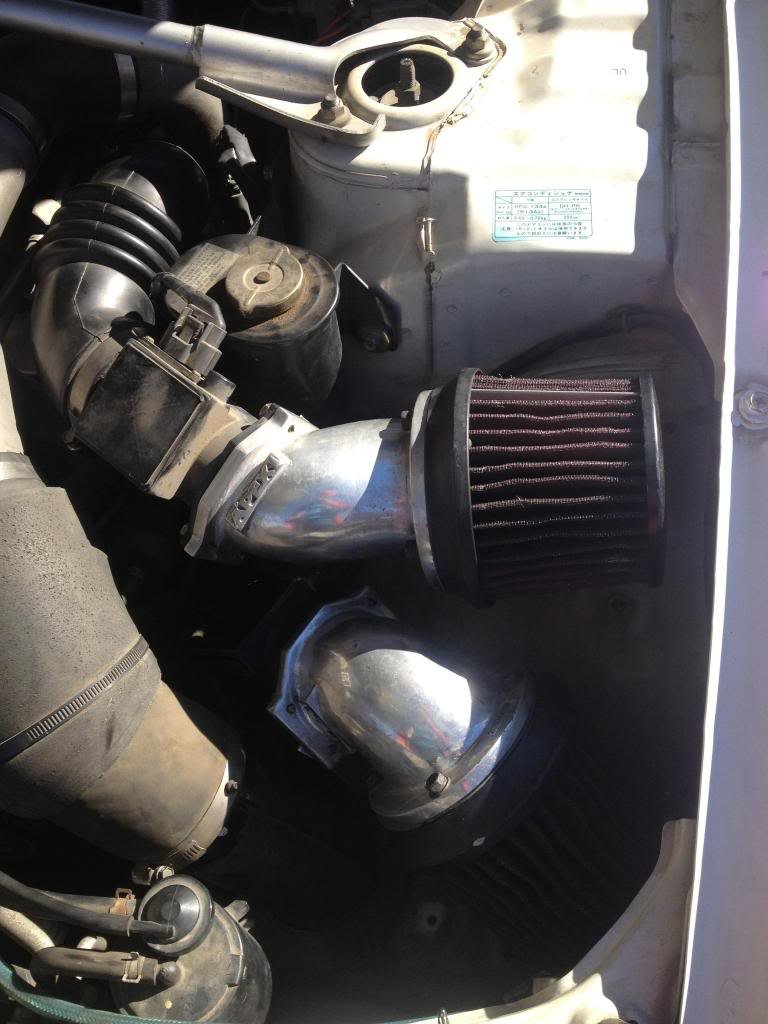

    Small update on the car, got two Apexi Intake Pods second hand from a friend who owns an R33 as well. For 100$ I said sure, at least it gets rid of the air box! After some much needed cleaning in the intake piping everything was back together.
    So my friend suggested I can start deleting unnecessary systems in my car. Example my charcoal canister for emissions purposes. What we did delete though was the venting line for my blow off valves. Modded them for they were atmospherely vented for I can hear them when I'm boosting on and off!
    Of course I ran into an issue where once that mod was done the engine wanted to die. We found out the OEM blow off valves where open during idle. So we replaced the whole OEM set up with a single Greddy blow off valve he had laying around in his spare parts.
    The car is running fine now and I can really hear that blow off valve now! As well got to order the start of my parts.

    Did wanna mention because of those pods and the Greddy blow off valve the car sounds way more "ricer" styled hahaha
    "mad turbo spool" then "psshho psshho" !

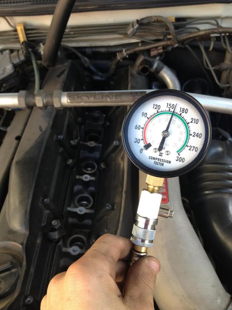

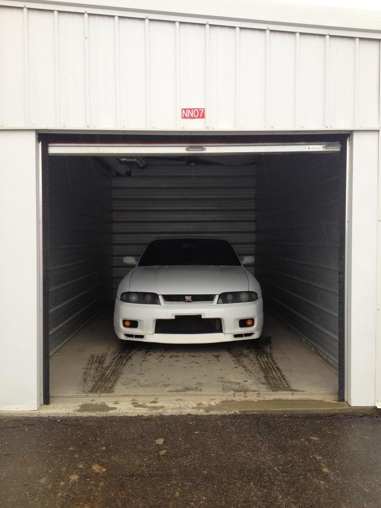

    Well just a couple of days ago the car went into winter storage!

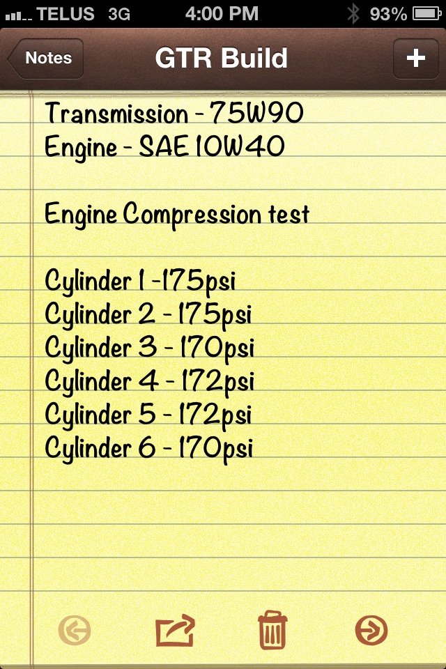

    So to prep the car for storage all I can think of was fuel stabilizer and disconnecting the battery, any other helpful tips for a car that's gonna stay sitting for about 6 months?

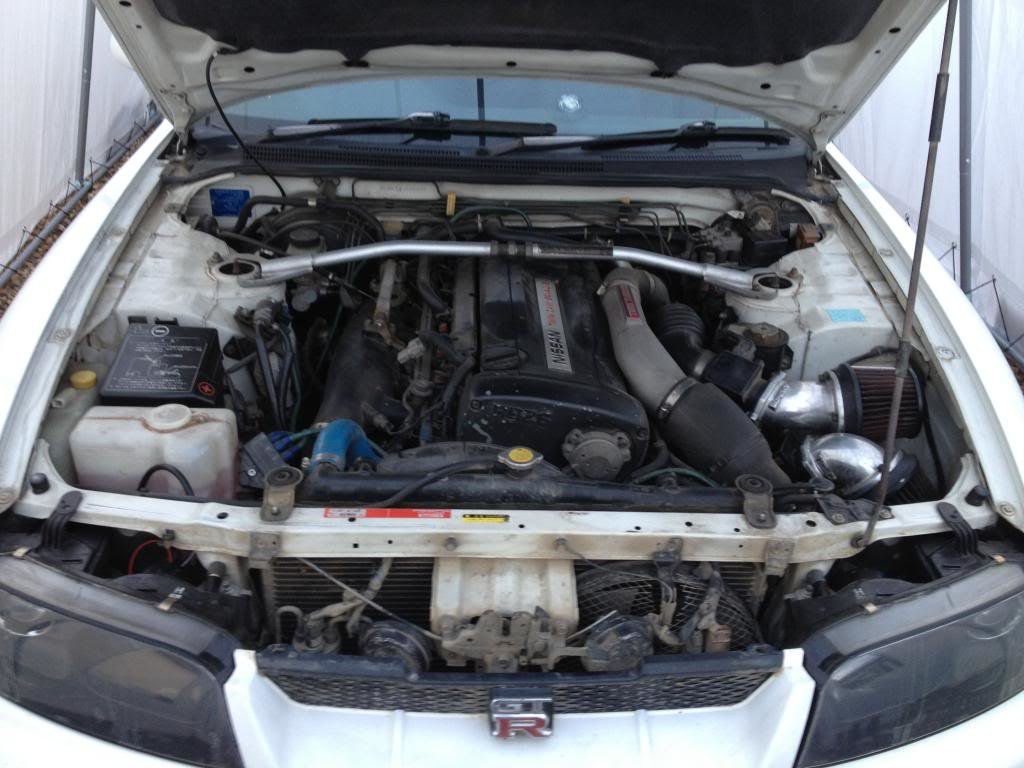

    So with that said got around doing a compression test on the engine to see what kind of life there is on the engine. Here are the results
    So everything came out perfect with no failing cylinders I can build up this engine up to its limit. Of course the threshold on the engine is known to be around 500WHP, surprisingly that's the goal I want but I'm pretty sure a stock engine won't last that long on that limit. So the goal on the stock engine will be 425-450WHP.
    I'm glad my little unit I've rented has enough room to build on the front end of the car! Excited to get into that engine bay!

    It is heated which is an awesome bonus for me, what do you mean by "put it away wet?"
    Edit: Nvm I gotcha lol the heated garage will get rid of all of that

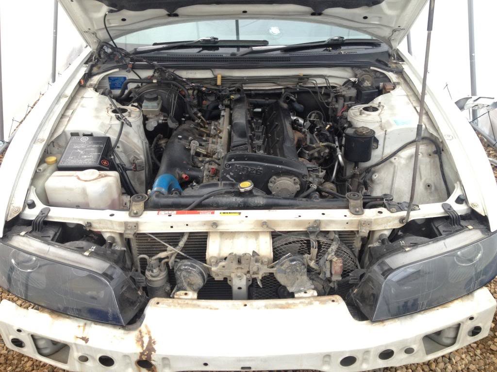

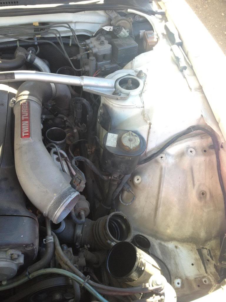

    Alright let the teardown begin! Trying to get this all done before the real cold gets here since my little make up garage is not heated.
    So im not gonna go into great details with the teardown and re-build just point out a few things, if you wanna know something fell free to ask.
    So anyways here's a couple days work on the engine got all of the electrical out, Intake, fuel injectors, fuel rail, random piping, heat shields, crossbar, throttle mechanism, drained radiator & the front grill/bumper. I'm gonna need a hand to get the turbo's out and same with the intake plenum so until then i'm on hold.
    Before:
    After:

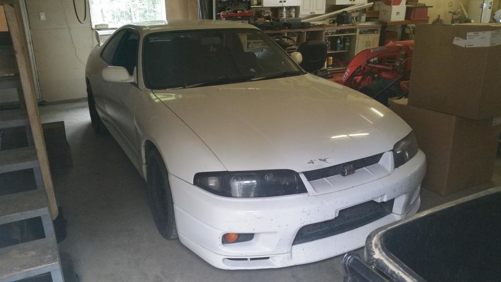

    despite not doing anything to this thread for almost a year the car went back together stock for this summer because I wanted to drive it. So I did exactly that and had one hell of a time with it this summer until I blew the front diff....
    I blew the diff maybe a good month and a half ago now and in order to replace the shredded gears in the diff the engine has to be yanked out.
    So I managed to get the car in a garage for the upcoming winter. it's still summer out which bums me out because I can't drive my car. On the other hand the real build can finally start with the engine being re-built and the front end getting some touch ups. I'll post some pics later because I have started tearing down the car for this

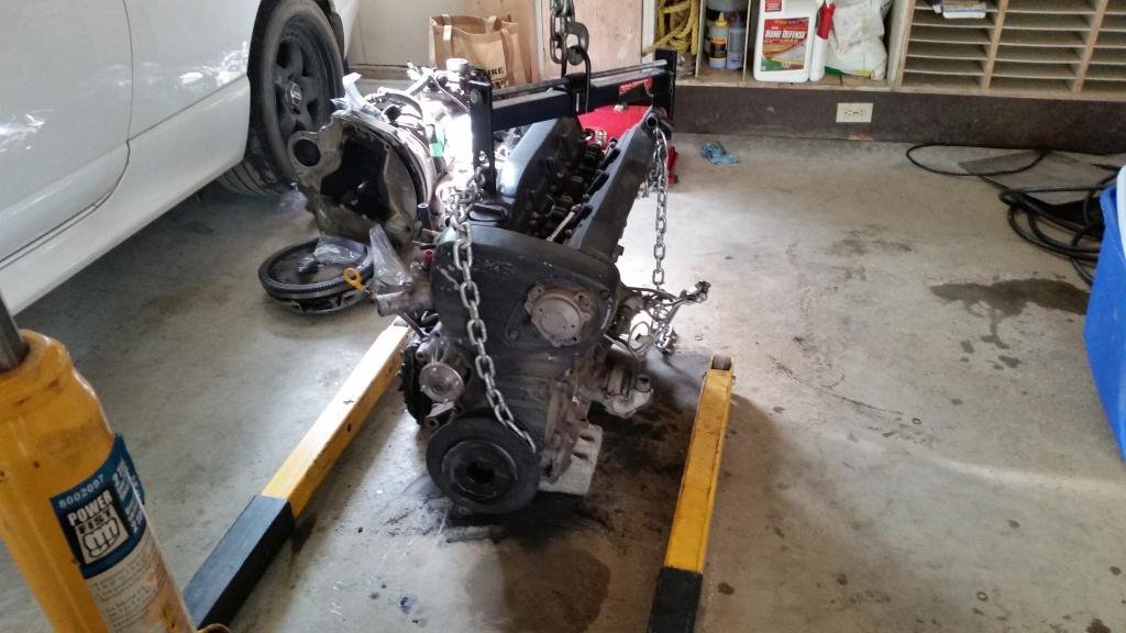

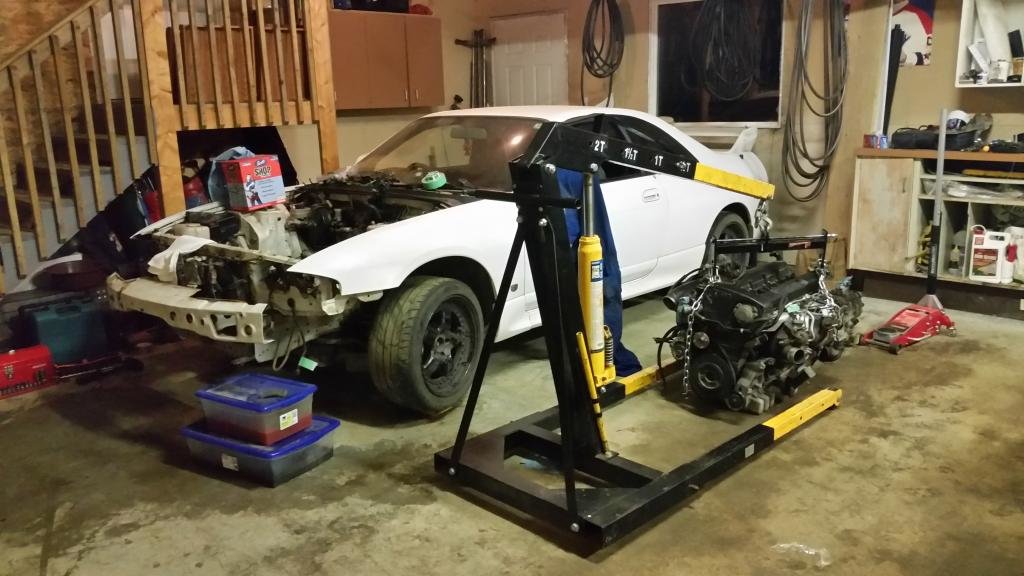

    Update (literally a year later....)

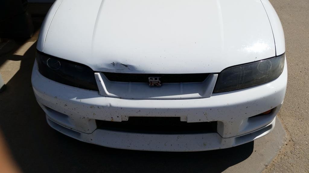

    Anyways as mentioned above after the past winter months I threw the car back together stock. The summer was fun! Raced my car on a real track and met up with other local around town
    Then people cannot drive and got this nice dent
    So I now have a carbon hood on the way. After a week from that happening I blew my front diff from a hard launch so I decided to pull my engine. The car is now outta c omission for the rest of the year till next summer.
    So now I have the car sitting in its forever home for a year

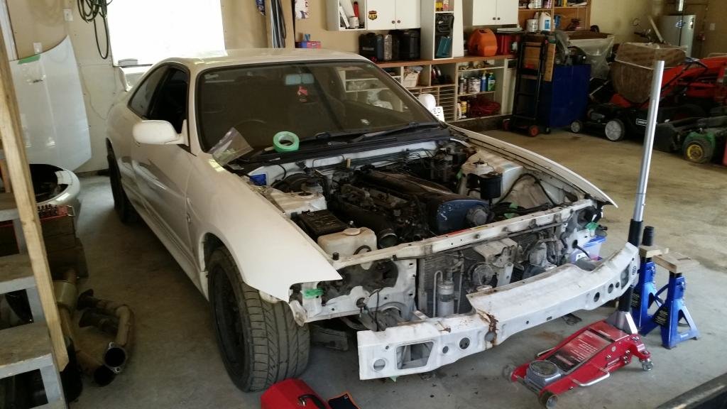

    Accessories all stripped off
    Engine being pulled
    Engine safe and sound ready for cleaning and getting everything else off
    So there you have it, that's as far as I am with the car. This us not a dead thread :p

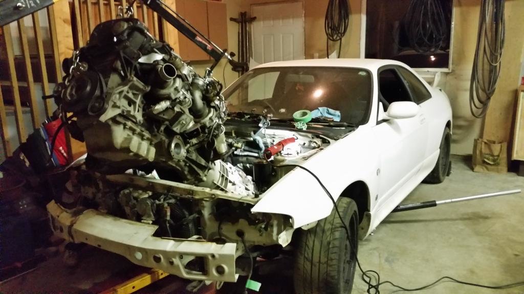

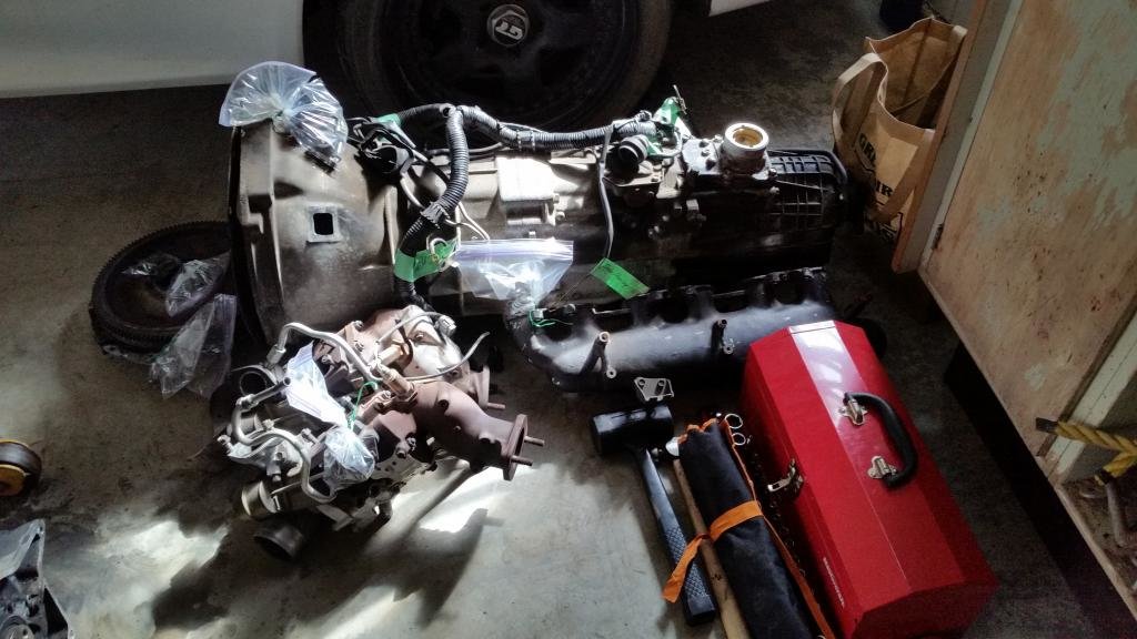

    Some more news with the skyline

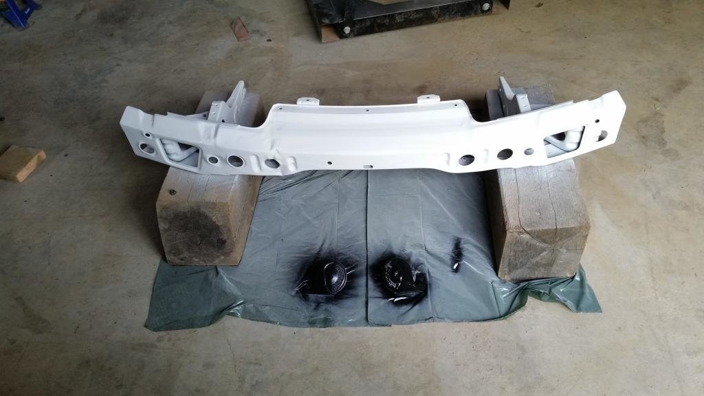

    Got the engine bay all nicely cleaned up and got the front bumper bar off since it was rusted pretty badly
    So with the bumper bar off fixed the rust issues by sanding the rust off and painting it back over with rustoleom white paint. It pretty much looks like new again! Did the same for my horns as they were looking very rough

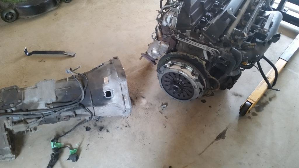

    Now back to the engine. Got the transmission disconnected off from the engine
    Then came the engine strip down! So this included fuel rail, injectors, intake plenum, the two turbos, exhaust manifolds and all the oil, coolant and vacuum lines
    And here it is all off the engine sitting beside the transmission
    So that was last weekends work. Never got the engine on the engine stand yet because I don't have long enough metric bolts to go into the block. So this was as far as I can go before it gets mounted. Work for another day!
