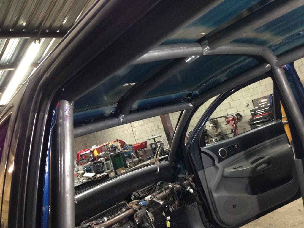

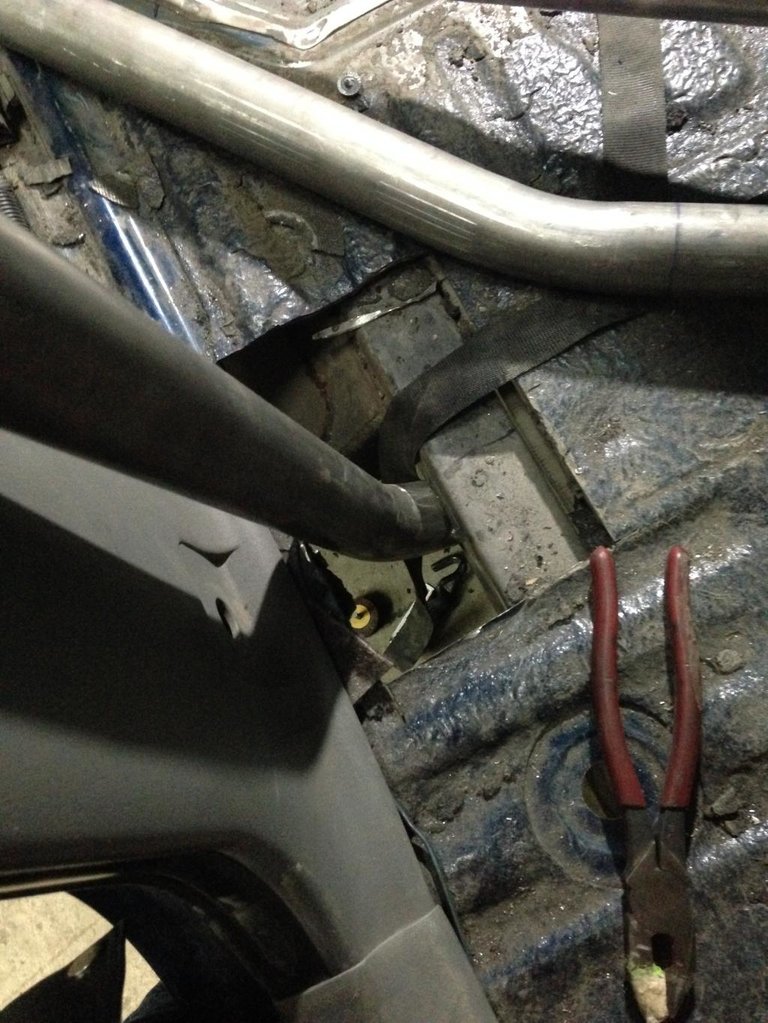

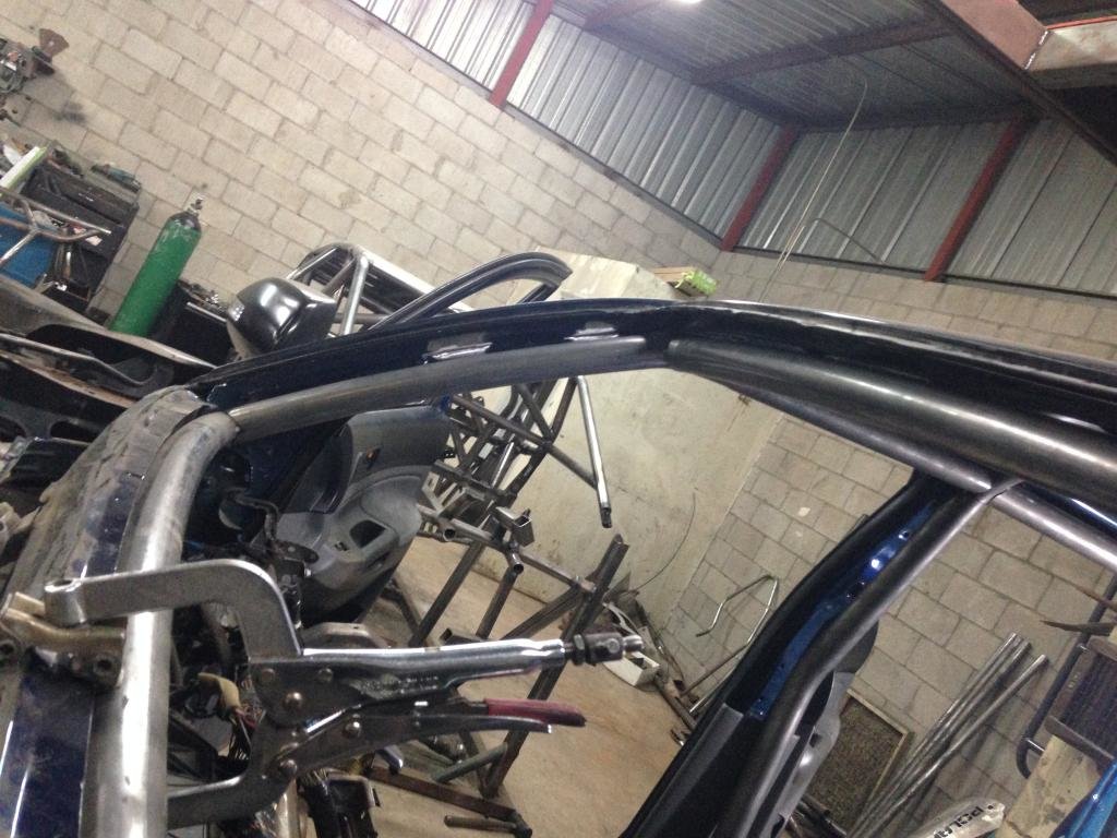

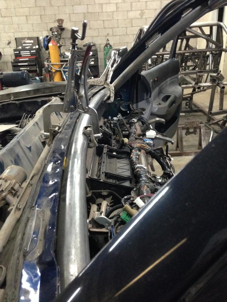

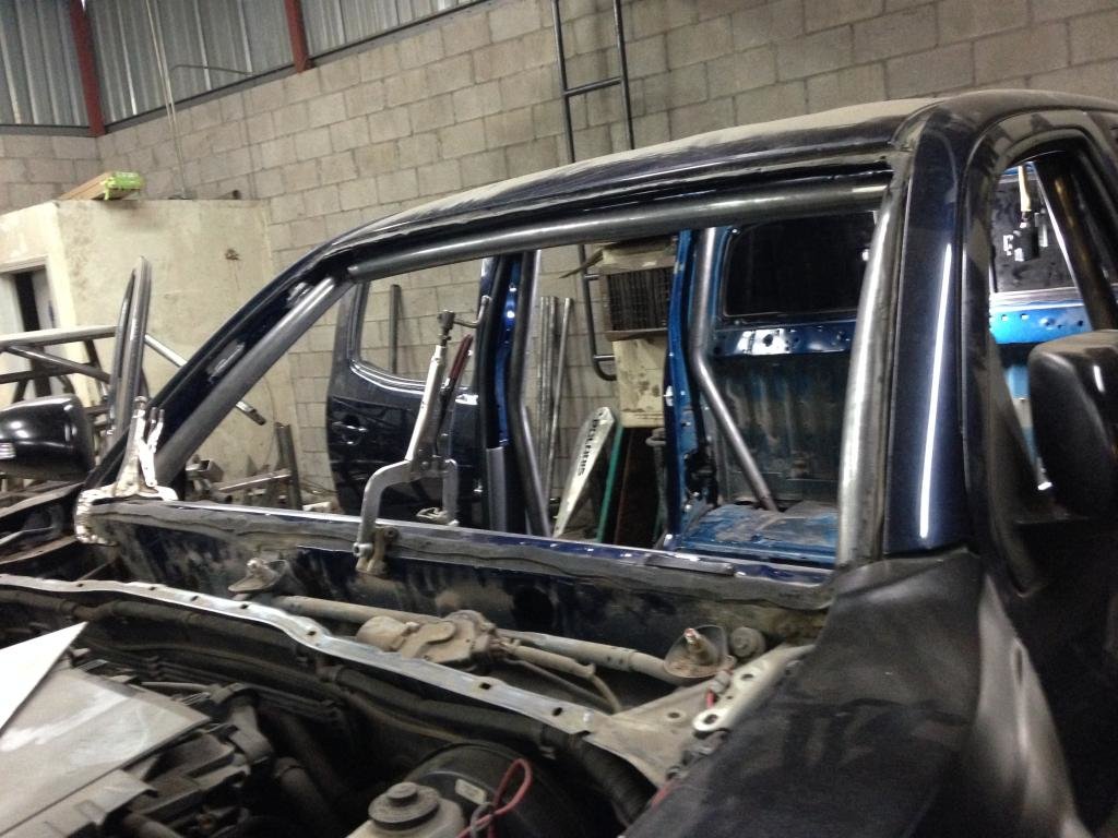

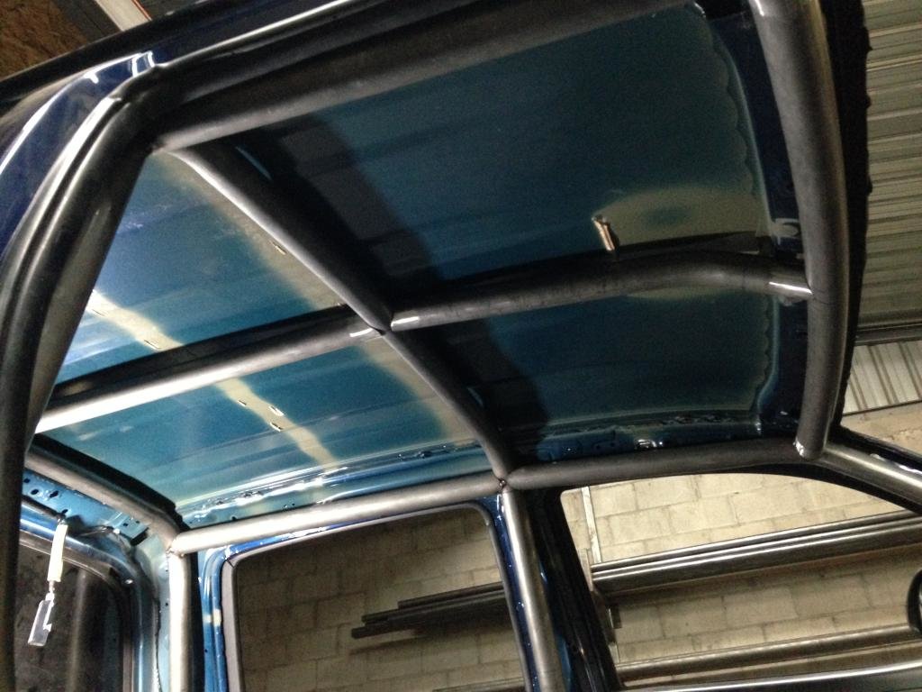

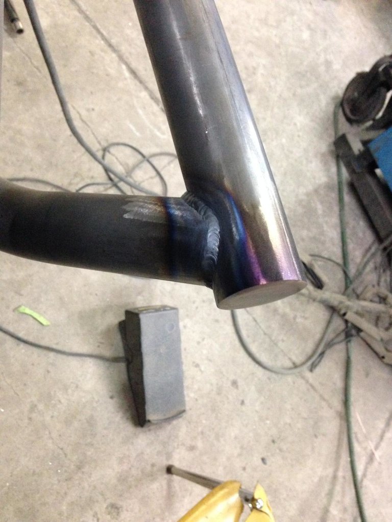

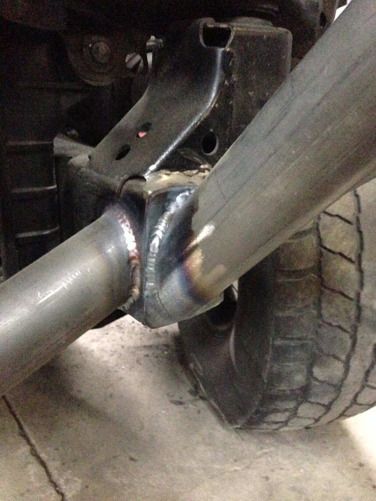

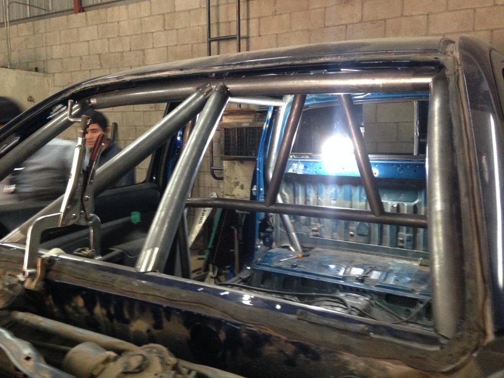

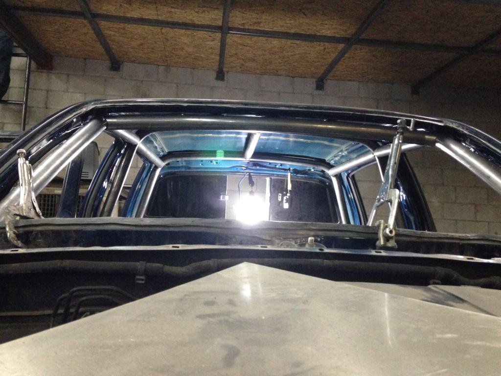

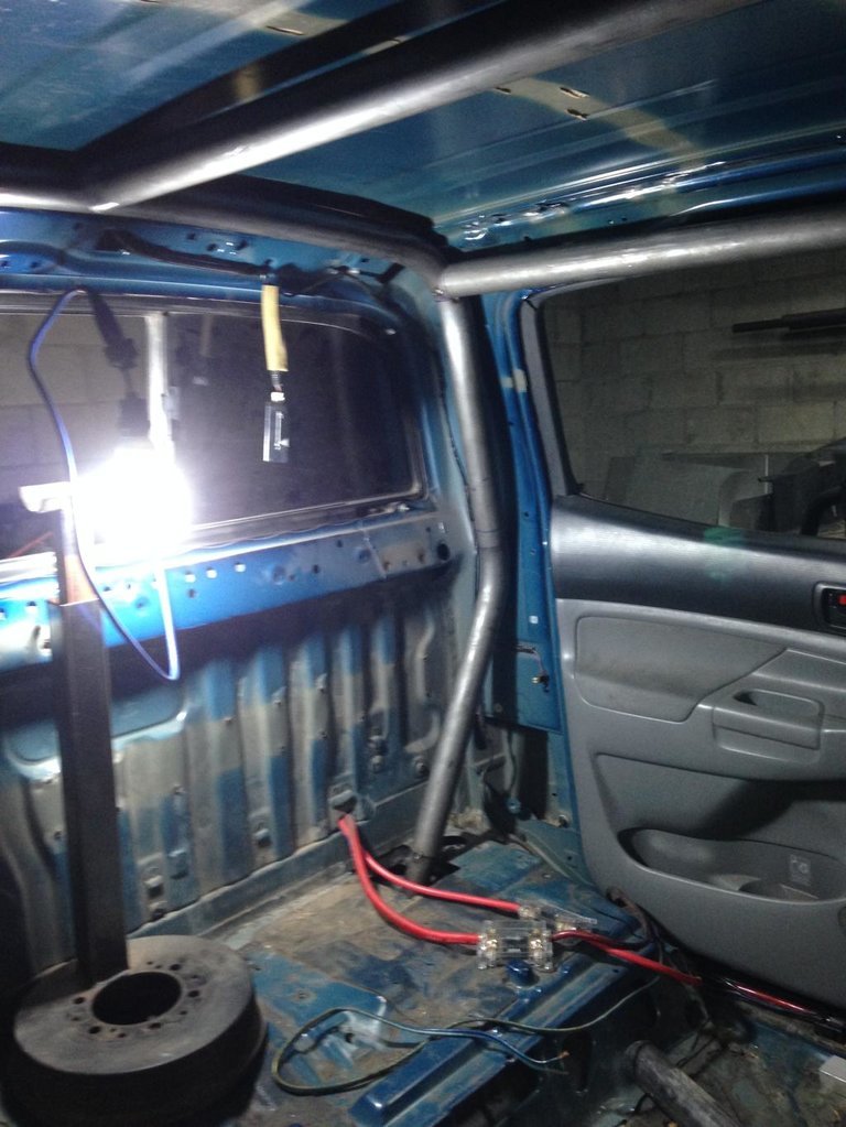

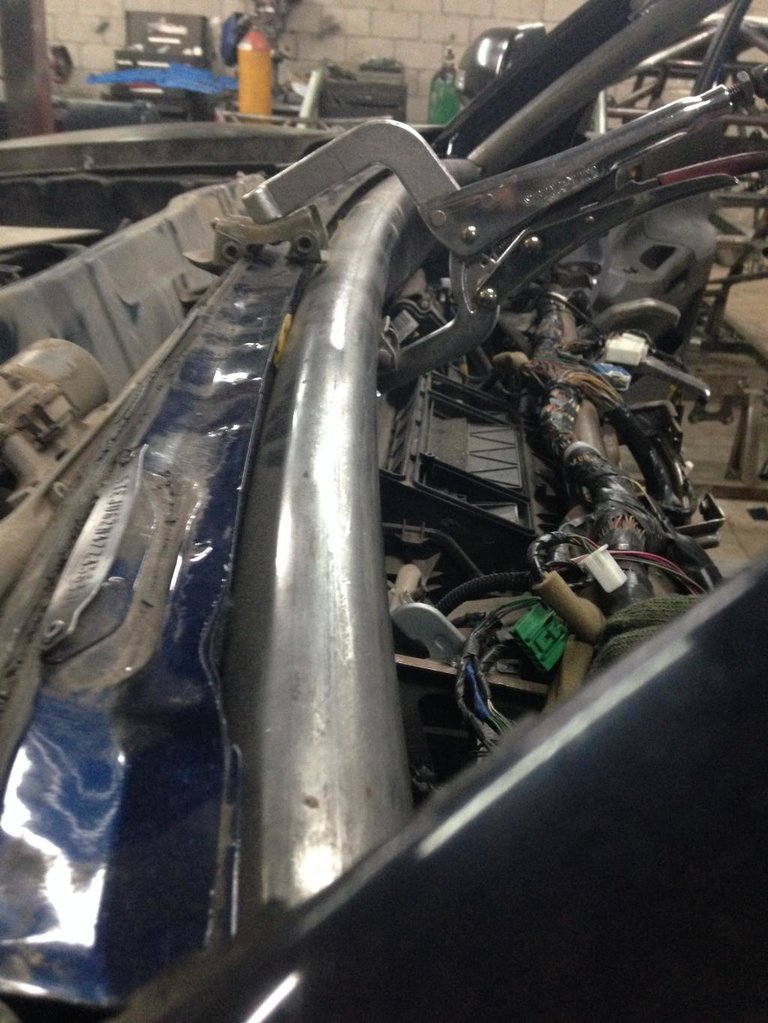

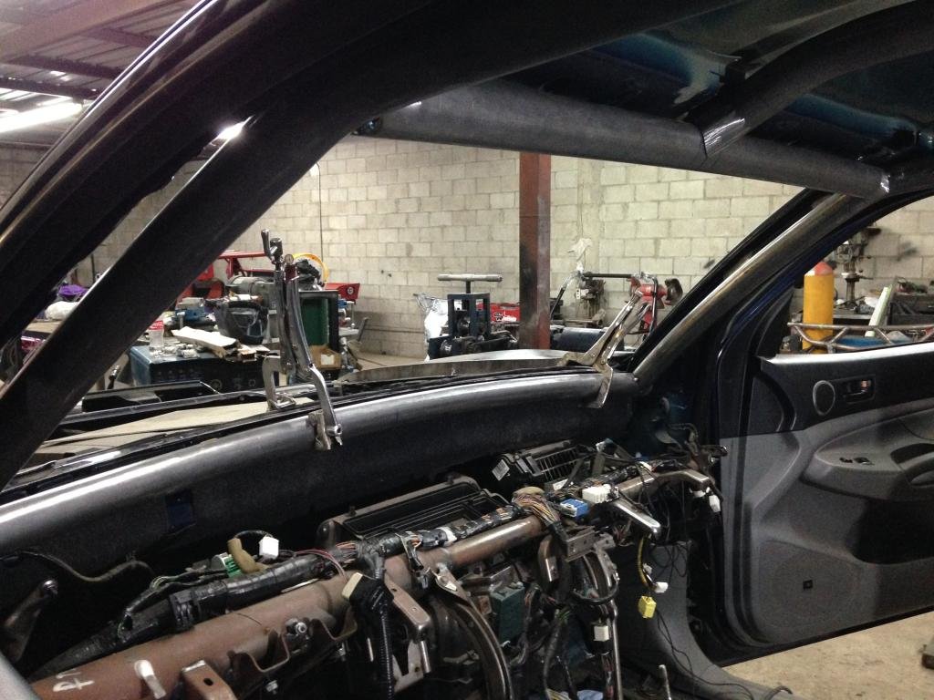

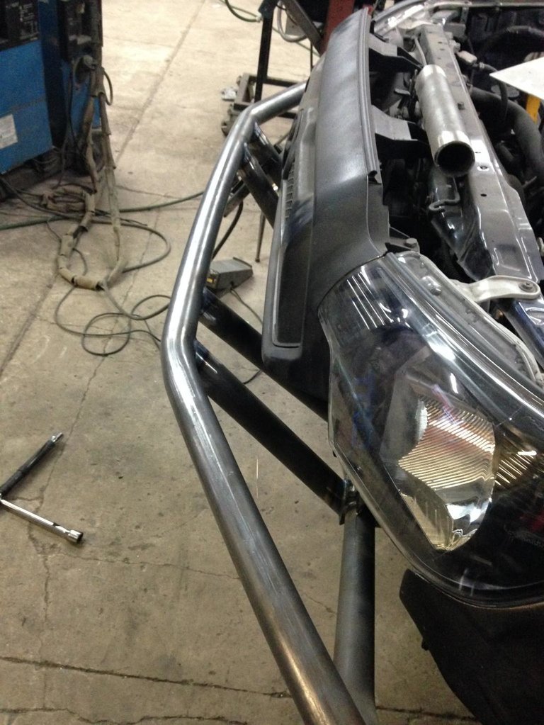

    Some cage work pics, almost done! Windshield top, bottom and pillar rolled tubes, roof top rolled tube also, just missing rear of seats tubes and 4 roof tubes.
    Bumper all tig welded

    You throwing sound deadener inside the cab?

    You're really pushing me to get a cage now x.x

    Yup, already have 2 boxes of shock industries sound deadener :)

    So what ends up happening with all the interior trim panels and roof liner? Does it all get modified and go back in or do you end up doing something completely custom to clean everything up on the inside?

    I'll do everything custom for a cleaner look, vinyl headliner and hard carpet

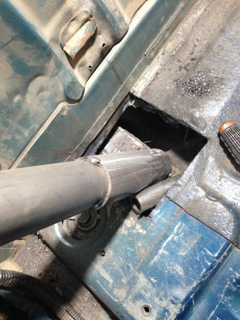

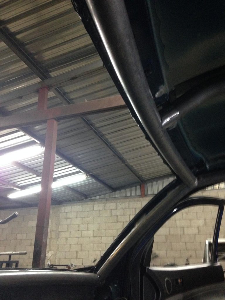

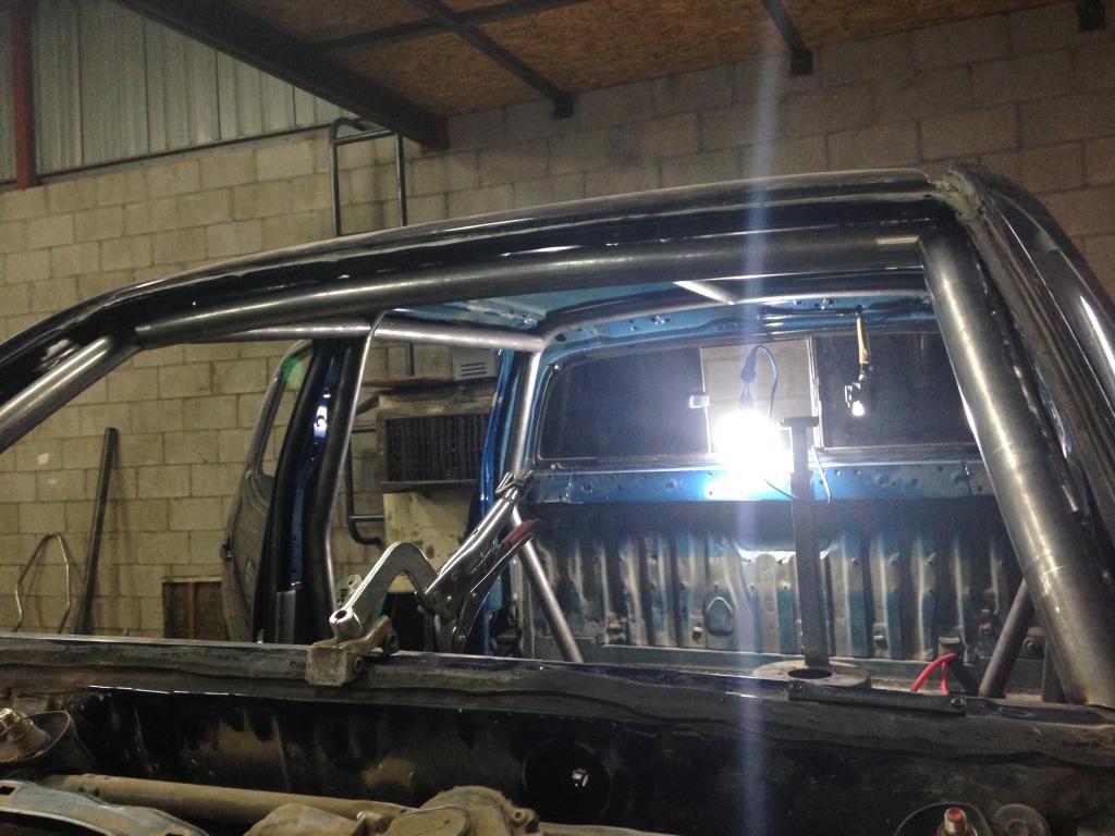

    http://www.tacomaworld.com/forum/2nd-gen-builds/227832-my-never-end-build.html

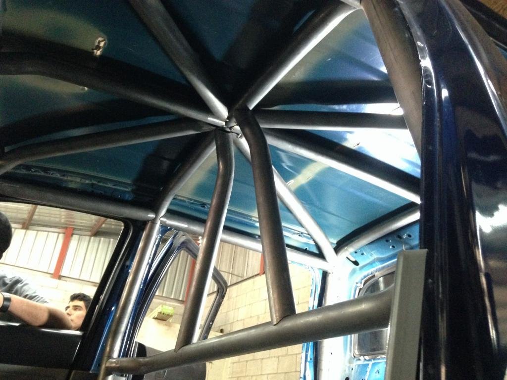

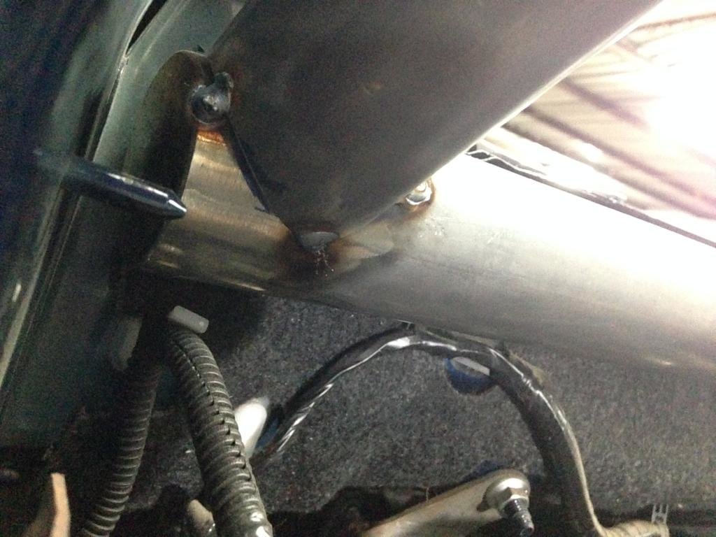

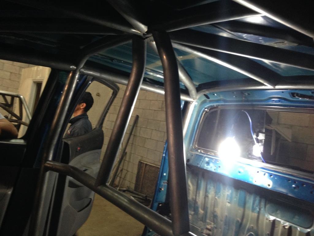

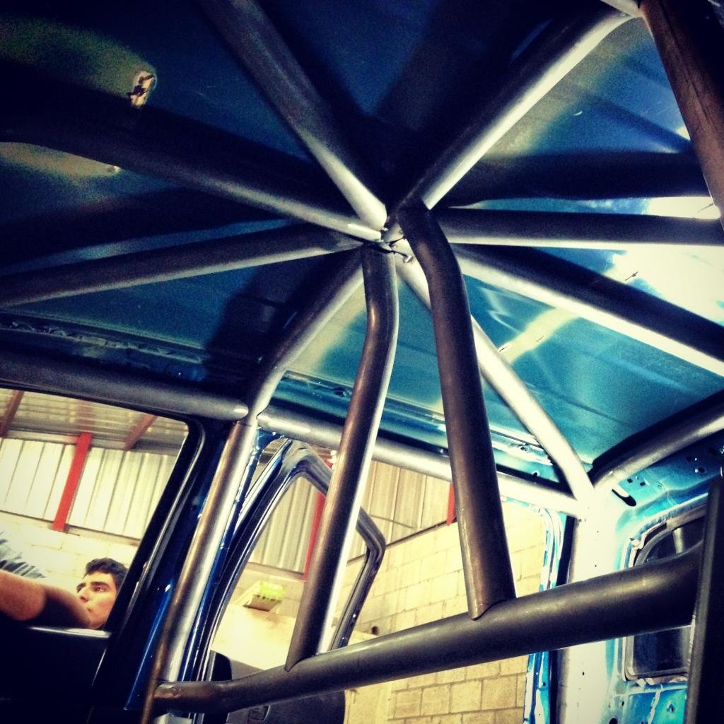

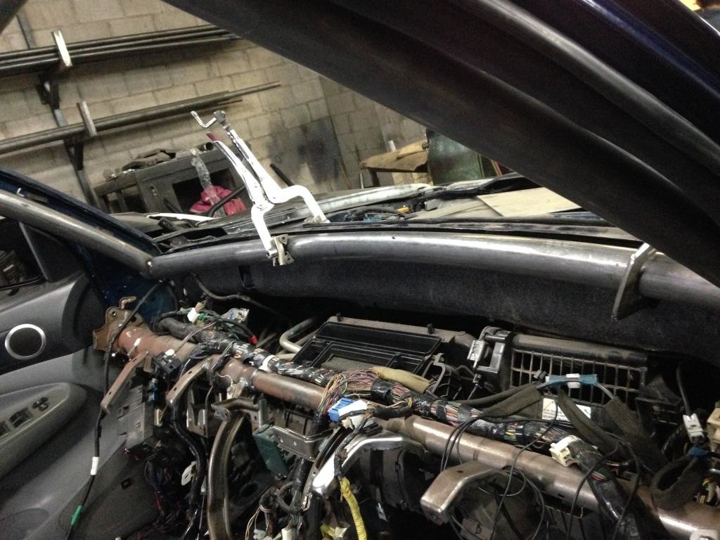

    some cage updates

    Nice bro! U end up having enough steel

    Thanks! Still need to fab the engine cage so I'll find out then

    Why the v bars in front? Never really understood the need for them.

    any reason that the frame is not plated where the cage makes contact? Also, any reason you didn't build off of the frame to land the cage tubes on instead of on top of the frame? Would have been just a little easier without those last Benz and that awkward angle it hits the frame.

    They add a lot of strength. If you kick sideways at speed and roll, the A pillar takes a whoopin'. Another reason...trees. I know most of you are dezert dawgs and that's not an issue. My neighbor had a caged jeep on 40's, no V bars, and happened to slide off the road and down a steep bank at low speed. He endo'd just right into a tree, collapsing the cage in the center. He did not survive. http://www.kvewtv.com/article/2014/nov/17/single-car-fatal-crash-umatilla-county/
