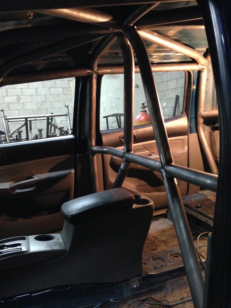

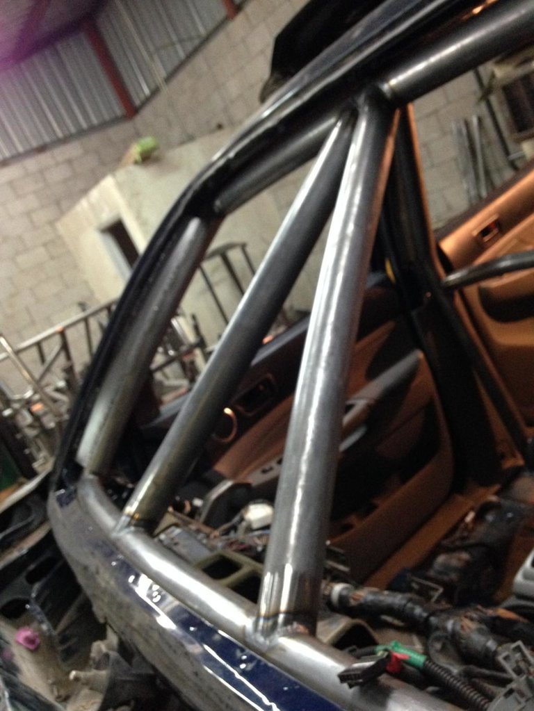

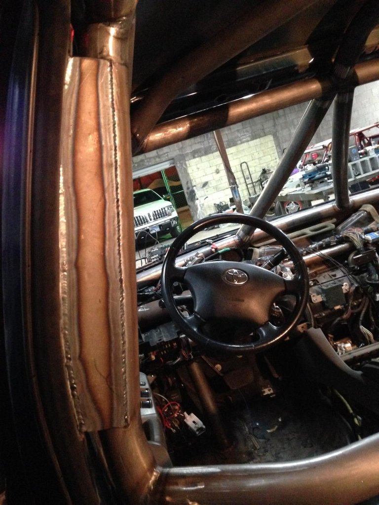

    Frame mounts are not finished yet, as you can see its just tack welded. Cage will be dropped first to weld the top part and then frame mounts will be fabd. Under cab frame will be boxed before welding in cabmounts. That "awkward angle" is to give strength to the pilar amd land on the frame mount directly that will be inside of the frame. ;)

    :eek: super beefy mounts!! Nice dude :thumbsup:

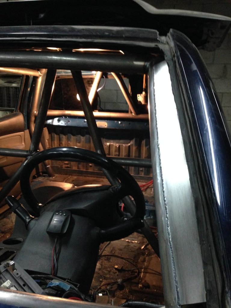

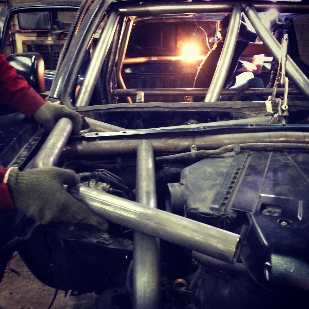

    nice and tight ;)

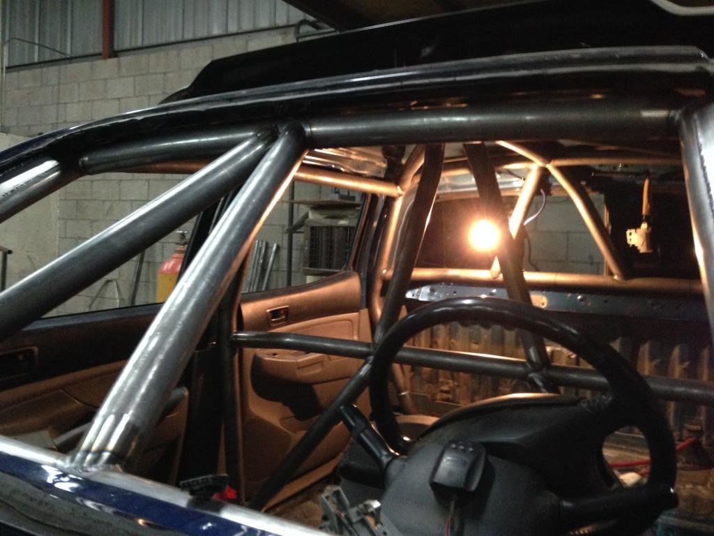

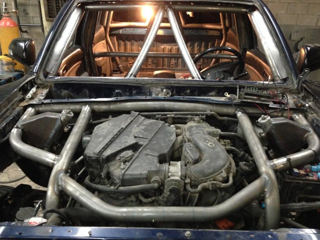

    Started with the engine cage today

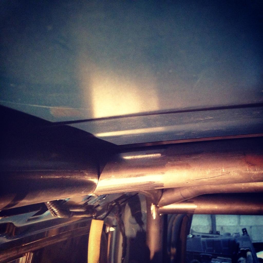

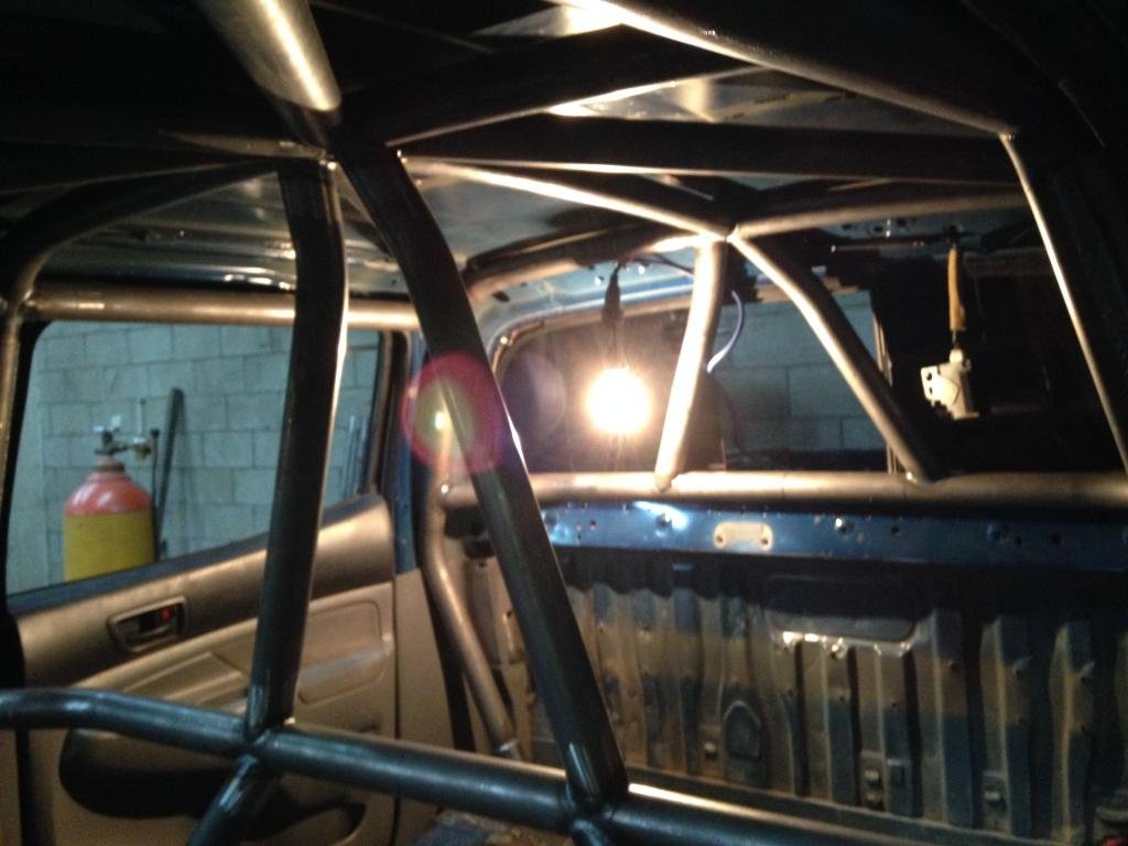

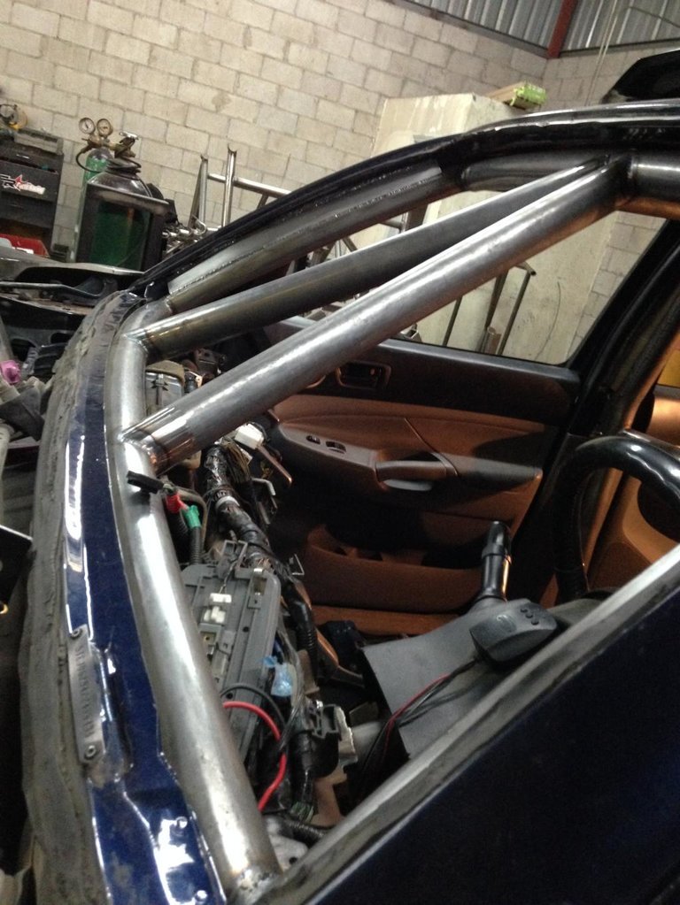

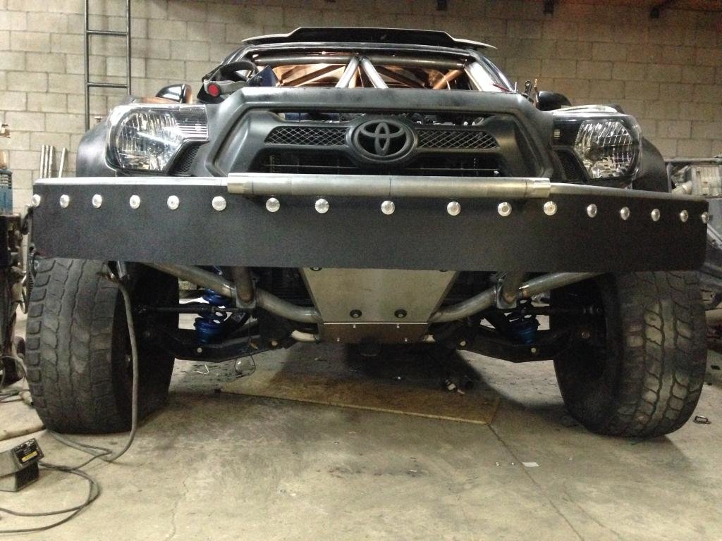

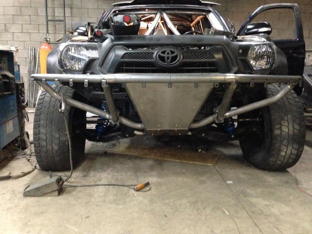

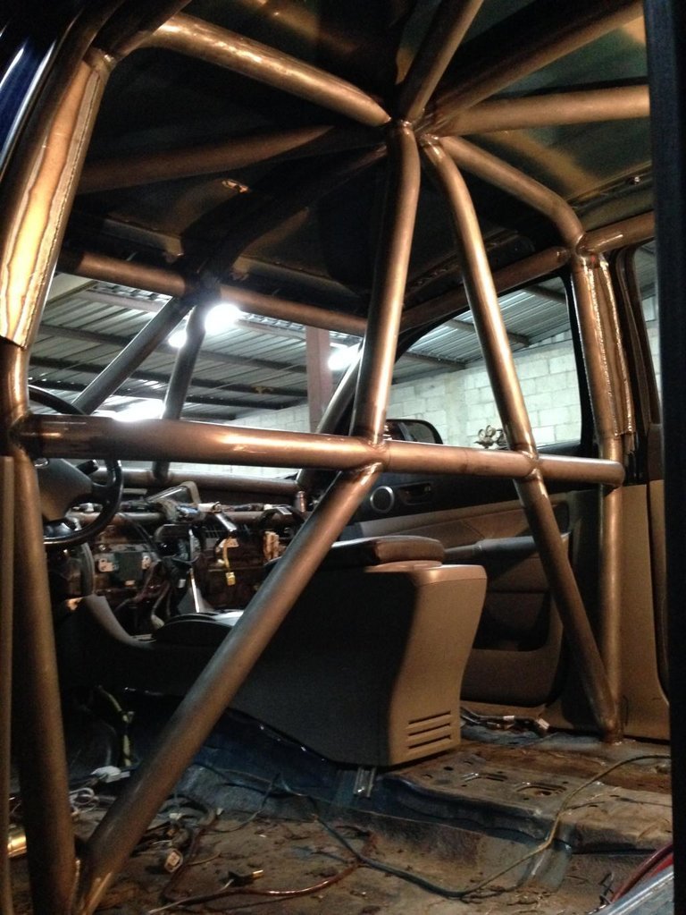

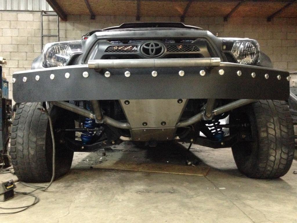

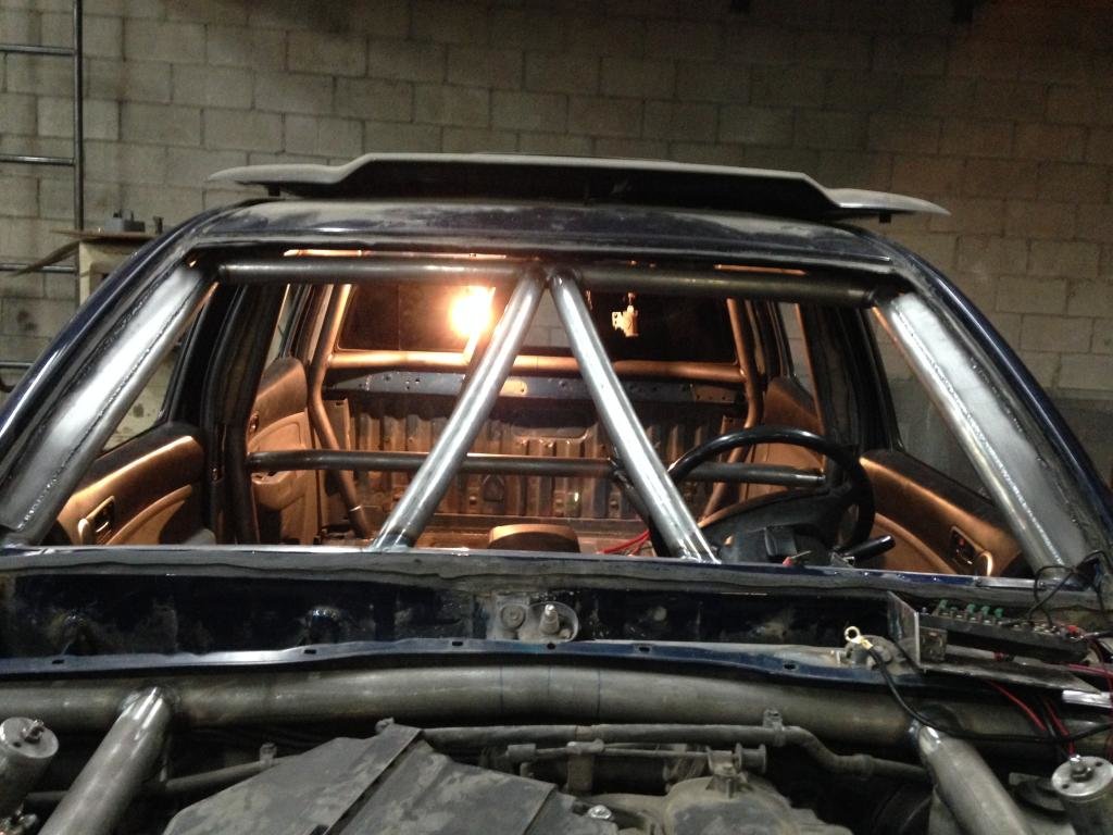

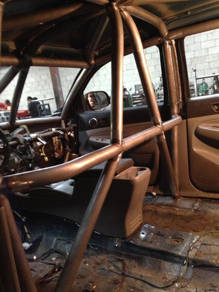

    Finished bumper, engine cage and roll cage!!!! :woot:
    With valance
    Engine cage
    Roll cage
    Chromoly plates
    Got a little excited with pics :D

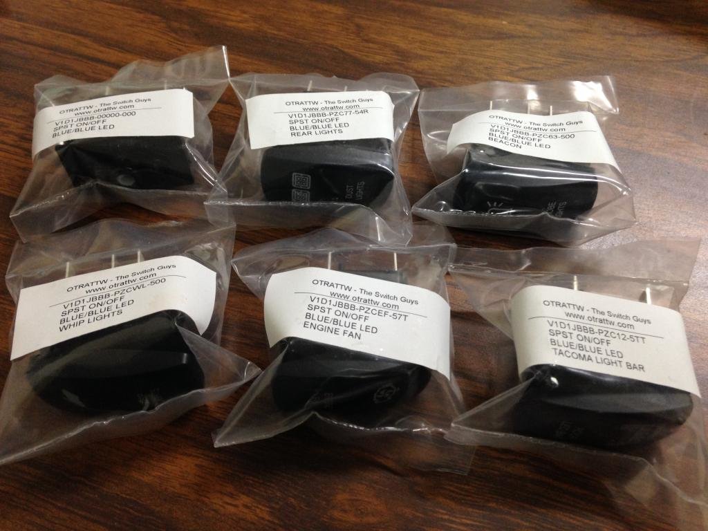

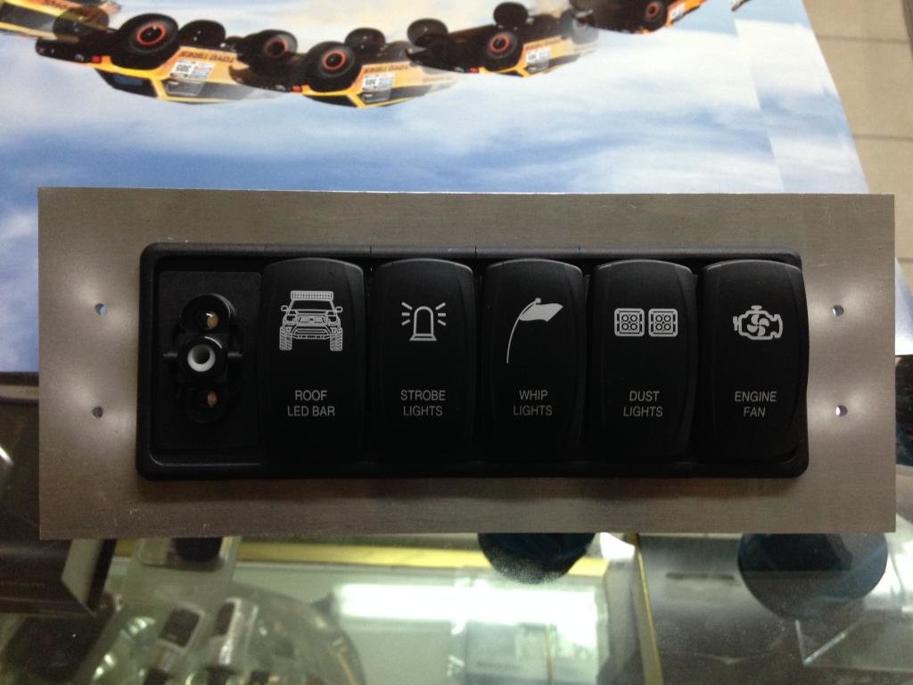

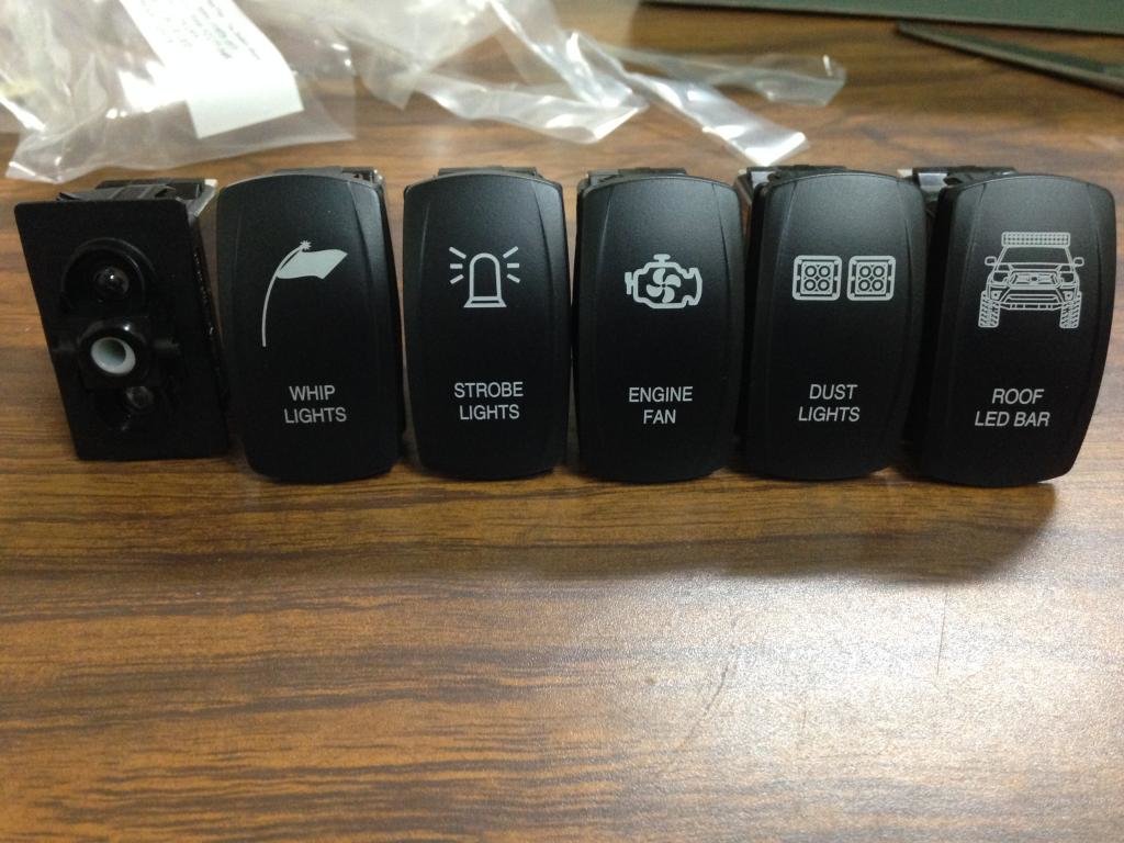

    Got my switches for the switch panel :woot:

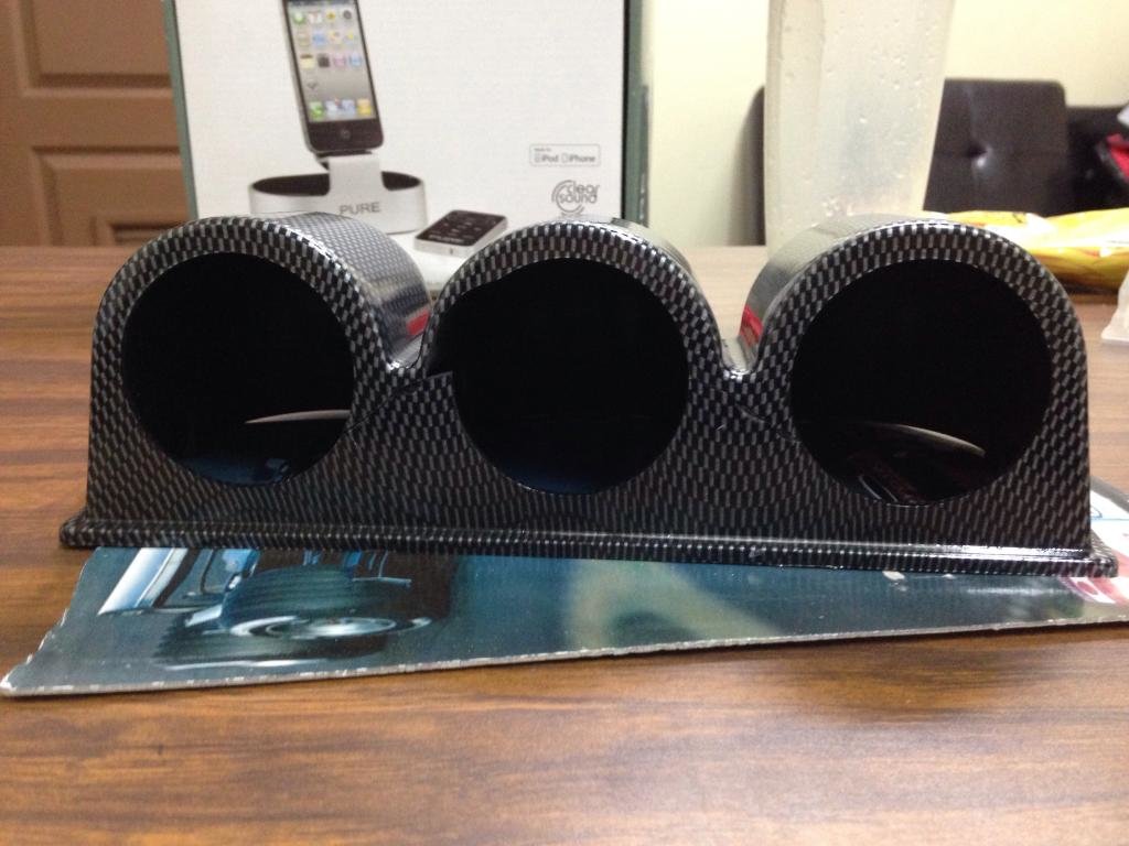

    Ordered this gauge panel for the supercharger and it also arrived damaged, something tells me I should get the sc lol
