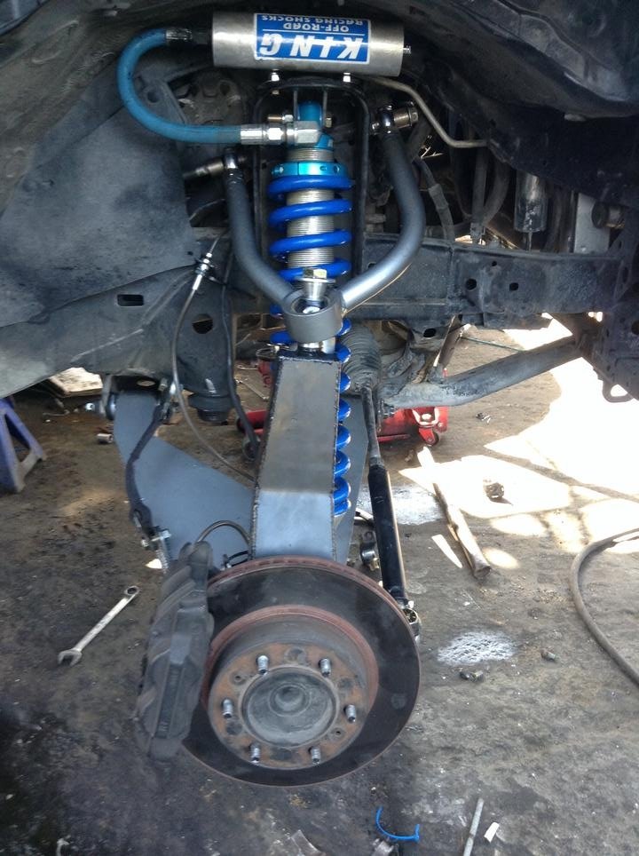

    Finished Loooong Travel, just need to get it aligned tomorrow morning

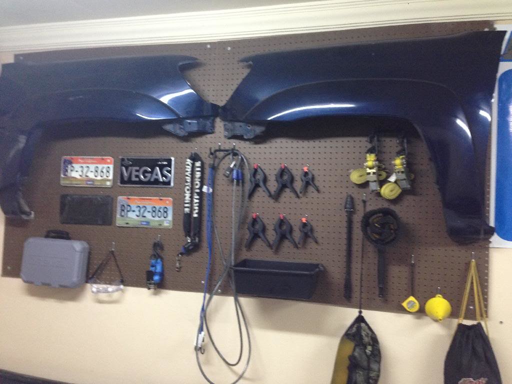

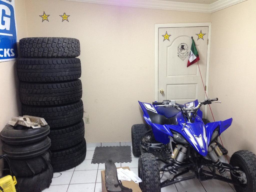

    Had some free time so I organized the quad/tool room

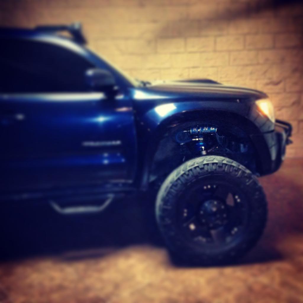

    ENGAGE 4'' LONG TRAVEL

    probly going to want to relocate your resi's. upper arm might kink the hose, and cause it to crack the fititng.

    when checking the travel the UCA doesn't touches the hose so that was the perfect place for it, the hose is to short to mount it in another place

    Shoot for around 4* of castor at ride height if possible or you'll be all over the road. Also get hydro bumps or mount your stock bumps about 3/4" lower because your coils will bottom out first and bend your buckets like a lot of the engage trucks.

    Getting hydro bumps installed next week, do I need 2'' or 4''?

    I'd get a 4" and shorten it to 2" so if you ever deiced to bump off the upper you can re use the bumps. 2" bumps have a shorter body

    I'll get a 4'' then, thanks. Any other helpful things I need to know? Still learning things about long travel.

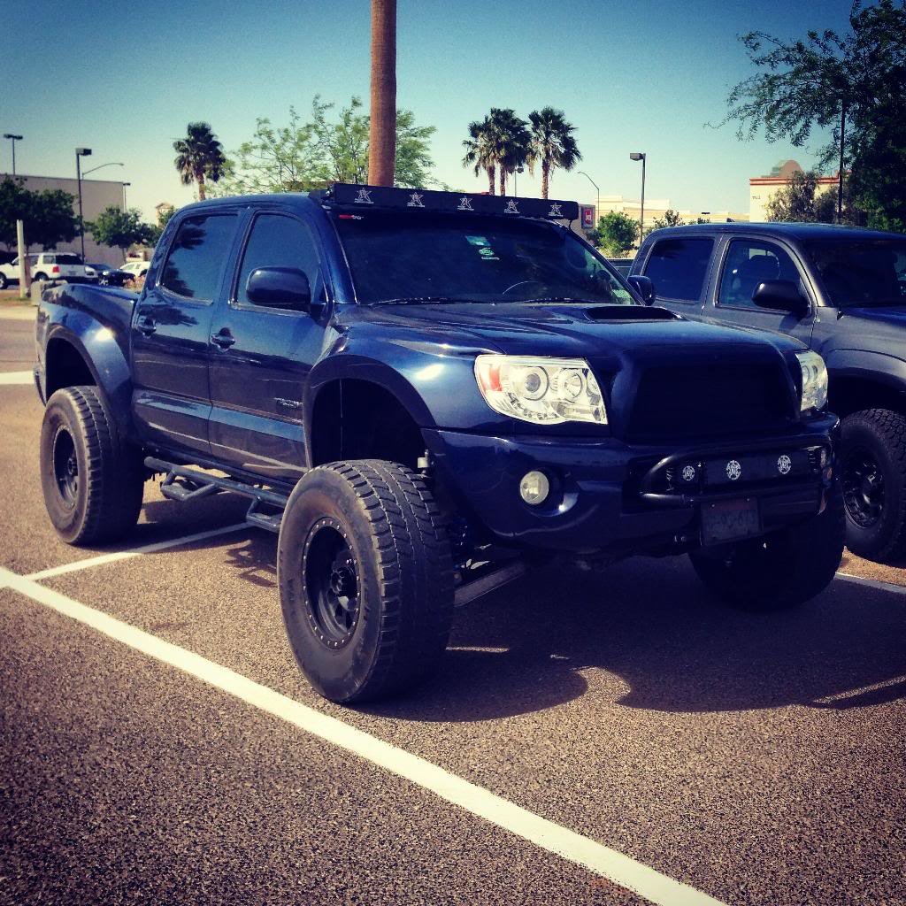

    Got new method wheels and BFG baja

    Engage Long Travel 6 over with race spindles. 2.5x8 sway a ways wrapped in King Coils.
    Hey bud, is that scoop functional?
    Sick build btw.

    Yes, I opened it up
