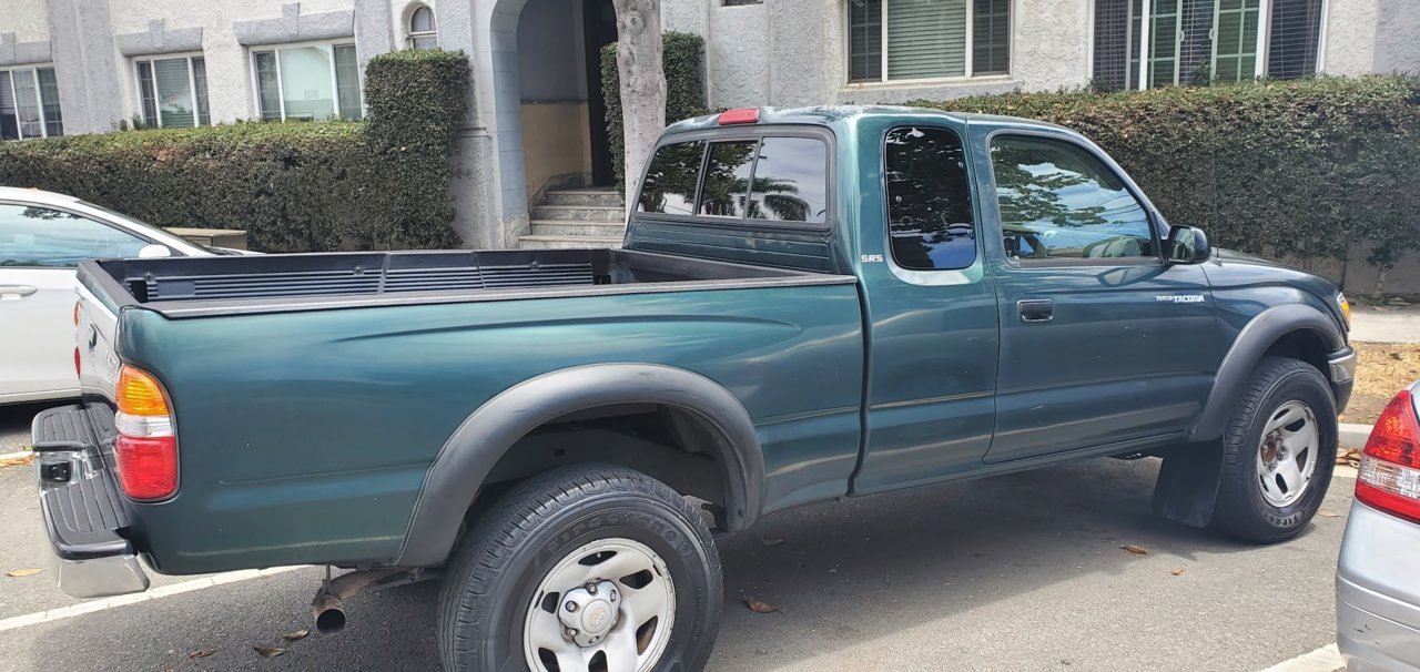

    2004 Prerunner SR5 2.7L 2wd Xtra Cab
    Just bought a 2004 Prerunner SR5, 2.7L 4cyl, ~210,000 miles, Xtra Cab. Single owner, looks like it was serviced regularly at a dealership from the records on Toyota Owners website.
    I'm in SoCal so the market here for these is nuts right now. Bought it without a detailed check as it was a private seller who had multiple offers and I didn't want to lose the opportunity. I honestly don't know a lot about vehicle maintenance. Mechanic said it sounded good, ran fine, no visible major issues, no visible frame rust but it was like a sub-5 minute inspection he did for free. I want to take it back now that she's mine with a well prepared list of things that definitely need to be checked to make sure this truck lasts a long time.

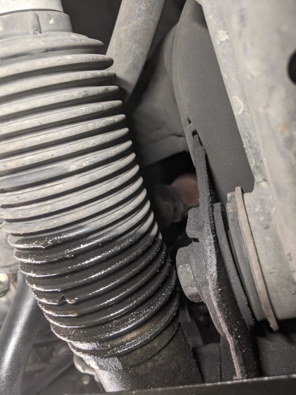

    -Steering Fluid leak? - not sure what this is, pic below

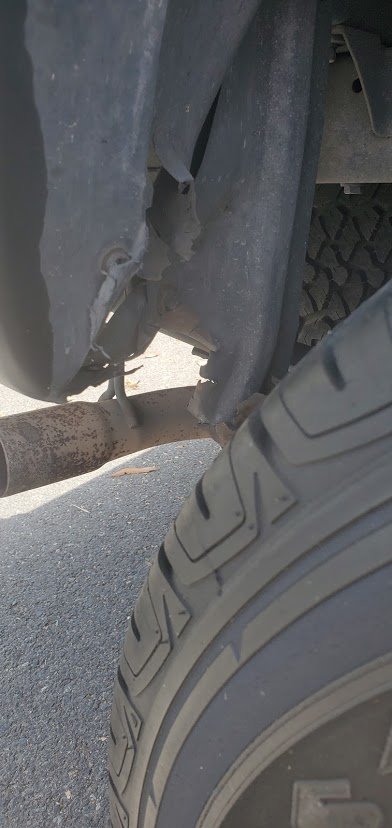

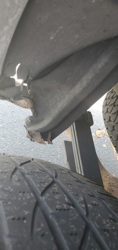

    -Piece behind rear wheel is a bit mangled - not sure what that is about. Pics below. Replace or is this a sign of something more significant?

    Fluid Leak on this part? Steering fluid? Previous owner says it has been like this with no issues and not dripping or anything for over a year but it worries me.
    Some missing chunks by the rear wheel well:

    That leak on the steering rack boot/inner tie rod boot means you likely have a leaky seal in the rack, that will eventually mean a rack replacement but it could probably last awhile longer.
    Frame looks fine visually
    The rest I imagine your mechanic can give you a good idea of, but its safe to say that most of these trucks by now need a good suspension, ball joint and bushing refresh if they haven't had one already, due to age/mileage.

    Those rear wheel well liners got chewed up by something, maybe road debris?

    Check the new rack n pinion for leaks befor installing (usually remanned part) and save the box for the old one for core ($300)

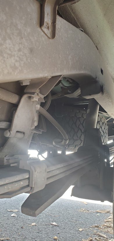

    Your 7th picture shows a rear tire that looks very worn. I’d check the tread depth on all of your tires and rotate or replace if needed.

    Thanks for the suggestions. Edited list to include fixing the leaky seal in the steering rack (replace rack and pinion?) and rotate or replace tires depending on how worn they are (probably very worn). Will get her into a mechanic after the holiday weekend.

    Looks like you may need a set of tires.
    Tread looks a bit lean in pic #7.
