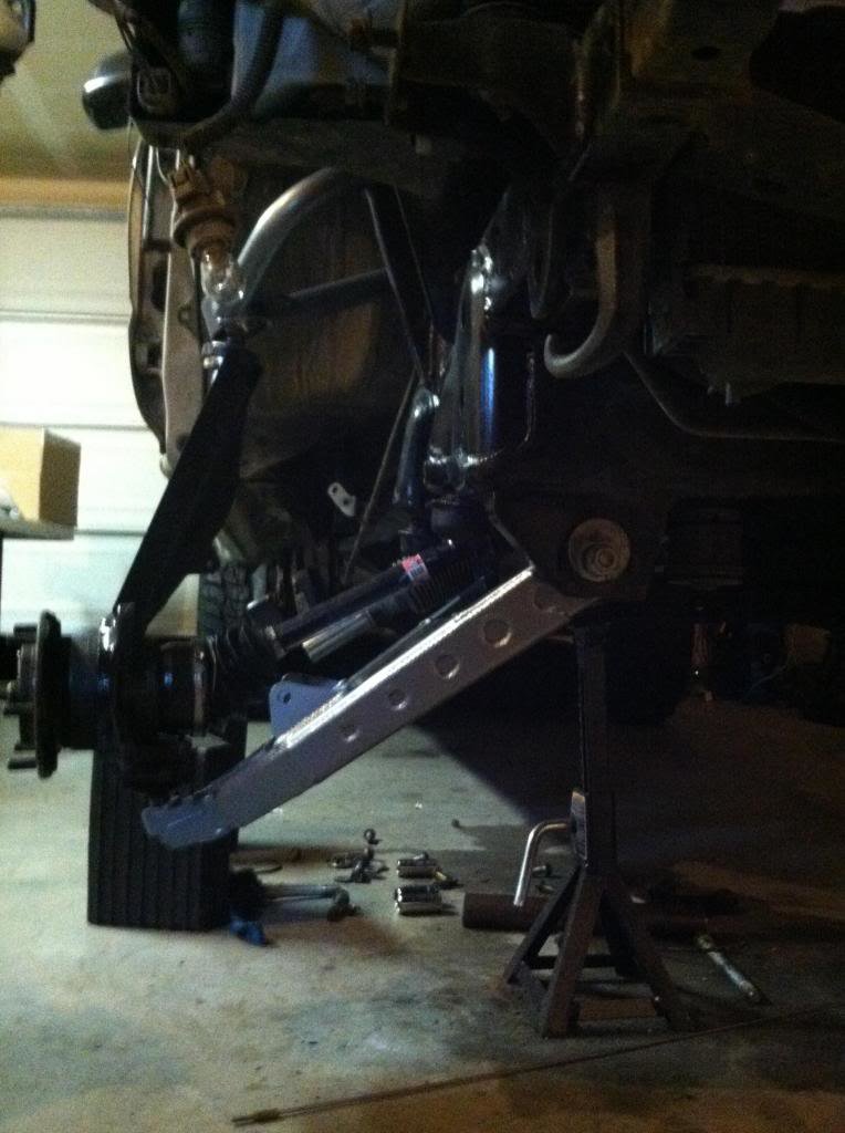

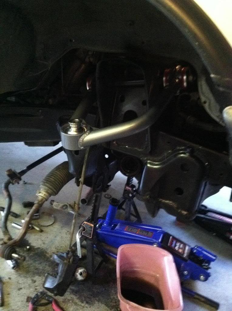

    Sup guys I got my 1st gen back in 01/2014 and this is how she sits now! I wanted to go LT for a while but I like a lot of tight rocky trails up in the sierras soooooo 4x4 LT it was and God damn am I happy with my setup! Enjoy the pics and build!
    A211505F-C186-4D6C-988D-FDBAE9DFEF69_zps_16f6df21c869e7cf66b2591599fedafec3546b6d.jpg
    image_zps5a5754ff_bd023bd9be684a4c672c9fbc8e158a89bb6766ce.jpg total chaos here I come!
    image_zps4d77a6ce_570cdd2b6eb86730e1ca3b2f80746a6d23db79fe.jpg. Spindle gussets welded and painted
    Finished modifying the tundra axel CVs and now installed with spindles
    image_zpsda6b0649_9e1625e7257d7b2c8a159cb6a5c94d47a665c8bf.jpg. Damn these LCAs are soo beefy
    New brakes, brake lines, and welded in my straps! Coilovers are being put together at fox as we speak!!
    Here are some of me cycling the suspension! It's not down to full droop so it can actually droop about another inch and a half but this got me stoked to get it finished!

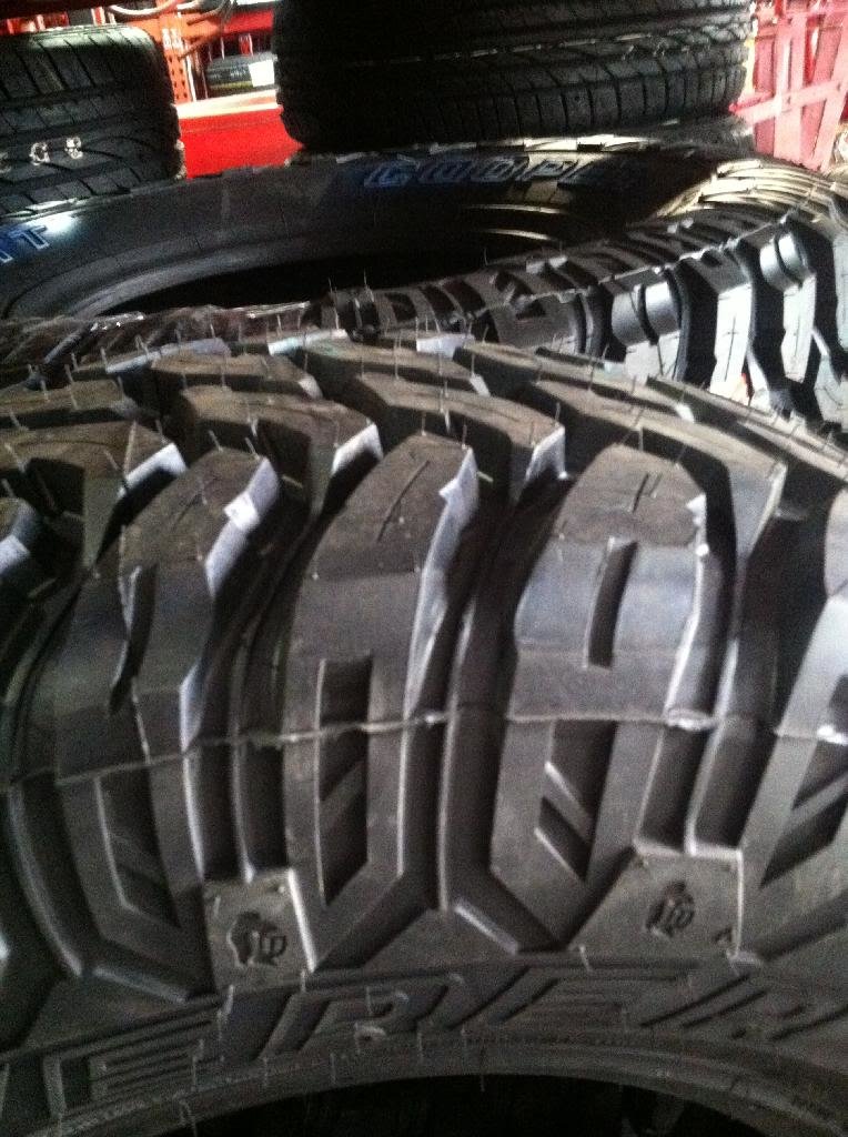

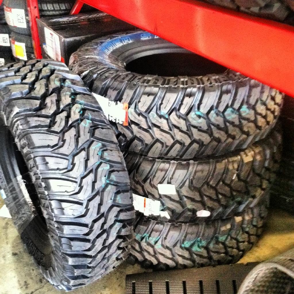

    I decided no on kumho tires I was on a budget when I got them, so I changed out and I'm gunna run cooper STTs they seem pretty lagit and have a similar pattern to Mickey Thompson Baja mtz which I love. Has anyone ran these and what do you think!!? 8009AD83-6200-4EC6-A16F-6C9DB9CF6CF6_zps_e2764b444a3897ab9f6c778fedab64e36d0d0277.jpgFE890289-A50C-4AF0-B224-5BA6E8AD178E_zps_2d85a121168ce066fcb35cec6116b00d54465ea7.jpg
