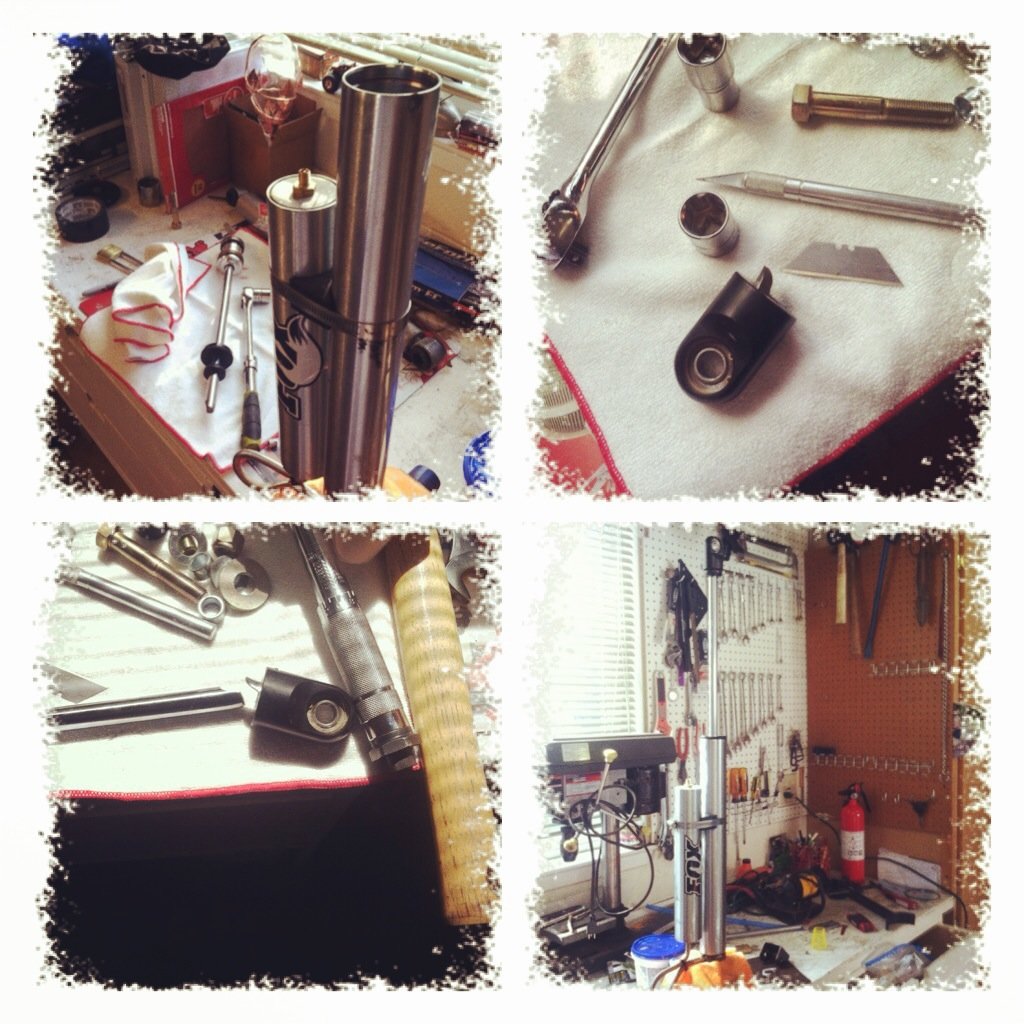

    Well I was planning on gusseting the mounts but I dident have time before my last pismo trip and well it broke right where we knew it was weak haha but I rebuilt it with much thicker steel (1/4 inch) and I gusseted it;) should be good now! I also snapped my shock shaft in half in the process so I ha to rebuild my whole lower end but luckily my boy Andy at poly performance hooked it up! Next day shipping and all parts under $60!
    My new shock tool and parts!

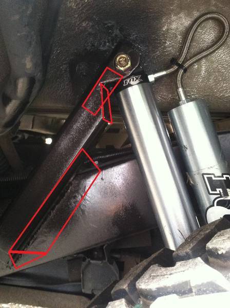

    Well rebuilt my DIY shock mounts, instead of 1/8 inch thick steel, I used 1/4 inch! And I did not wait to gusset it! Can't wait to take her out, I'm gunna cut my overload leafs as well to get a better ride quality what do you think?

    i would guesset it more man.
    this is how i would do it.
    add some 1/4 off the sides and gusset the cuts on the square tubing. will hold up a lot better. and will possibly save you 60 dollars in the future.
    oh and add another strip off the back the solid piece. expetially by the V in the tubing.
    this is just my 2 cents

    Thanks guys and damn man that's a great help Juan taco! I will do that, I'm gunna build my own half cage in the back not to long from now but ya I think I will def do that!! And thanks jsl! This is a total learn prerunner fab as I go kinda thing lol and it's SO fun

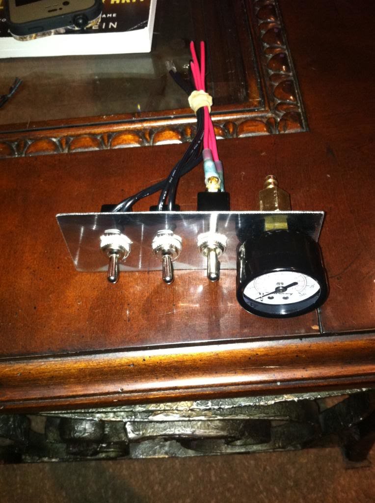

    Time to plumb some on board air!!!

    BE4E317D-CA00-4D59-AFC8-D17786B17A36_zps_2254e11fd02cfa1636cf1039f1037c159587b840.jpg
    Running my air line to a guage up front with aux switches for my led bar that's in the mail!!
