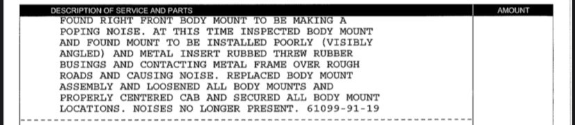

    Ultimate fix was loosening all body mounts and recentering the cab.

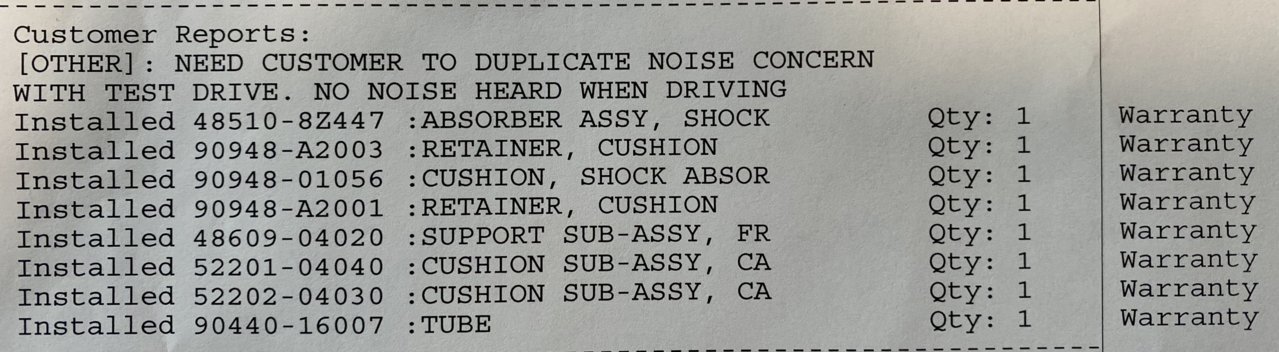

    I picked up my 2021 SR5 longbed on 9/11. On 9/13 I dropped it at my local dealer for “ loud clunking when turning left under 5 mph”. I thought no big deal something in the right front suspension just needs to be tightened up. 4 days later we still don’t know where it’s coming from.
    I have a seen a few other posts with similar symptoms but all seemed to aftermarket suspension.
    I’m just using this to document and maybe a resource if others have similar issue.
    Edit: 9/16 Dealer called saying they replaced
    right front UCA
    Strut assembly
    Sway bar endlink
    Fixed

    They have replaced the right front UCA, strut assembly and swaybar endlink. Noise is still there
    Exactly, I figure the clock a research would start all over again at another dealer. The dealer its currently at is the largest in a 50 mile radius so I assume they have qualified people.
    They have been actively working on it replacing parts
    If it was I dont recall hearing it. The noise is only there under 5mph turning left. After purchasing it I drove to my house 190 miles away
