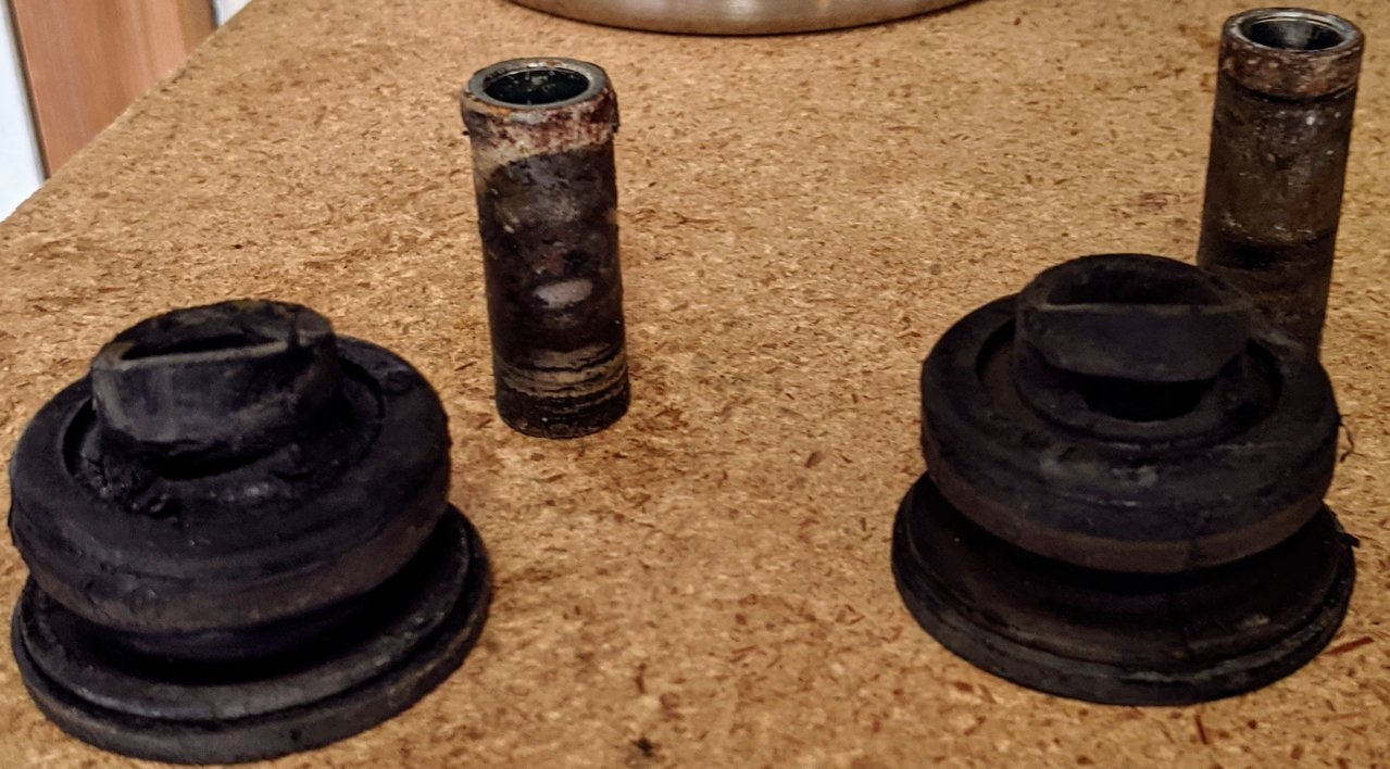

    The SB has been gone for 55k. Useless on the Sport or with any good suspension.
    That would be true for a blown out mount, but not a worn one(s).

    Many more than just us. If you search out the suspension clunk resolutions, you'll see a lot of fixes with the front mounts including a few vids of the issue.

    These have failed within the first couple thousand miles for some folks....and if all mounts aren't loosened and realigned it will happen again. I think I remember reading about one guy who had like maybe 10k on his truck and was already on his 3rd set of front bushings.

    I have seen posts of body mounts needing replaced quite early. With the number of misalignment posts (bumpers, beds, and cabs), a misalignment could tear up a body mount, esp those front two in short order.
    Mine definitely developed over time though and it was noticeable only when cornering hard. As it became worse, it was easier to make happen also.
    That is why I gave the long winded breakdown and my resolution as a suggested path forward. It is up to the OP and his dealer to do with the info as they wish.
    In the end, a clocked stock spring or SB contacting a spring would be pretty much in the dealer's face where body mounts have stumped a bunch of folks.

    I suppose if it were severely misaligned it could wear that quickly. I'm not saying that it is 100% the issue, I was just saying there a quite a few people with similar symptoms and the solution was replacing the front mounts and it will be a quick check for the dealership.

    Probs the body mount

    What is "SB" ?
    I will mention the front body mount to the dealer
