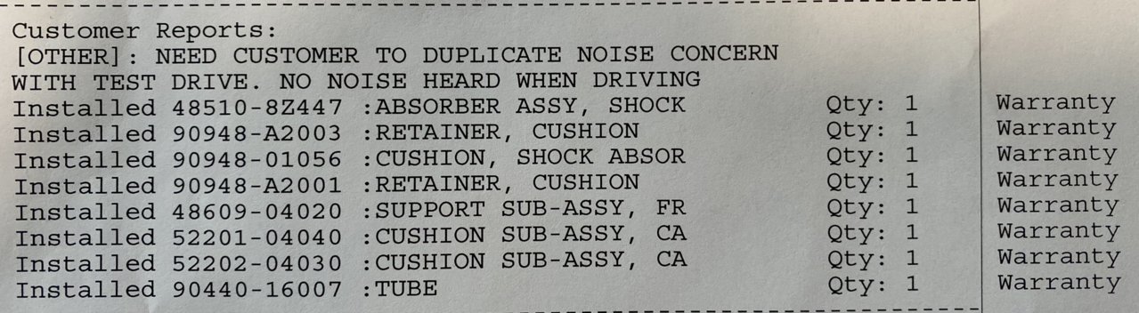

    I believe the cushions are the rubber bushings at the top and bottom mounting points for the shock. Maybe people are more comfortable paying too much for stealership prices when they don't know what they are paying for?

    Yes. But there are only two of those per side. There are three different cushions noted all at a single quantity along with two different cushion retainers that might be the washers.
    Maybe later my curiosity will catch up with me and I'll search them.

    So they did the shocks and top hats, and cab mounts. LMAO! They did both!
    Rebuilt the Coil over and replaced the cab mount.
    Interested in hearing what the Tech will say on Mon.

    Thanks for googling that for me. :cheers:
    Just one cab mount? If so, that's what happened with @WrecklessAbandon , among other fun things . . . :bananadead:

    You're right, it's been a while since I changed my fronts, but after looking, it appears there may be only one cushion at the top of the absorber, the other two cushions on the invoice have the suffix "CA" and would maybe be Control Arm Bushings? Them missing would explain a "clunk" when turning!
    Must have been a Monday build truck:drunk:

    Goodness. Given the prices that float around for the OEs, it would have been cheaper to swap the entire LCA than press bushings. A guy got a good looking aftermarket one for about $70?
    Hopefully, @danadavenport is set. I'm pretty confident he'll be good to go no matter what once the new suspension is in there.

    Yep, I have a set of 5100's ready to go in now they they have replaced them with new factory shocks .:bananadance: I will know and update here mon when the tech calls me. Sounds like the the shock and bushings were not the issue but rather the cab mount that everyone suggested.

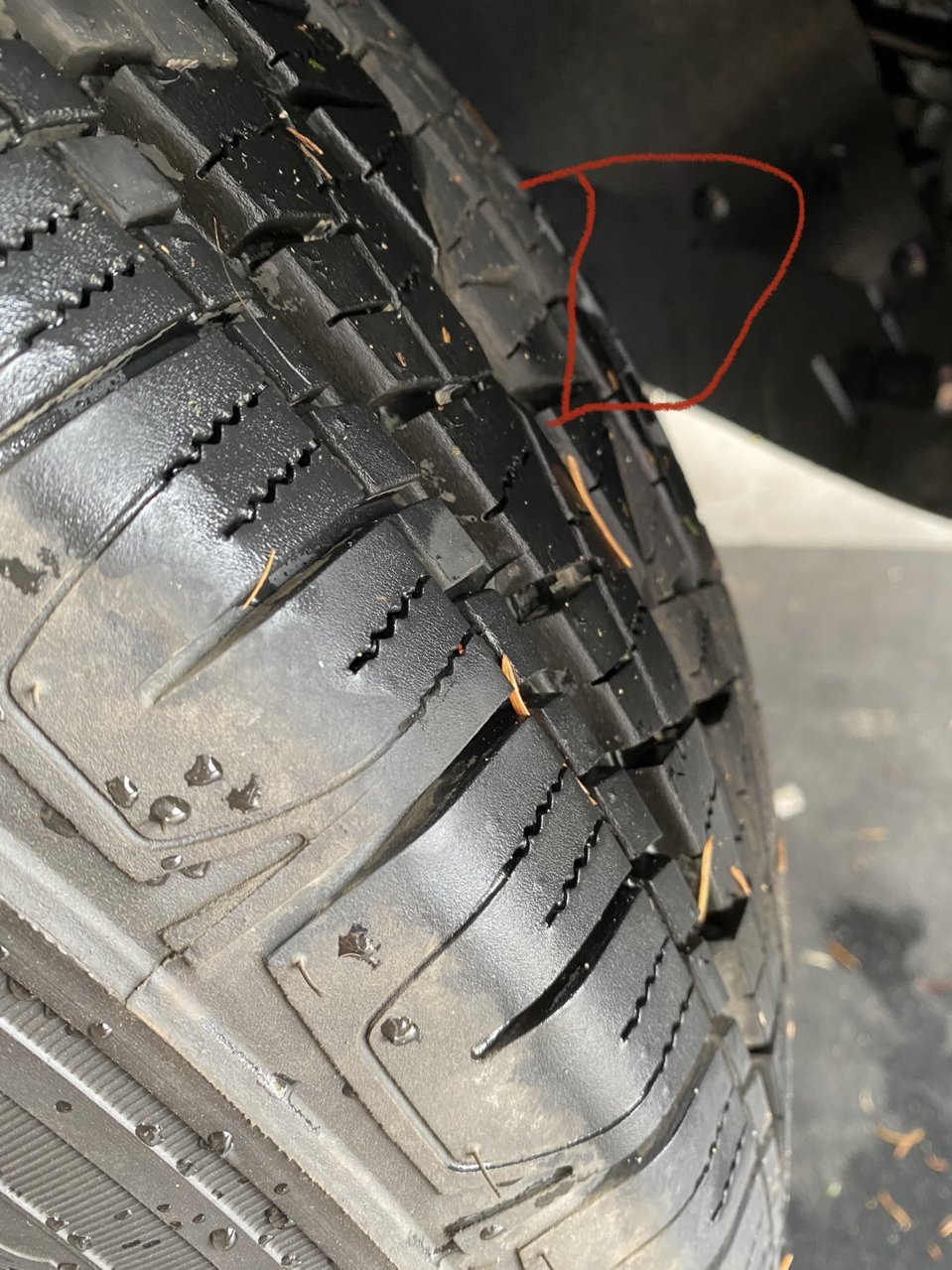

    So I have to ask if I’m being a little ridiculous. Remember my truck has 400 miles on it to date. First 200 we’re on the hwy coming from dealer.
    when I got home I was looking over the truck because it’s still new to me and I’m excited about it. I noticed the tire on the passenger side ( that they worked on) looks like its scrubbing and not running straight. As far as I can tell from the repair order they replaced the right shock and body mount. Should they have done an alignment after?

    They didn't change the suspension geometry so no need for alignment.

    I kind of though the same thing but they worked on the right front suspension and now all of a sudden that tire is getting eaten up. Just odd

    If the height of the truck didn't change and they didn't mess with the LCA cam tabs, then everything should be the same as before. If you're worried just take it in for an alignment.
    Edit - also it would be really hard to see uneven wear on a tire with such few miles

    They were most likely cornering it hard to check for the issue. Might even have been driving in circles to listen.
    You'll end up needing an alignment after you toss in the new parts anyway.

    trevnologies Well-Known Member
