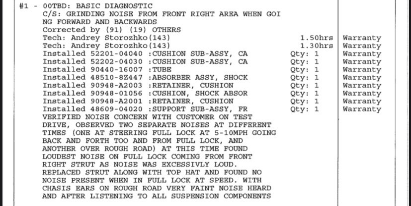

  16. Oct 8, 2021 at 7:50 AM
    #136
    tonered
    tonered bartheloni
    Sep 25, 2017
    #231055
    31,204
    tony
    Lynnwood, WA
    I just found this TechTip when looking for another TSB. Kind of interesting. It looks like Toyota was researching the issue, but still hasn't really fixed it on the line.
